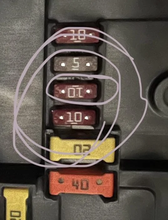

F48 on the drivers side is a 10 amp fuse
top to bottom - Mini 50, 49, 48, 47; Larger 46, 45
