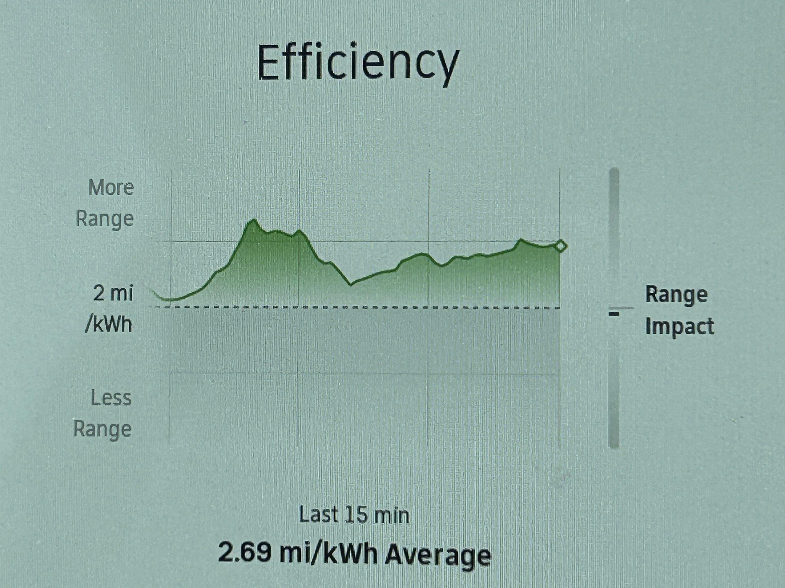

Okay, I have noticed a trend. When I drive right after a home charge session my truck is more efficient.
Now with seeing battery temps I realized that if you charge for a moderate amount of time then the battery is warmer from the charging. So even though I don’t have time-of-use rates from my electric company I realized I might want to start a charge schedule to charge the truck in the early morning to end about when I leave in the morning instead of charging at night.
This is only a hypothesis and maybe it has been covered before but I would love others to confirm.
Rivian R1T R1S Hypothesis: Charging schedule makes more efficient driving IMG_1712

Yup. Do this in the winter to help with efficiency.

I time my charges in the winter. I know my evse does ~6% per hour. I schedule the charge so I get to my desired percent for my drive.
I believe tesla has this feature built in so you just out your scheduled departure and the car does the math for you

Yes conditioning while it's charging. I still charge whenever I have the opportunity though. I may change that if my utility adds support for Rivian and I can get a $0.02 per kwh discount for night charging.

Yes, it's more efficient as the battery will be warmer if you can time charging when you leave. I do believe battery pre-conditioning will be coming in the next few updates now that the weather is getting colder. I've decided for the minimal cost savings it doesn't make much sense to go through the headache of trying to charge at exactly the right time - I just set it and forget it, waiting for preconditioning to come on a future update.
