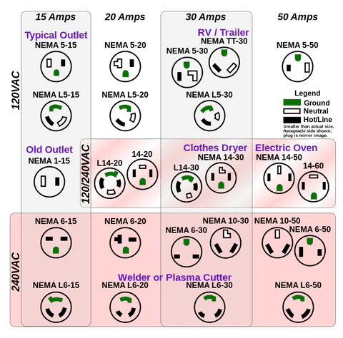

Another consideration is that a 3 prong outlet means there may be no ground, and there have been reports of failure to charge (especially from the Rivian EVSE) when there isn't a stable ground potential.
For that matter a 4 prong may also not have a ground. In both cases the outlet would be defective.
No, older outlets like 10-30 had no ground by design. They were intended for appliances like dryers that were never unplugged and never moved and were grounded (sometimes) by a wire screwed to the outlet box. These outlets have two hot 120v legs and a neutral leg but no ground. This can be a problem for some EVSEs like the Rivian one if the neutral potential fluctuates relative to ground.

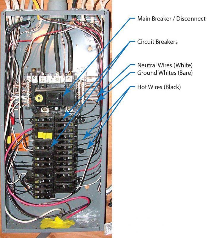

Neutral wires return to the same bar in a main panel as ground wires. The only difference being that this lead will never be bonded to the outlet box or conduit. Assuming no other code violations exist in the wiring of the outlet such as shared breakers or shared neutrals, the pin effectively is a ground for the purposes of an EV. An appliance, however cannot utilize it as a chassis ground because it is likely also using it as a 120V neutral to operate accessories like a clock. Such use could energize the chassis. An EV does not use a neutral when two hots are present.

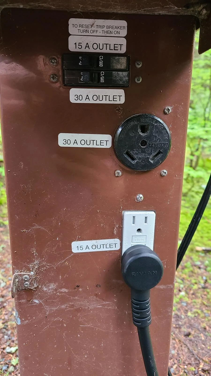

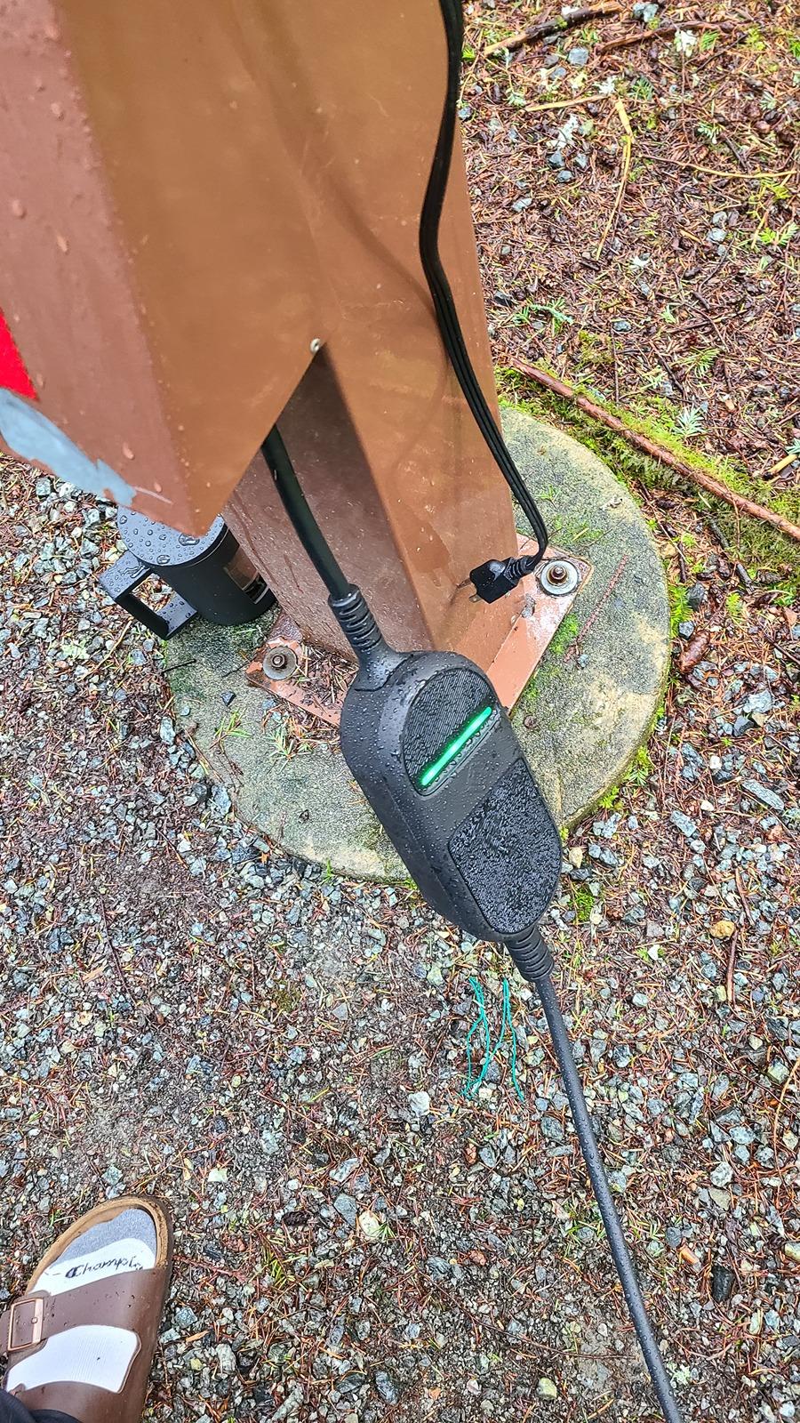

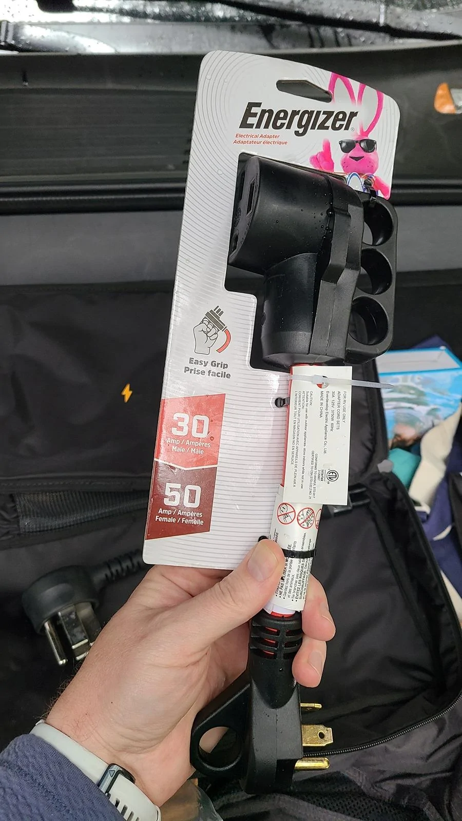

Currently at a Campground, bought a TT-30(RV Plug/Nema 14-50 and the mobile charger won't power up. I've used the 14-50 plug that comes with the mobile charger with no issue at home, I've also used the 120v regular household plug on the Campground power outlet with no issue.
Either every 30amp outlet is not working on these sites (tried a few) or the adapter is bunk... Or the mobile charger is having issue with the 3-4 prong connection?
Anyone have any thoughts?
Also, I'm obviously going to lower the draw in the vehicle to closer to 20amps once this does work.
might it be they aren't grounded?
Could well be the case, but I have no means to test. The household 15amp outlets have a gfci so I'd assume both are grounded?
Edit added a photo of the outlets
You bought the wrong adapter. The one you bought is only for RVs. Adapters made for RVs won't work with an EV - you need to buy an EV-specific TT-30 to NEMA 14-50 adapter. I use this one, and it works: https://www.amazon.com/Parkworld-885378-Adapter-TT-30P-14-50R/dp/B07G2MT4T6

^ What he said. Don't use an RV adapter with an EV and don't use and EV adapter with an RV. They look the same from the outside but are wired different.
These adapters aren't really UL certified. Generally no UL certified device will come with a plug that can over load a circuit. An adapter allows you to attach a higher draw to a lower outlet necessitating adjusting the vehicle appropriately before plugging in each time.
This is why many people recommend the Tesla mobile charger and adapter suite as they adjust appropriately to the plug. No extra thought is needed. Rivian only supplies two that perform this function.
Cheers!
I'm returning the adapter I just bought for one EV specific. Thanks those that responded so promptly btw. Forums for the win ??
PS as I'm in Canada, this is what I went with. Another R1T owner commented he was able to pull 4kW no issues.
