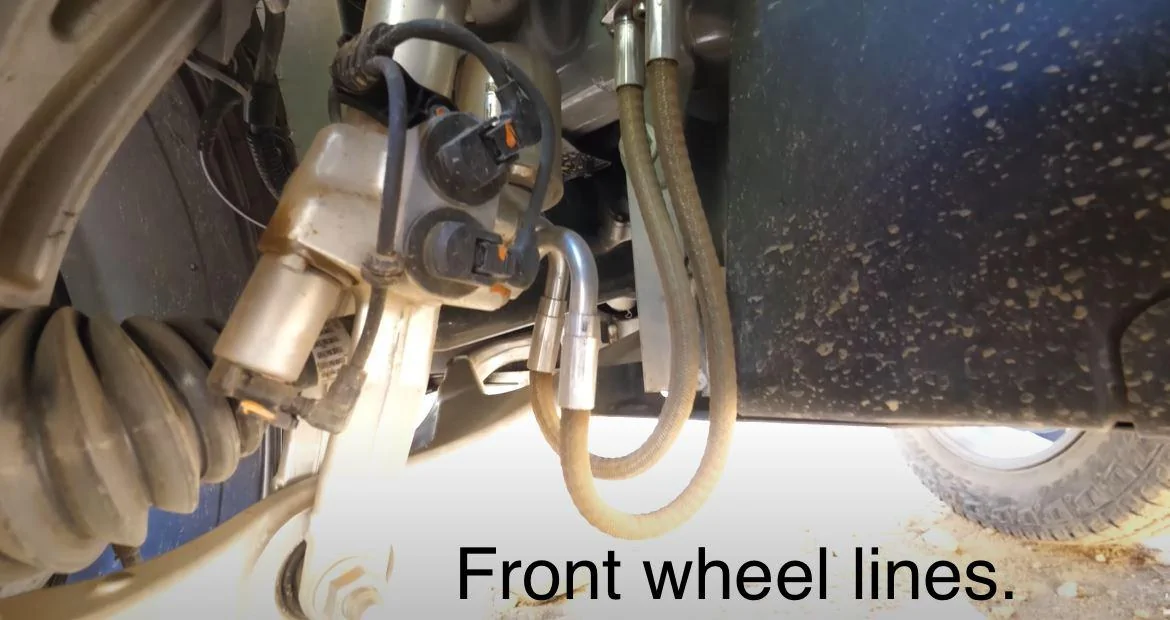

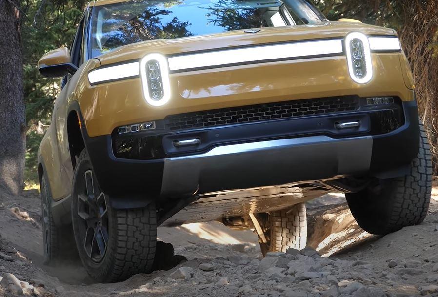

After watching several of the Press dive reviews off-road, I can't find one angle where those rear lines are hanging down as much as those were in your hub photo. They are visible for sure, but all angles seem to show them "tucked up" a bit more flush. I wonder if they become more taut in the off-road height and more slack when in kneel.
Vehicle is parked in this second photo. Unknown suspension height. My guess is play factor for different suspension heights.

Yeah, I think they've had some pre-pro trucks demoing with the newer ones so they can show all the colors. I did not see these lines hanging at the First Mile event under the more recently built truck that I checked.

They are not flexible. They have a metal housing angled towards the front. Very crushable.
I’m not worried about aesthetics on the plate, more about durability. Metal dents, carbon fiber cracks. It just seemed a lot thinner than I expected. Like, it moved when I pushed on it with my hand.
Carbón fiber stops bullets, I’m not worried about the plates. The lines were preproduction and it was stated in the interview at the rally that the lines were fixed with production parts, now what that looks like remains to be seen I guess. I have confidence if they lasted through the Trans America Trail, probably not something common to damage or they might have seen it there. Fingers crossed… ;) it’s better than CT’s ball bearing stopping windows…
