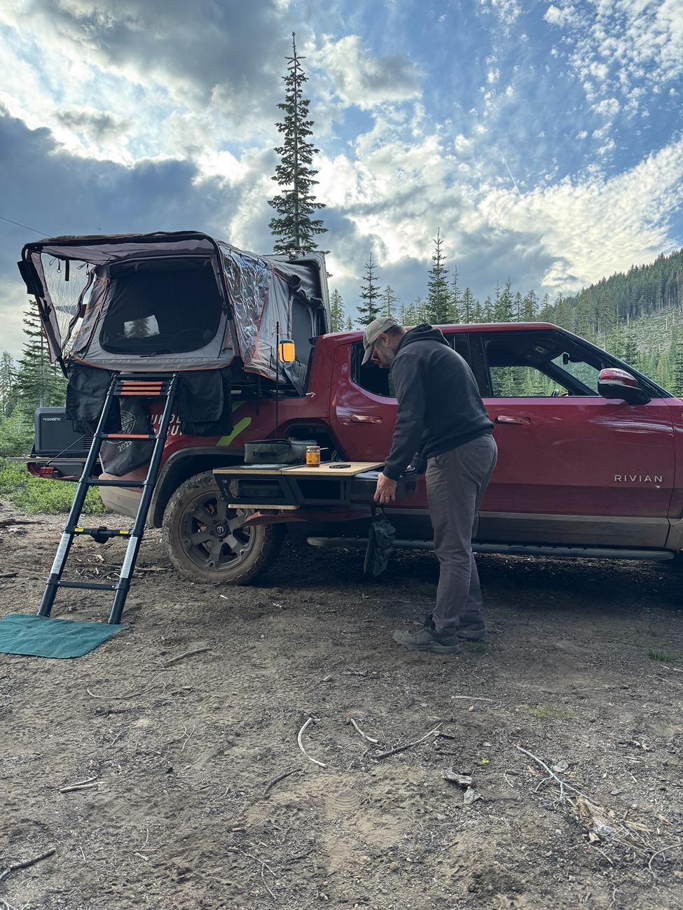

I humbly recommend the Thunderbolt Adventure Supply Overland Kitchen with Gear Sled for a premium cooking experience. Super quick set up and clean up. In addition, it's much easier to access all of that gear you're planning to put in the bed with our Bed Glider - especially with the Rooftop Tent mounted over the bed.
Here's our truck with the tent open, Kitchen out and the Bed Glider pulled out to access our fridge (Dometic CSX35) which also fits under the tonneau.
Definitely the cleanest solve, and top notch gear. Unfortunately $3800 is about 4x more than I'm willing to spend on a setup like this. Maybe if I ever get around to it I'll try my own DIY solution... wish I could afford this one though, such a perfect combination!

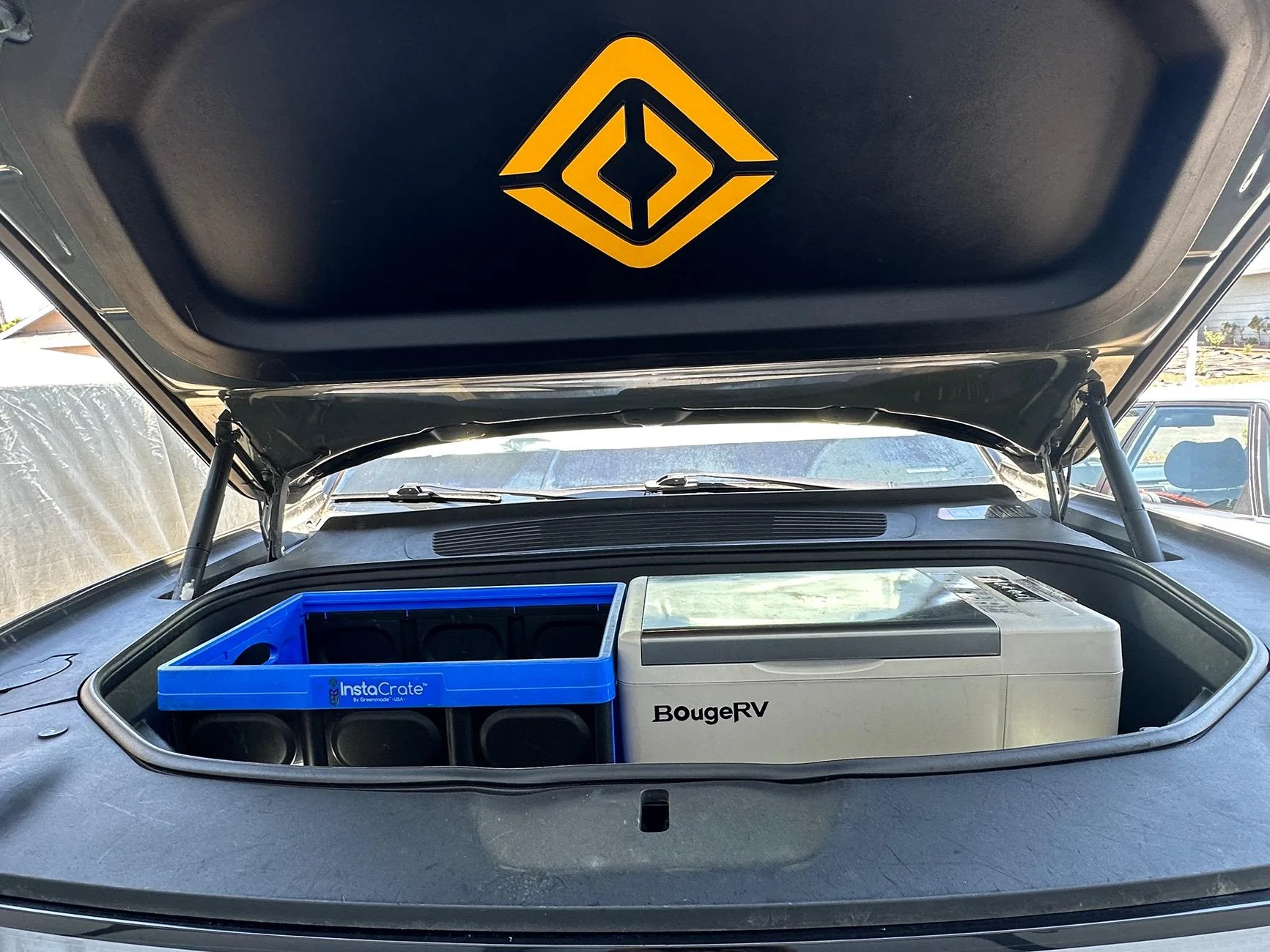

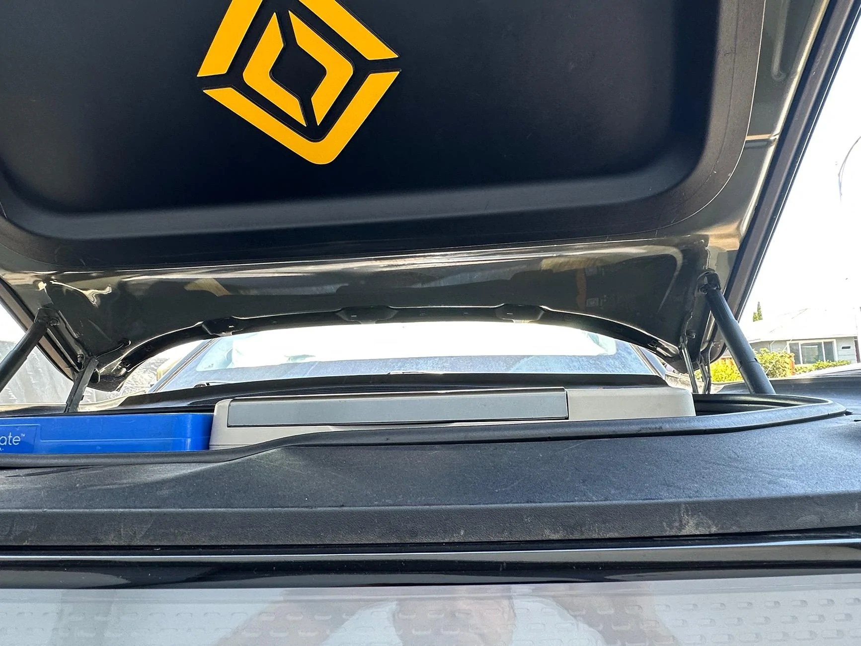

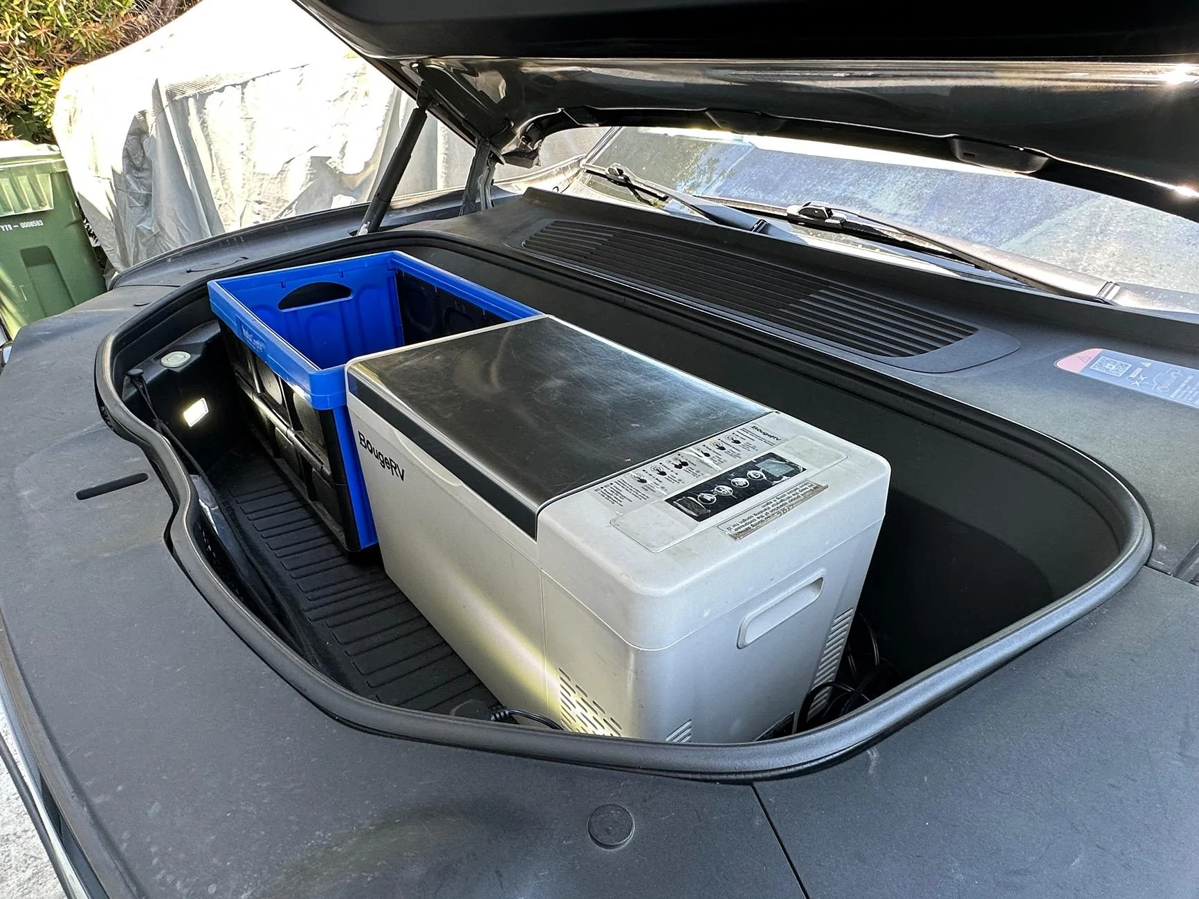

Looks like the Bouge 23 quart is 12.97 inches high. Any idea what the max height for fitting in the frunk would be, or in the upper part of it?
Looks like there was another similar thread, but nothing conclusive: https://www.rivianforums.com/forum/threads/frunk-dimensions-for-mobile-fridge.4958/
Here’s a few pics of the BougeRV in the frunk. I use it all the time when we go grocery shopping. Don’t recommend it staying in the frunk for long periods of time during the summer months because it gets hot in there and makes the compressor work harder to keep the fridge cool. During long road trips starting late Spring through early Fall, I stick it in the cab behind the passenger seat or in the bed of the truck. FYI…I have the 12V in the frunk.

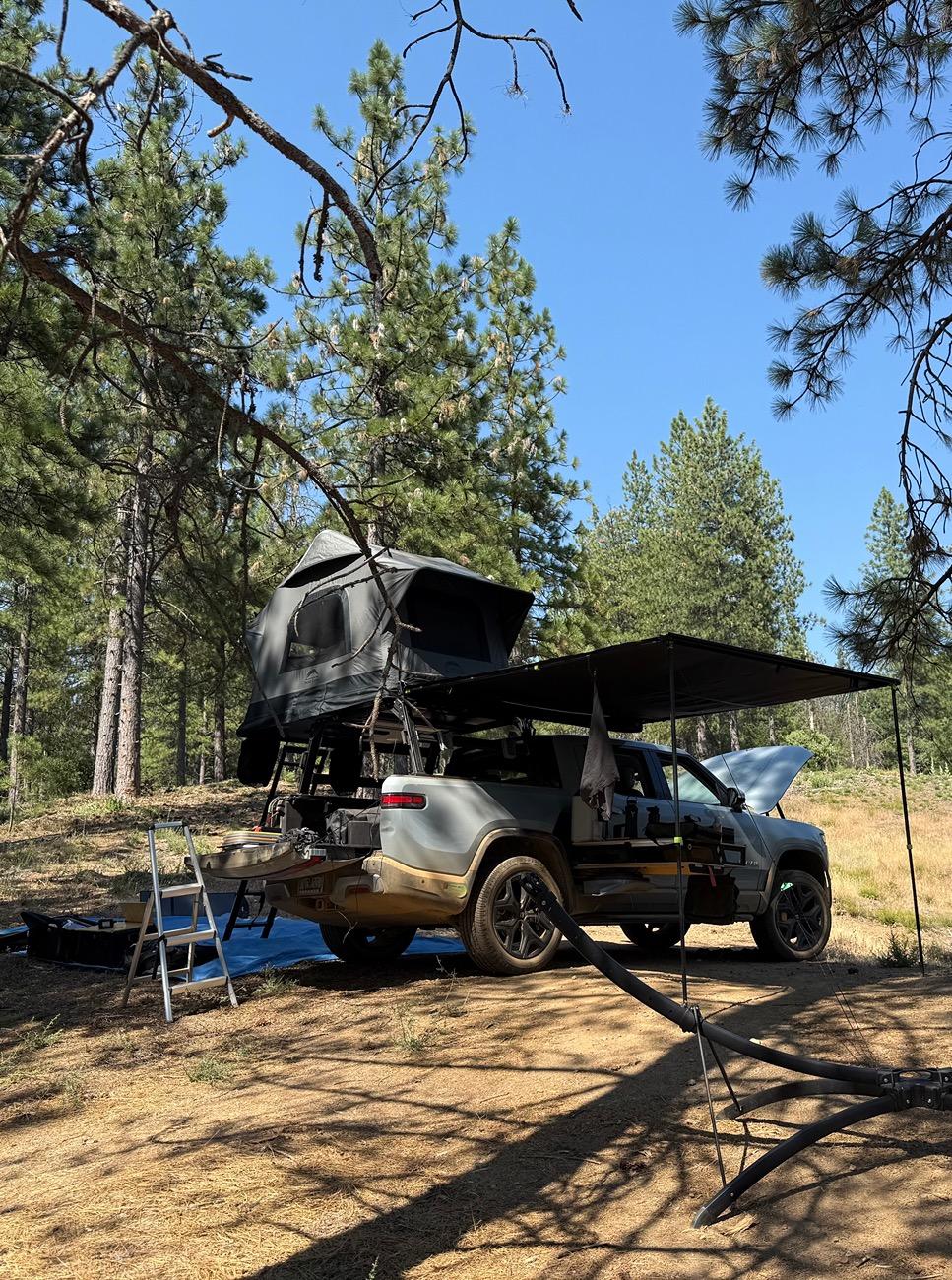

FWIW I had the same "tent over the bed sometimes and the cab other times" dream and I think it would be a hassle in practice. I install my tent with a hoist and leaving the crossbars mounted to the tent makes it super easy. But the roof mounting brackets are narrower than the bed points (and I think differently spaced) - you'd have to redo the tent fixing to the crossbars every time you switch, which seems like a huge hassle.
I just got a hitch rack with a swingout for the bikes when I have the tent mounted. If you get the 1UP rack you can add/remove trays as needed so you don't have a bunch of wasted space - I bought the bed racks and then a hitch adapter so I can choose between over-bed, over-roof, or hitch-mounted.
Mileage may vary, but I see a lot of awnings on rigs and almost never see them deployed... maybe because I'm in the northwest. I almost bought one several times but this is one where I'd give it a go without it for a while and see if you really miss it. It's a lot of drag and weight and cost to carry around. (I suspect most people would prefer a freestanding canopy if you really want a rain/sun cover).

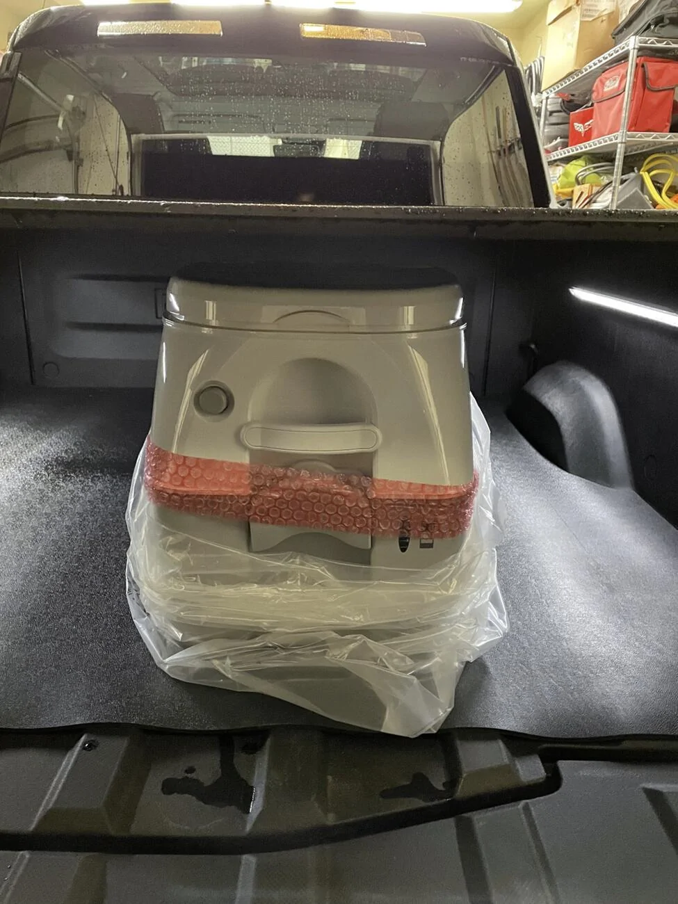

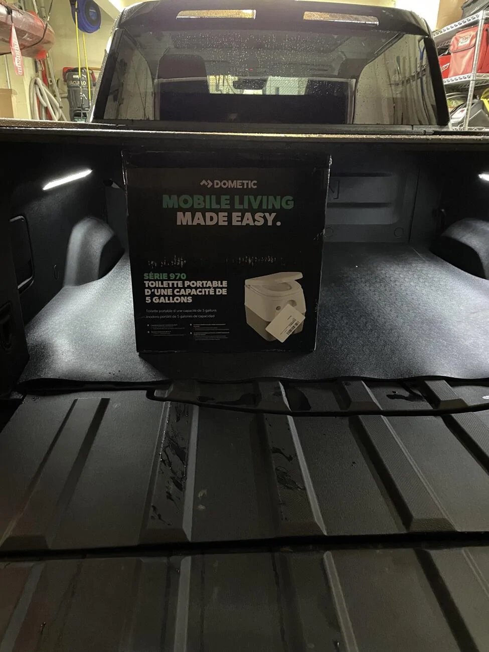

I’ve got a great toilet, privacy tent for toilet, some WAG bags and an adjustable height fold up table coming. Going to get some bins tomorrow. I’ve got a big jug for water, plenty of coolers and while I don’t have proper stuff to cook yet, I’ve got plans for food I can bring and eat without heating or anything. I’m thinking Saturday or Sunday night I may take a maiden voyage in the mountains near my house (I’m 10 minutes from a National Forest) as a trial run.

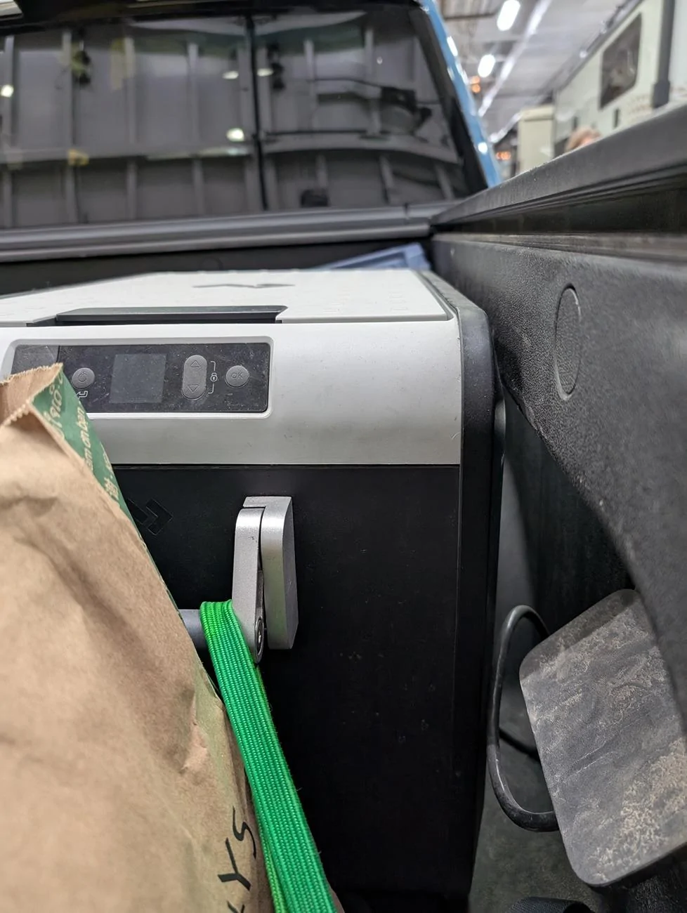

As for the fridge, they are a game changer versus an ice chest. I have a Dometic and love it, but it is barely too tall to fit under a tonneau. The Iceco may be the ticket.
We have the dometic CFX3. It fits fine under the tonneau . We have a gen 1 T if it makes a difference. We've had it a couple of years and have been happy with it. I haven't price shopped against other options. Spendy ..I'm sure we used rewards points at REI.
