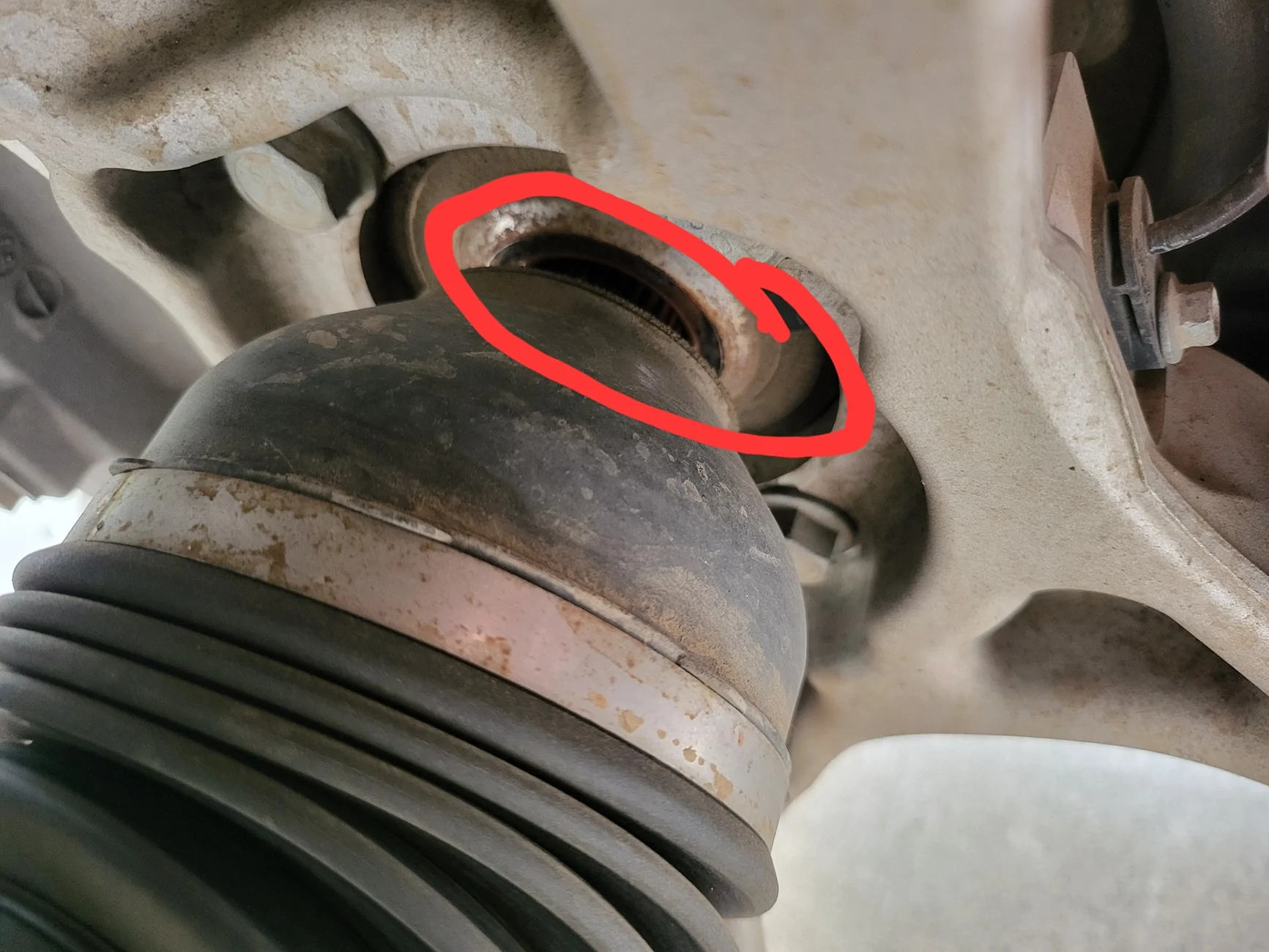

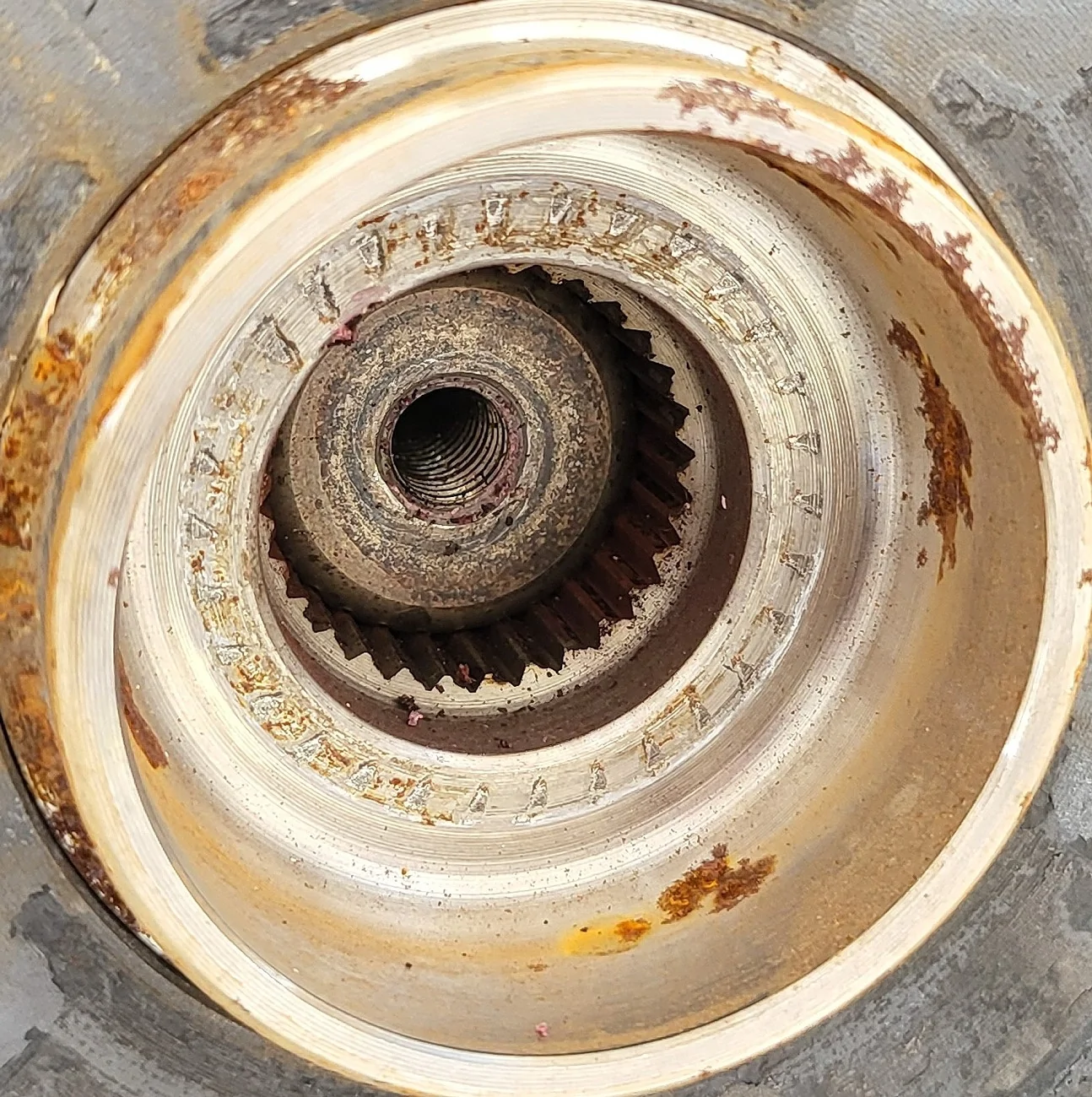

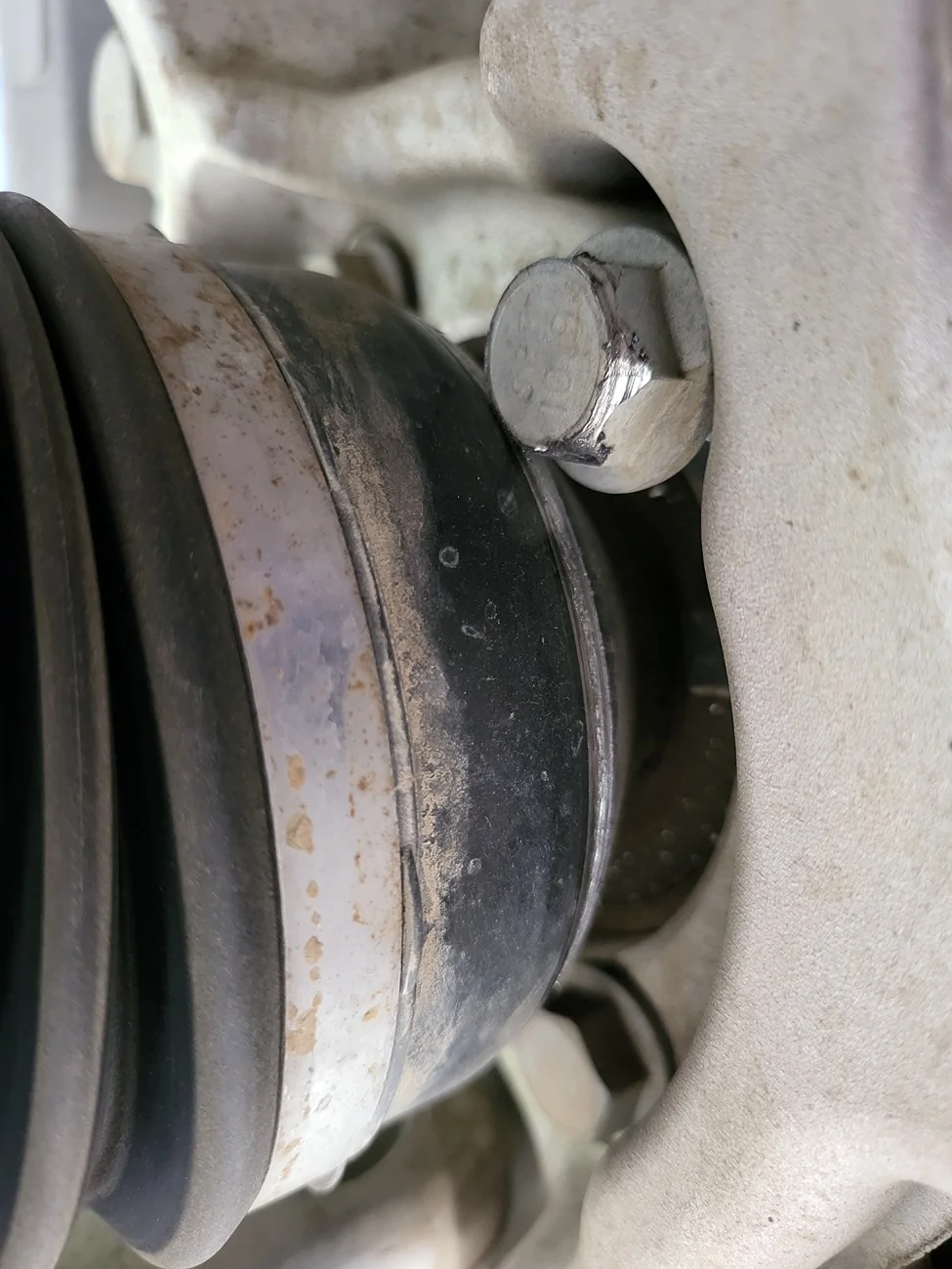

Low ride height is least stressful. Launches are hard on them particularly if the steering isn't straight when you do it. The splines get a little knurled allowing movement which causes the back of the CV to squeak or tock against the hub.
A complete failure is unlikely unless you are abusing it off road. The hub bolts can also loose which is not good.
Rivian R1T R1S Half-Shaft issue thread a2025-09-21 14.13.46
Rivian R1T R1S Half-Shaft issue thread Grease area 2025-09-21 14.13.18-1
Rivian R1T R1S Half-Shaft issue thread 2025-12-22 12.24.05
