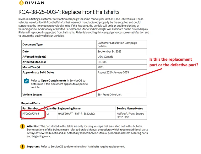

Han anyone been able to figure this out? Thinking about sending a message to the Rivian support about this. Had the -F revision shafts installed and now my front end is quite clunky compared to what I had previously. Installed around Sept 15th. 9 days later this comes out.

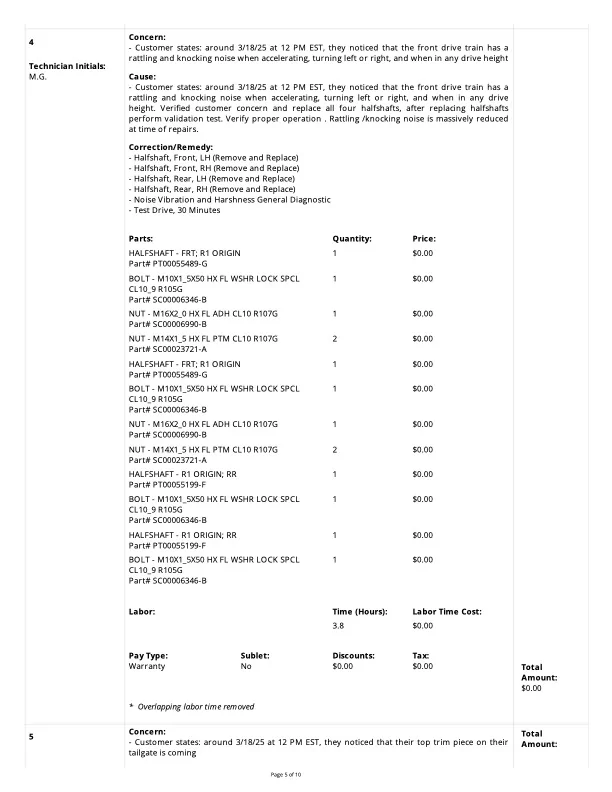

Just had my '23 R1T Quad in for service last week for drivetrain noise and to have the V2 tonneau installed. Ended up with 4 new half shafts. Here's the work order:

How long did this service take? Asking for a friend...
I had it in for a V2 Tonneau install and to fix a couple of other minor issues, as well as the half shaft issue, and it only took maybe 2 days. Replacing all the half shafts is a pretty quick job once they have the parts. Work order shows 3.8 billable hours for replacing the half-shafts, but I imagine it only takes ~2 hours. I'm guessing if that is all they are doing they should only need it a day, but it depends on how busy your service center is.
