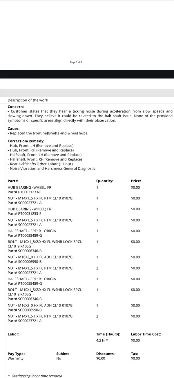

Here are the parts they used for my repair. Let's hope it's the latest revision

My half-shafts were replaced with the G variant as seen on my receipt. Everything feels nice and tight after having hubs, half-shafts, jounce lines and dampeners replaced.

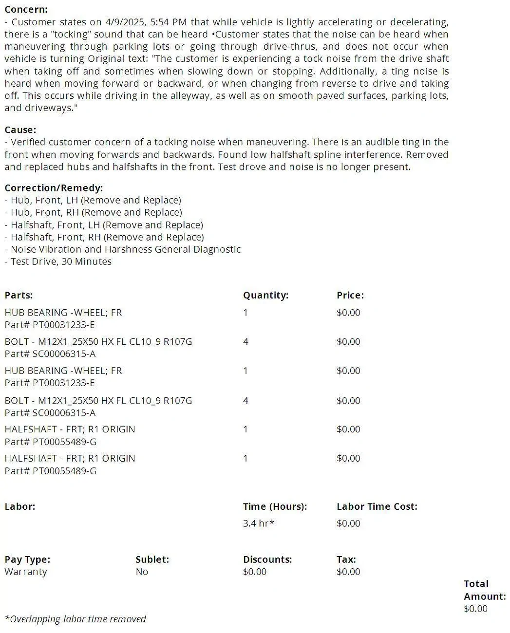

Has anyone had a F or G revision half-shaft fail yet?
No failure thus far. I have a G version that was installed on my Front Right. Quickly browsing my service records, it's the first and only one that's been replaced. This was January 6th 2025 on my January '23 Quad, at the time around 50,000kms.
They noted heavy corrosion on the hub assembly as well which was also changed. I'm left to assume that the very minor slop i'm currently starting to experience between stop and start or regen/accel is likely the Front Left original half shaft/hub assembly starting to wear out as well.

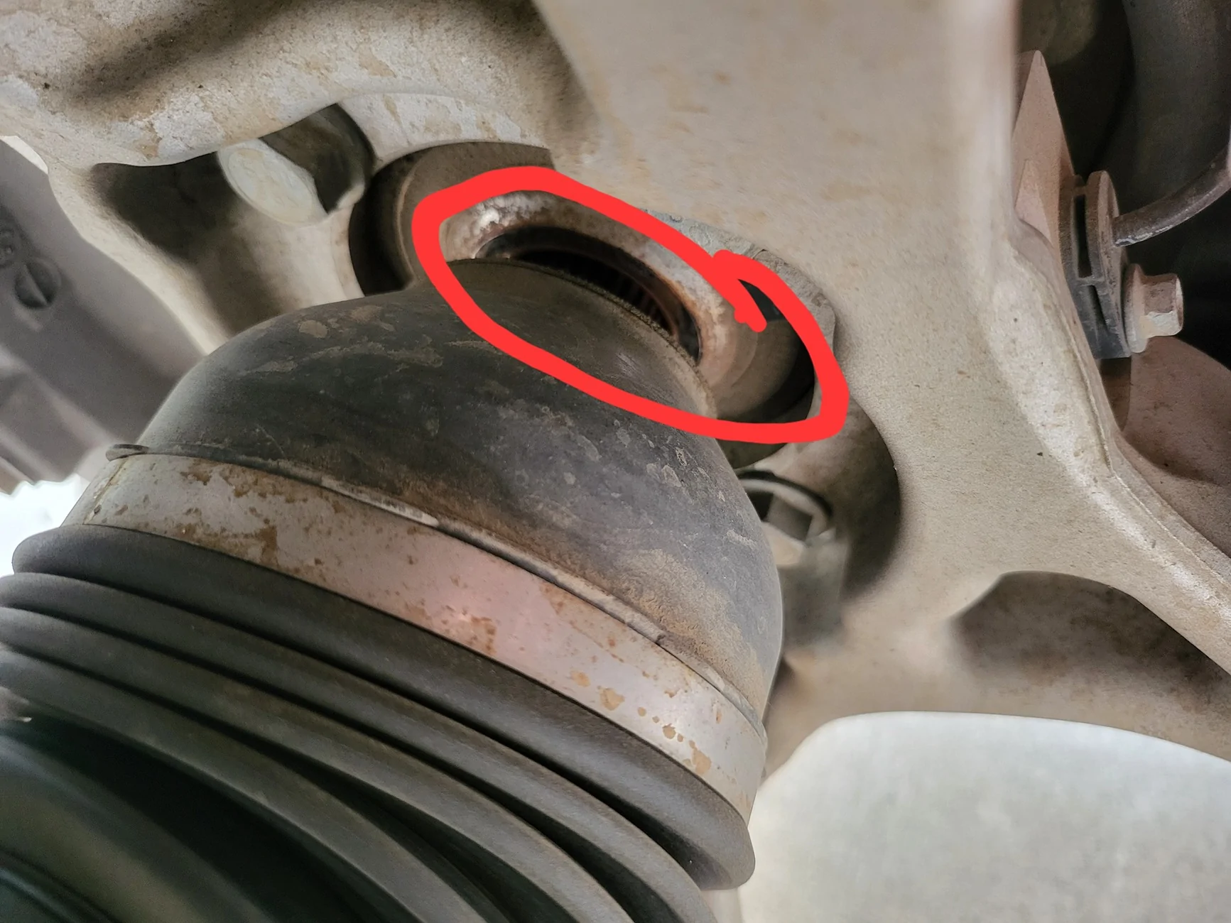

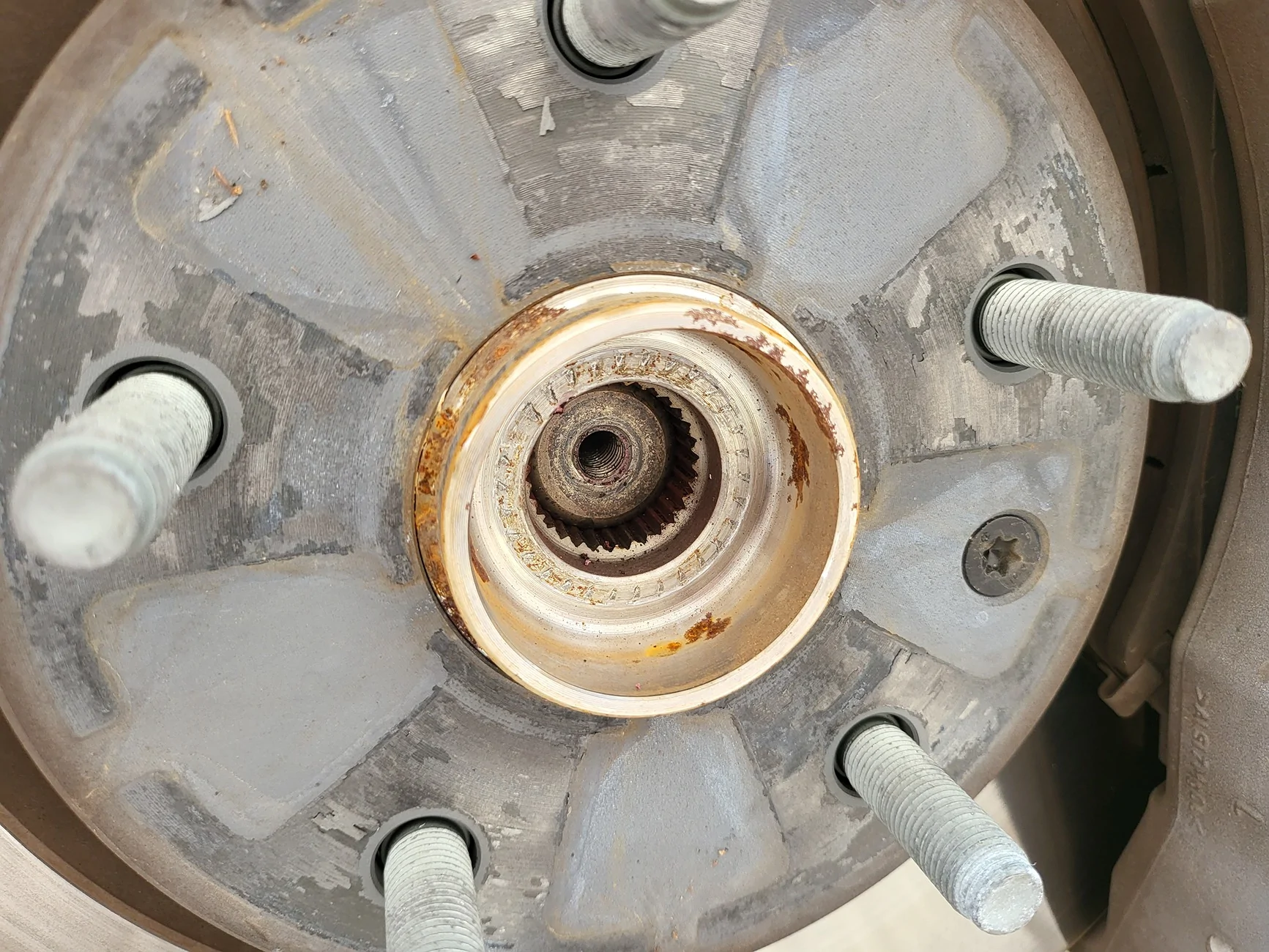

I'm curious to know what exactly is being changed on these halfshafts with each revision and is the halfshaft end spinning in the hub interface or at the extending ball bearing spline to cause the rumble strip noise at full send. From some of the responses here sounds like the halfshaft may be spinning in the hub under full power.
The halfshaft is splined on both ends and, of course, spins in the hub in order to propel the vehicle down the road.
Rivian R1T R1S Half-Shaft issue thread 2025-09-21 14.13.46
On mine, the creaking sound was created where the axle enters the hub on the backside. grease fixed it for me.
