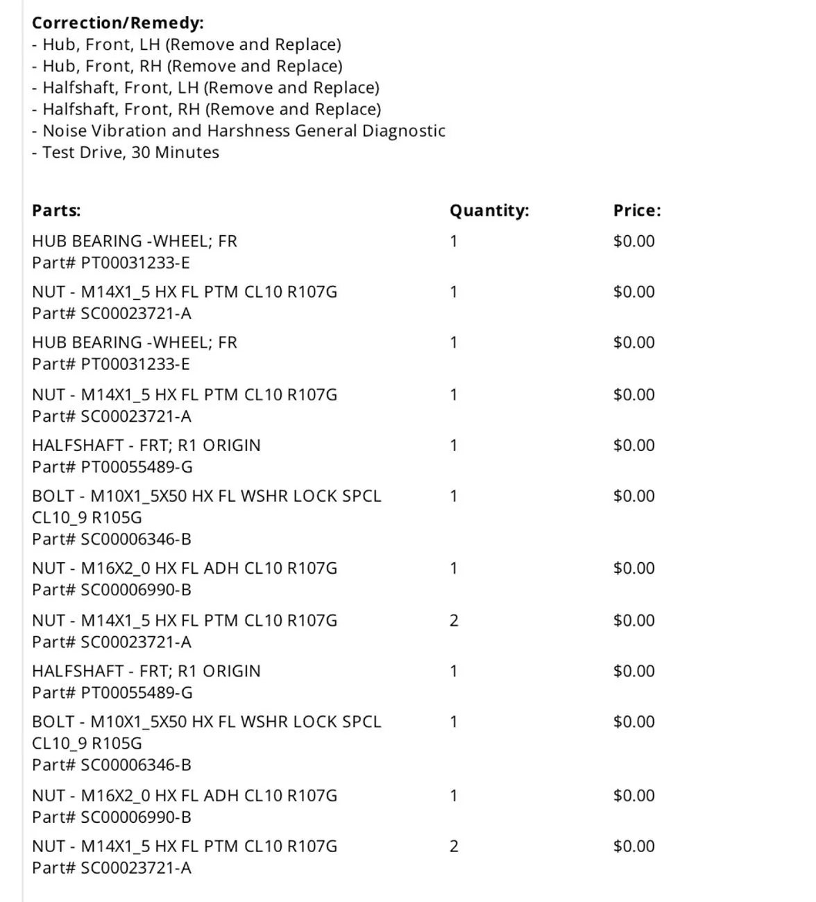

Looks like I’m joining the “half shafts + hubs replacement” gang.
Here are the part numbers in case anyone’s interested
Sorry if you've already mentioned, but what is your vehicle spec this service was for? R1S/T? Gen1/2? Dual motor, quad?
