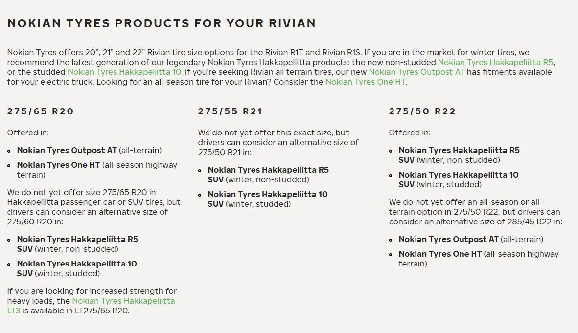

Wow, those tires are allegedly:
  • 3-Peak Mountain Snowflake certified
https://www.tirerack.com/tires/tiretech/techpage.jsp?techid=125
Very sorry to hear about your experience and damage. Yikes.
Keep in mind that not all 3-peak snowflake tires perform equally. I think it was Tire Rack that had a test video where one or two of their 3-peak tires actually outperformed some dedicated snow tires. They also had a video where an all-terrain tire that wasn't 3-peak rated actually outperformed some of the all-terrain tires that were 3-peak rated.
I'm not saying the rating is worthless because I don't believe that at all, but I am saying that 3-peak certification isn't going to guarantee that a tire is great in the snow.
