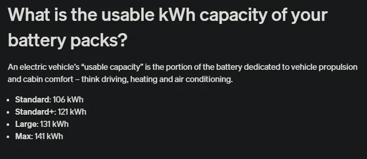

Hmm, the only other place I'd say to check the capacity is via a service that uses the API. ElectraFi is the only one I'm aware of. Mine will fluctuate between 142-142.9 kwh, though I have a G1. I wonder if your experience is unique, or if anyone else has confirmed the capacity of their battery via the API. Seems like the new max is the old large, just like the new large is old standard. This page has not been updated for the G2 vehicles:
If you click on your user name in the top banner, it will take you to the page where you can edit your profile. Down the page a ways you'll see Vehicles:
You can sign up for Live data in the ABRP app and it will show useable capacity. Mine says 130.8 kWh for my Gen 1 Large R1T.

That's a good tip. I use ABRP and link it but never went that far into what it gathers other than average consumption.
I also noticed that ABRP hasn't sync'd in over a month so I guess that's a problem as well.
