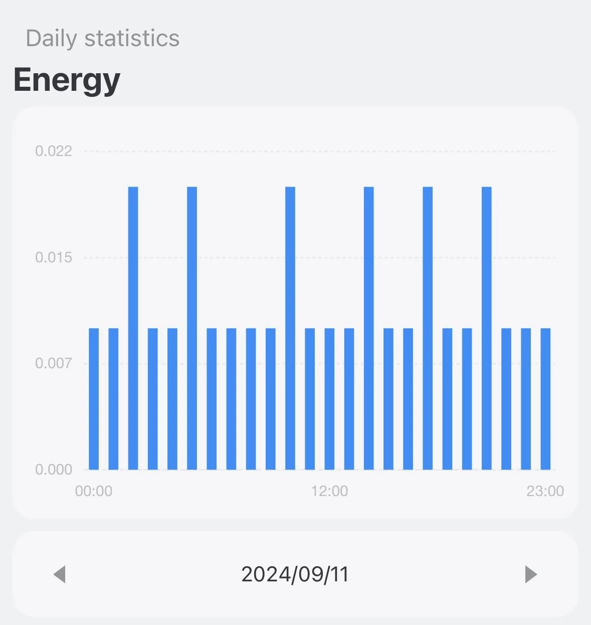

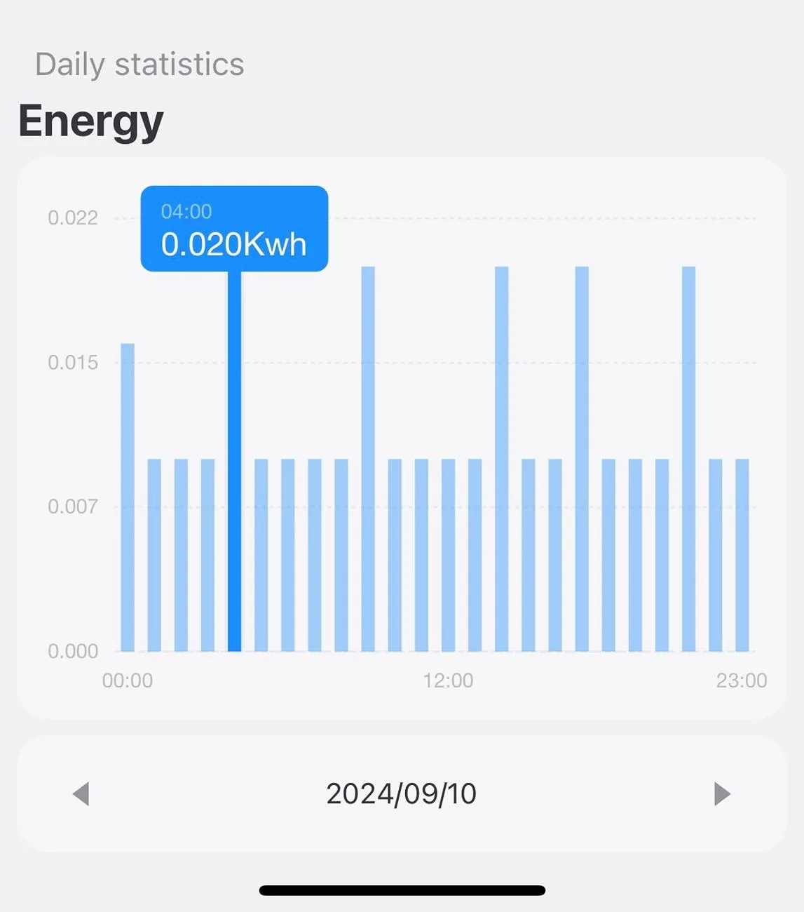

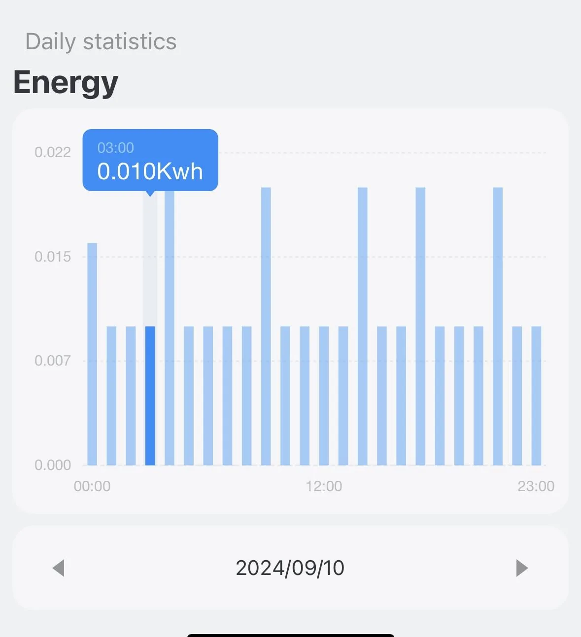

My R1S in Hawaii (which was sadly in a minor accident and sitting in my garage and awaiting repair - more on that in a separate thread) is back in my garage and hooked up to a 12V battery charger.
- Again no loss from the HV battery in 6 days and counting
- Draw from the battery charger is about 0.3 kWh/day (I'm using this really hand Wi-Fi enabled monitor: https://www.amazon.com/dp/B0C619YRRM?ref=ppx_yo2ov_dt_b_fed_asin_title)
By contrast, my R1T, which sat plugged for 8 days in Phoenix while I was in Hawaii somehow added 32.6 kWh to maintain its SOC. Granted it's been stupid hot in Phoenix so I'm hoping there was some battery cooling/maintenance, but 4 kWh per day is a little ridiculous. I don't know why, but power draw on a plugged in Rivian is greater than an unplugged one.
Anyway, I'm glad others have found this solution effective. It's stupid we have to do it, but it works.
