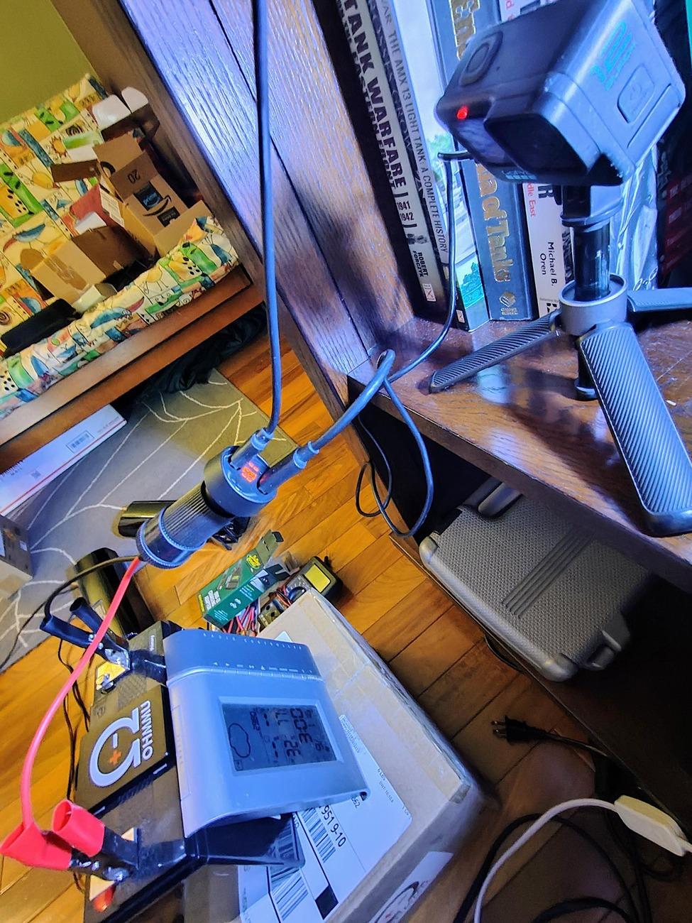

Got a couple experiments running today...gotta love a good 3 day weekend! :p
2A load on a fully charged Ohmmu, with GoPro watching the voltage and time. Will be comparing this with the Rivian's AGM battery after swapping to get a feel of the actual capacity difference between the two. The Ohmmu folks are a bit cagy about 'capacity' and prefer to speak "Reserve Capacity", which does make some sense but makes it hard to compare. All we care about is can we delay voltage dropping to the point that the HV>12v recharger kicks on.

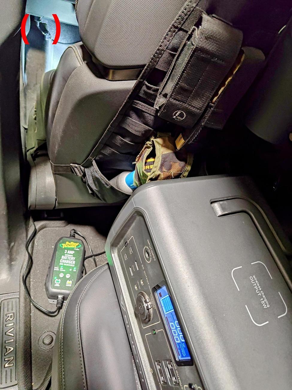

Also! Camp battery running through battery tender plugged into the OBD port. This is quite possibly an awesome solution if all works as expected...I can feed the camp battery from the Rivian when it's outlets are on or via solar if we are camping in one spot for a while, and it can keep the 12v battery tended without the HV>12v recharger ever lifting a finger. Unless of course I need to steal the camp battery from it's usual buckled-into-the-back-seat home to power our tent heater and/or electric fridge (in the truck bed), at which point it would be lovely if the Ohmmu has the reserve capacity to keep the computers off for at least overnight.
