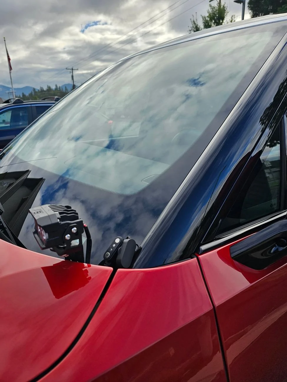

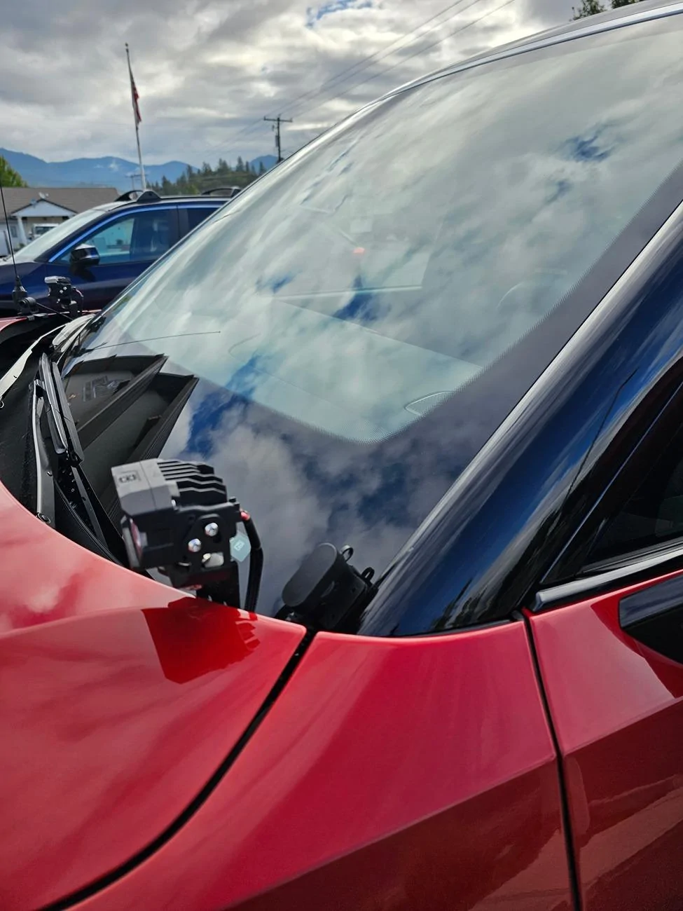

I'm a few days into keeping the 12V battery topped off with a trickle charger. I'm tracking the consumption from the trickle charger as well as normal loss reordered on the Rivian. After 3 days the Rivian finally showed 1 kwh loss. Adding in the consumption of the 12v charger I averaged 0.7 kwh per day. I'm going to continue to monitor and suspect it's actually a bit lower over a longer average, but that's already much better than the 2.33 kwh/day I was consistently losing prior. I sleep better at night knowing the waste had been dramatically reduced.
I'm using a 4A charger connected via a magnetic quick connect attached with double sided tape at the bottom left of the front windshield.
https://www.amazon.com/gp/product/B0C9MGVBL6/ref=ppx_yo_dt_b_search_asin_title?ie=UTF8&psc=1
https://www.amazon.com/dp/B0CV3DLFRX?ref=ppx_yo2ov_dt_b_fed_asin_title
Would appreciate some pictures showing where you let the connector rest by the windshield. Can you reach it without opening the frunk?
Also, do you have a dual battery configuration and used two separate connectors?

Rivian R1T R1S Gen 1 Vampire Drain (Possibly) Solved (or Hacked) 1000012355
Rivian R1T R1S Gen 1 Vampire Drain (Possibly) Solved (or Hacked) 1000012356
Mine is a single battery, so just connected to one. No need to open the frunk. The cable hangs from my garage ceiling a few feet off the ground (as does the primary charging cable), so connecting and disconnecting is quick.

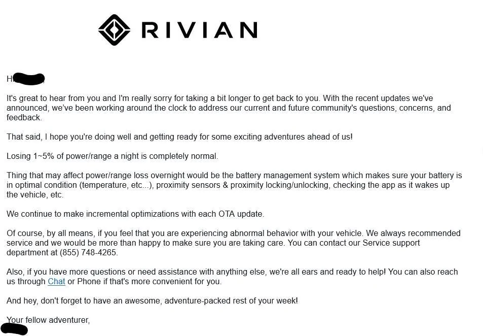

Here's an official response from Rivian Service regarding parasitic drain. My question asked simply what the normal level of parasitic drain for a 2024 R1T was. I have not responded to the Service reply, but intend to push back on 5% being normal absent special circumstances. I suppose I should be happy that the official reply does not echo the "up to 12% is normal" statement another tech made.

Here's an official response from Rivian Service regarding parasitic drain. My question asked simply what the normal level of parasitic drain for a 2024 R1T was. I have not responded to the Service reply reply but intend to push back on 5% being normal absent special circumstances. I suppose I should be happy that the official reply does not echo the "up to 12% is normal" statement another tech made.
:(. up to 7kw per night loss is normal. Amazing.... I should repost this on Twitter and Facebook - shaming sometimes works :)
100k vehicles, let's say 2 kwh per night per car average loss, 73 Mega Watt parasitic loss every year for the fleet! But we are saving the climate, right?
NY_Rob
Feb 9, 2022
5,479
8,113
long island
:(. up to 7kw per night loss is normal. Amazing.... I should repost this on Twitter and Facebook - publish shaming sometimes works :)
If I was on social media I would, it's official from Rivian... not like it's some made up text message. If they're ashamed or embarrassed by that number.. fix it!
Link me to that tweet when you post it ;)
I would personally not go the shaming route, at least not at this juncture. Supposedly, Wassym Bensaid monitors and responds to postings on social media, which I think means his FB page. Maybe post sometihing there to get Wassym to look at this thread?
