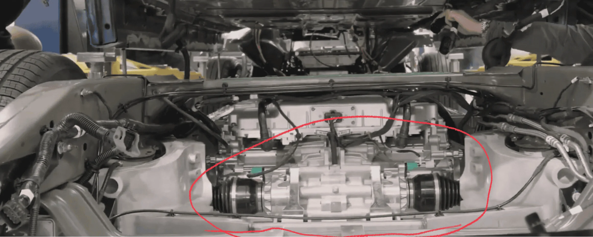

If it is this, looks like a major job. It looks like, they take customer satisfaction seriously. Not fun to deal with it but I hope you won’t let it take away from the joy you can get out of it after this.

It seems about as complex as replacing a transaxle on an ICE vehicle.

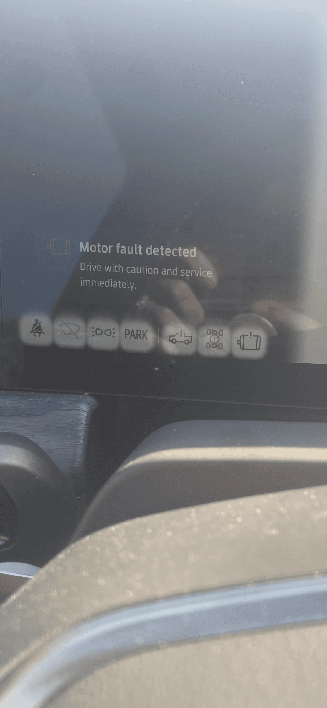

As the title says, I had a front drive unit failure at 40 miles. I had driven the truck about 5 miles and my wife probably 10 miles. Fortunately, it died in the driveway and not on the road because it was DRT. After almost 3 weeks, I’ll be getting it back tomorrow.
Can you provide a few details on how you knew you had a problem? Did you have driving problems, hear noises, etc. or was it "only" an alert on the display that told you there was a problem?
My wife was driving the truck and as she was pulling back in the driveway 2 codes popped up on the dash and the hazards came on. She stopped and it wouldn’t move again. They said the limp mode it what let her get to the parking spot then it was over.
I do now know how to do a hard reset so I at least learned that. We were hoping it was like my John Deere tractors where if you disconnect power it fixes most of your problems.
