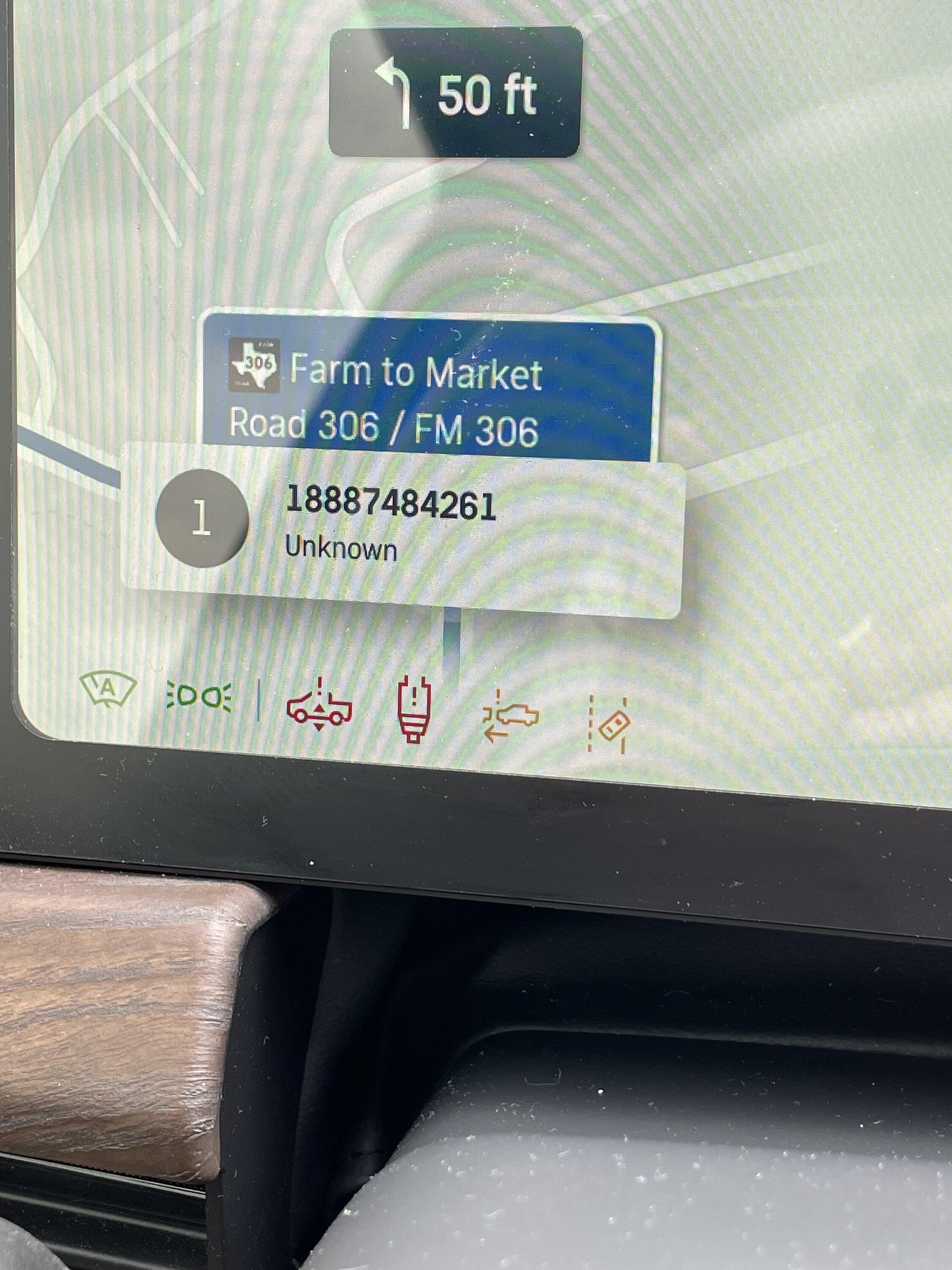

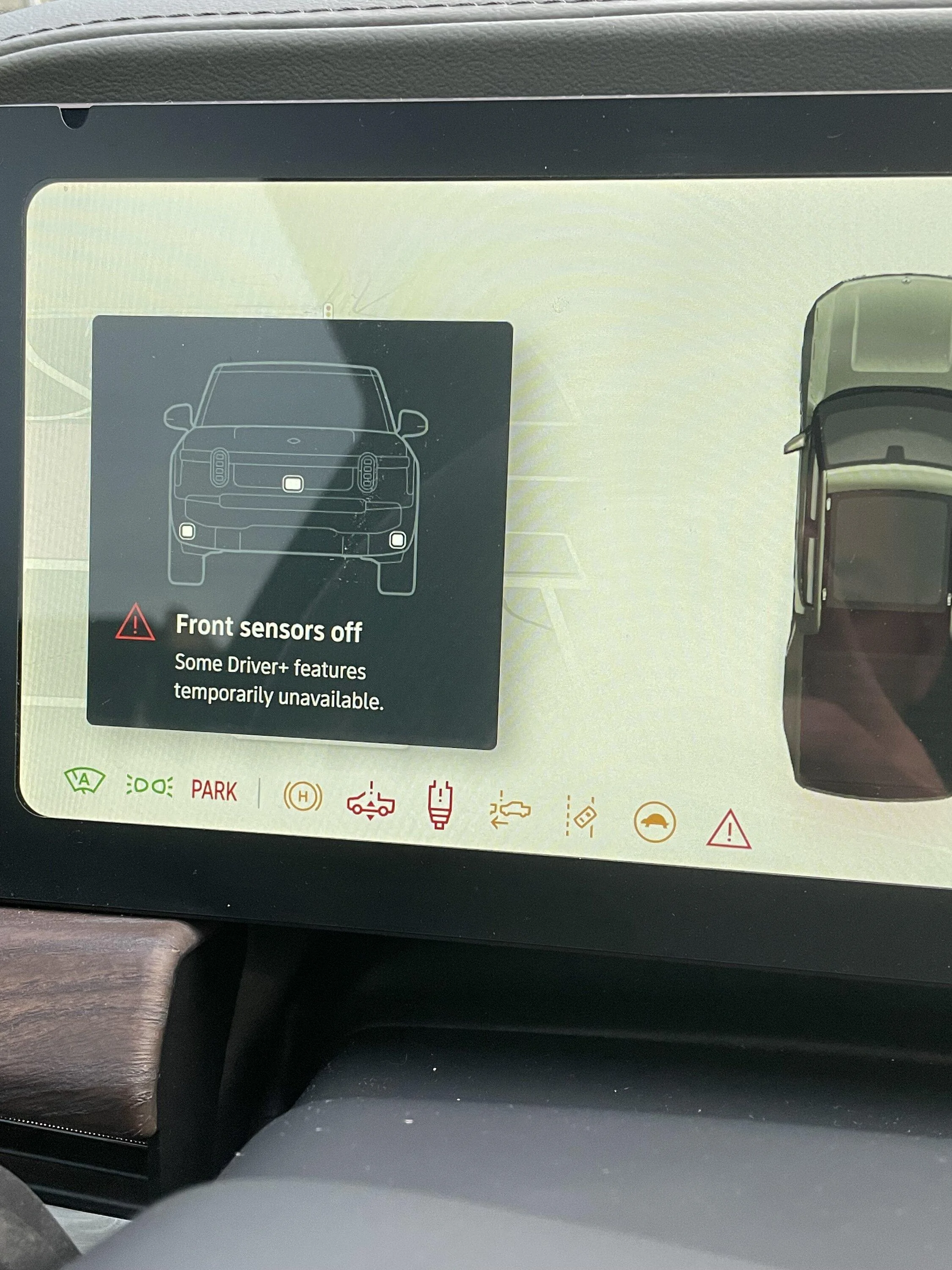

Reading through this thread, it sounds like I’ve had a similar reoccurance of issues.
1. Random notification of ā€œservice suspension system soonā€ with associated error lights for driver+
2. Happened for a 2nd time last night, but additional errors lit up and went into turtle mode.
Houston/Austin service centers are packed until Mid-July for an appointment. So fingers crossed the hard resets continue to fix the problem over the next month…
First time the error popped up:
Rivian First major issue with R1T after 9 months and 21K miles IMG_5679
2nd time with more issues (last night):
Rivian First major issue with R1T after 9 months and 21K miles IMG_2918
