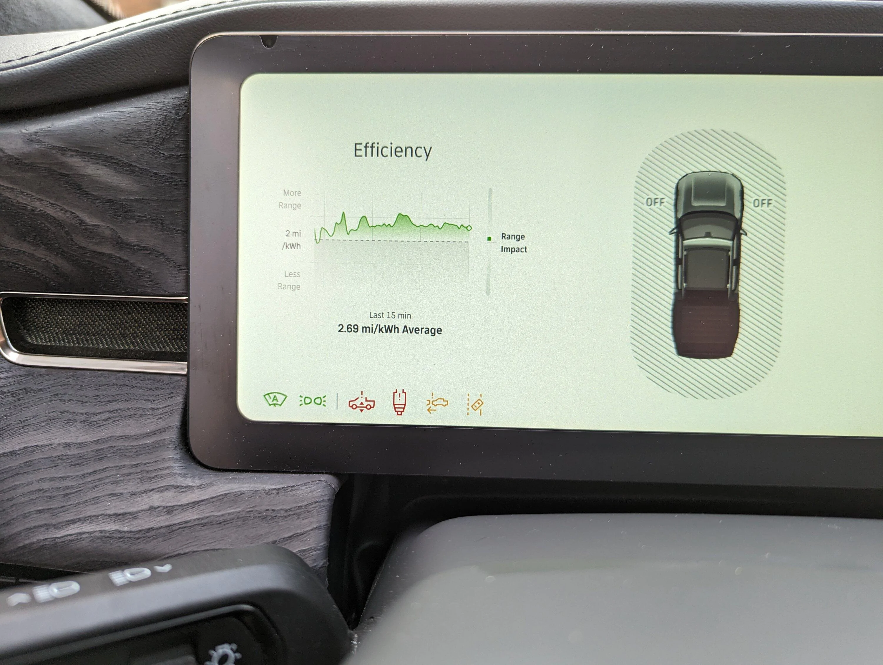

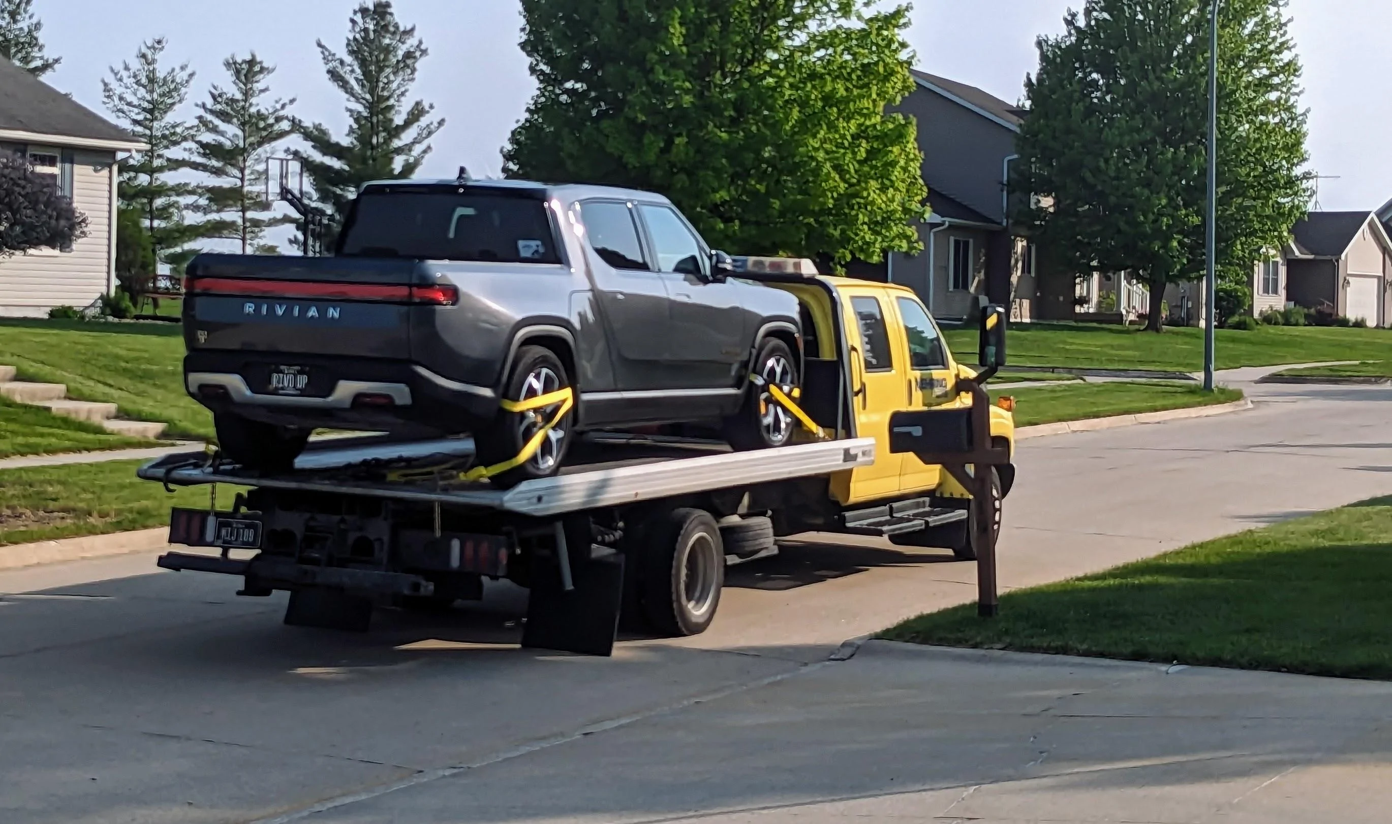

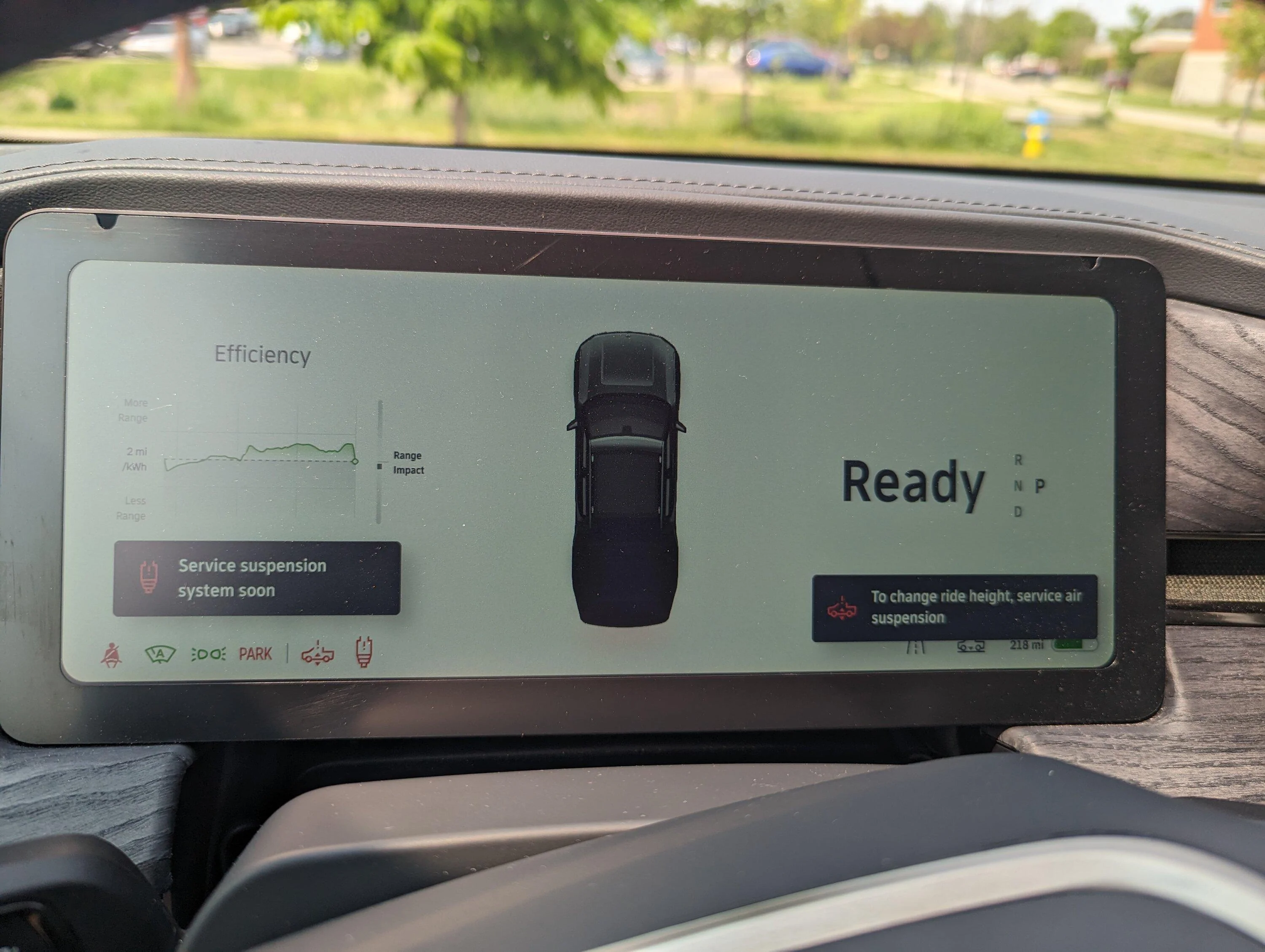

It was a sad day for me to see my R1T being hauled away on a flatbed to the SC in Minneapolis. Over the past week, I had been experiencing many warnings involving the hydraulic suspension, including the ominous "service suspension soon" and ride height can not be changed warnings. Although they were cleared by having the vehicle go to sleep cycle, they invariably came back, and neither were cleared either by a soft or hard reset. Additionally, I received warnings for Driver+ malfunctions, including forward collision warning faults, rear cross traffic warning faults, and adaptive cruise control not available. Don't know how these might be related (I am not sure they are), but all seemed to happen in quick succession. Then, to top it all off, and to ensure a trip to the SC, got the dreaded Turtle Mode (weirdly capped at 51 mph). Rivian support checked the vehicle logs and determined it was not something Remote Service could handle and set me up with an appointment to the Service Center. Our closest ones are Olathe, KS and Minneapolis, MN. Being equidistant between the two (~3 hrs), took the first availability. I did learn throughout the process that I can long press on my driver profile icon to set a diagnosic log capture to my vehicle event log, which I did as messages popped up on my screens. Handy. It just arrived at the SC last night, will update as I find out details, but was curious if anyone else had anything similar happen?
