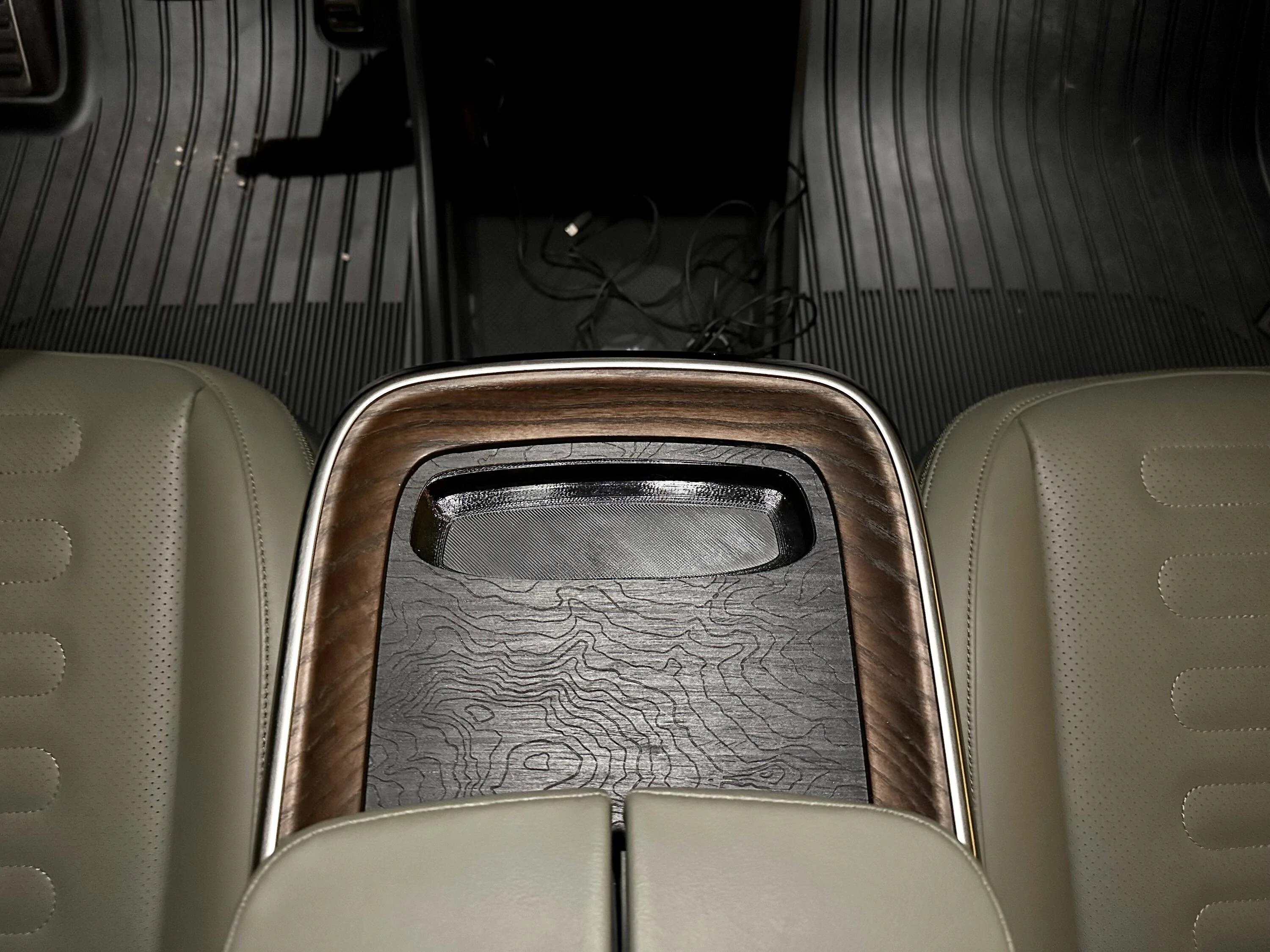

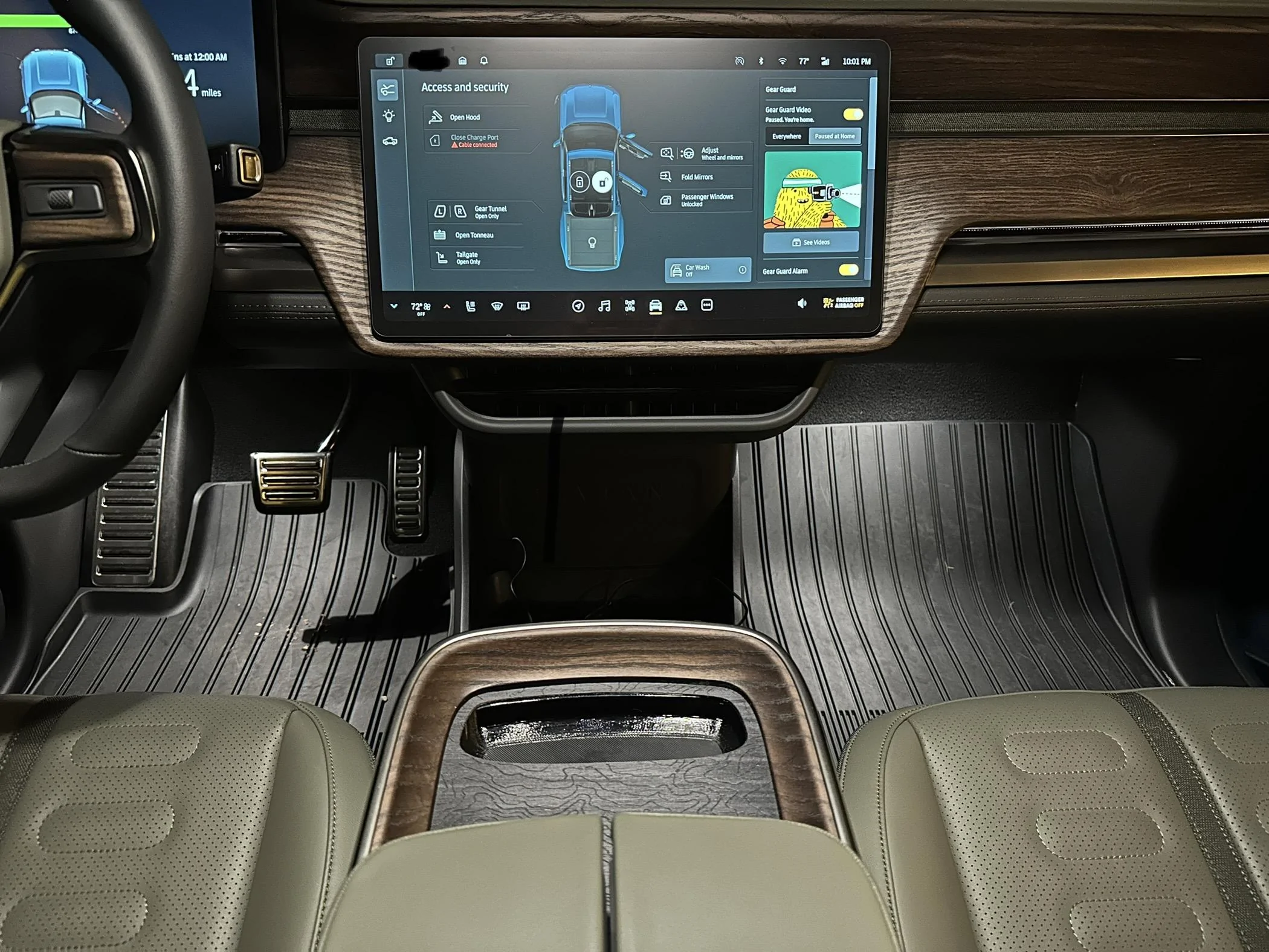

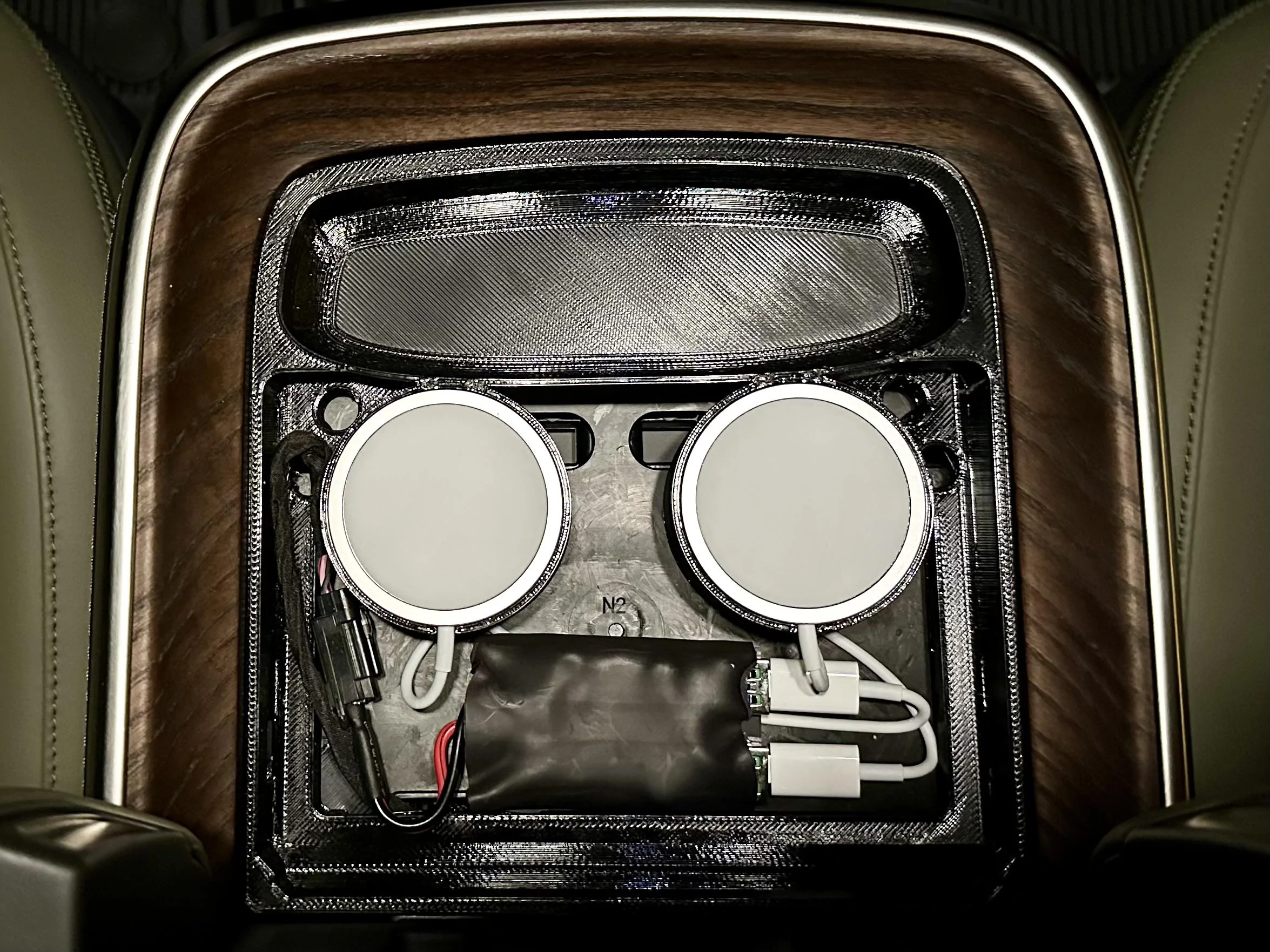

Installed!
Pretty clean installation using Apple MagSafe pucks - plenty of room.
Surprised at how OEM this looks! Both pucks charged my phone easily.
Happy to have both USB-C ports available for the upcoming DriveCam!
Really nice job on this product. Sounds like it was a ton of work. Your passion and smarts have paid off! The Rivian community needed this badly after the pathetic OEM charging pad attempt.

This is definitely the best charging option available IMO but I have some concern about the longevity of the top plate. Mine has shown signs of top plate indenting from the pucks underneath with the iPhones putting pressure on top, and also a slight crack line in the middle of the plate as a result. The cause for this is the pucks although fully seated on their seats are not totally flat horizontally on the top plane. I have taken the top plate off to try to adjust the placement of the pucks but I could still feel the bump from the driver's side puck on the top plate after reinstall. It's only a slight bump and cannot be captured on picture.

There should be a slight bump. Again this is for the pucks to be the highest point. However to see if the plate is seated correctly check the plate with the granola bowl. It should be perfectly flush. If not send me a DM. As for longevity: I've been running some version of this since January with no issues. However once the plate is aligned properly I do not recommend removing it repeatedly. The 3M tape on the plate helps keep the pucks properly aligned. It's good for 1-2 removals and after that it really loses its stickiness.

The bump is only on the driver side puck, and only on one side of the puck. It feels like the base might not be as level as it needs to be. I'm leaving it as is for now.
