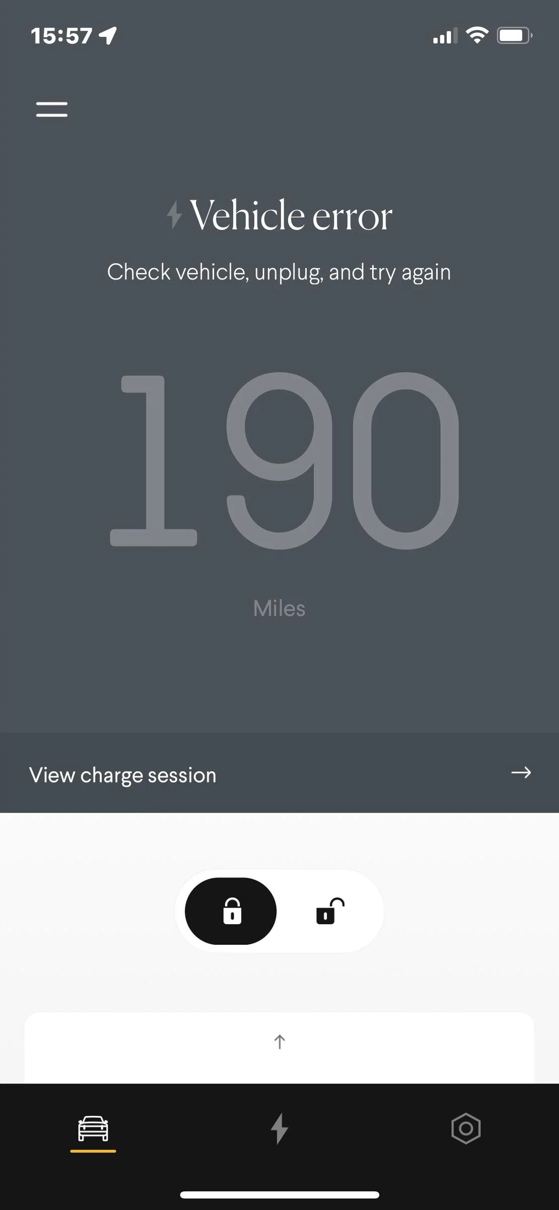

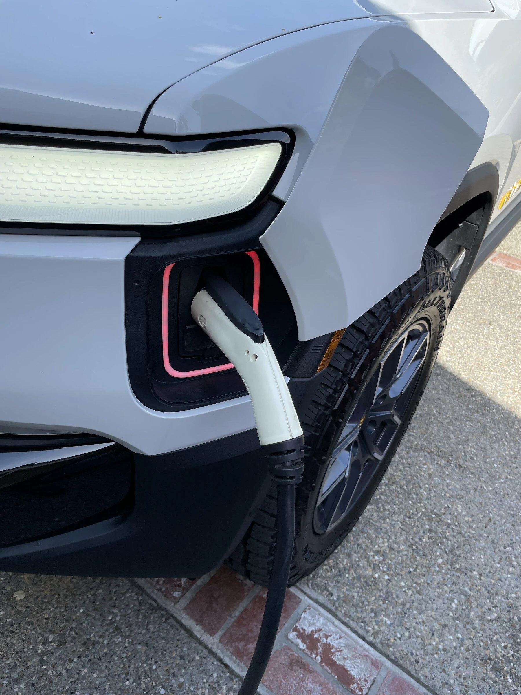

Has anyone experienced a time-of-use charging error? When I set my EVSE to TOU and plug the truck in, it faults after a couple of minutes. Turn off TOU, unplug/plug in the truck, all is well. Seems like a bug in the charger state transition to me...

We don't use TOU but still would wind up in stalemate conditions with the juiceboxes after hitting the charge limit. Basically, the R1T would charge full but then go into a fault state when keeping topped up, so I'd drop down to the high 60s SoC before unplugging.
I haven't seen the light turn red since updating to 2022.11.2 OTA, which, among other things, "Improved interoperability with third-party public chargers." Every time I've gotten in the truck since updating, I've had my target 70% SoC. So I think they loosened some things up to play nice with EVSEs that change state during a session.
Yes, I have this issue as well. It generally will clear the error and charge correctly once the time of use window opens. However sometimes it fails to charge.
