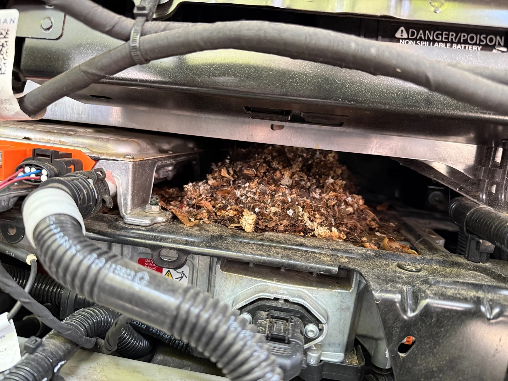

It’s just anecdotal, but I was experiencing this issue, and was told by service that it was a firmware problem and would hopefully be resolved in a future update. However after discovering and clearing some debris that rodents had collected in a cavity hidden behind the frunk bin, the problem went away and has not (yet) returned. My theory is that the debris was restricting airflow, leading to some component overheating.
Rivian R1T R1S Started getting random system faults when using cruise control/driver assistance IMG_0074
Rivian R1T R1S Started getting random system faults when using cruise control/driver assistance IMG_0075

I garage my R1T. No debris at all. Happened again today on dry, straight pavement, no cars in front of me.
