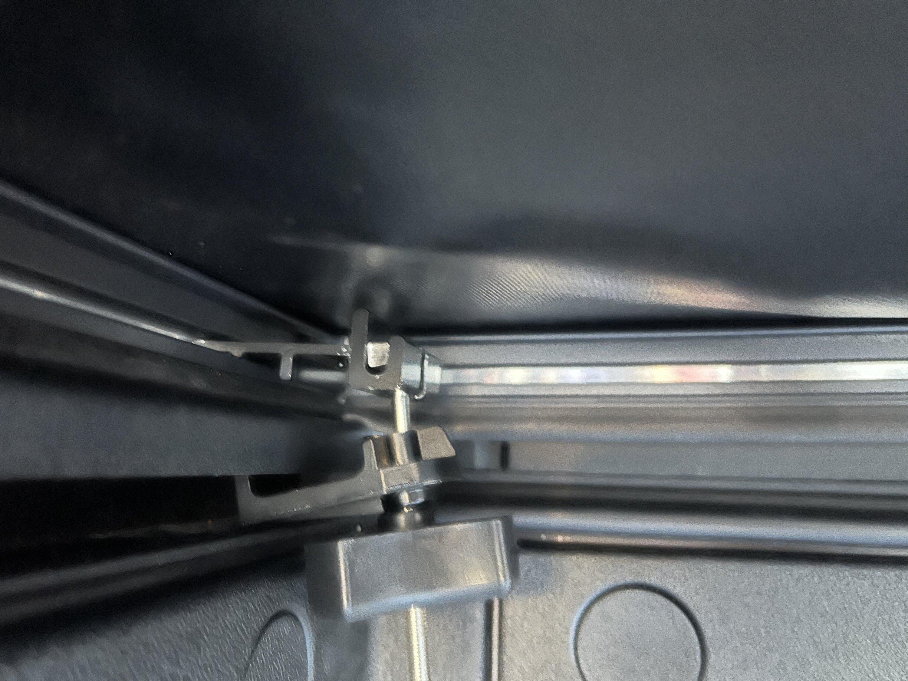

Fits like the previous ones, this item also includes a strip of weather seal which may come in handy at the front or tail-gate depending on your alignment.
Cross bars fit, but are tight. Keep in mind that you can’t really lift the tri-fold cover if the bars are there.

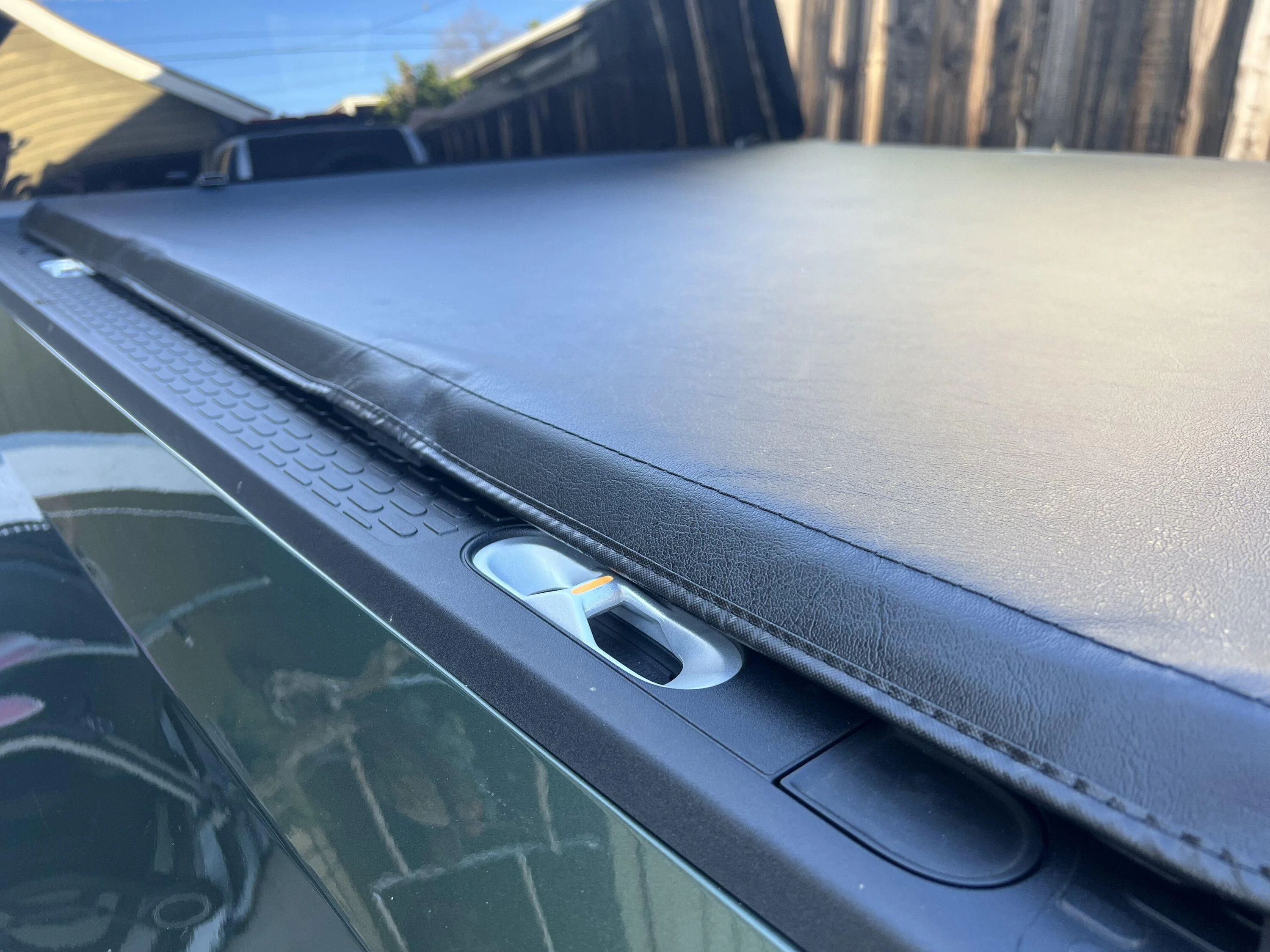

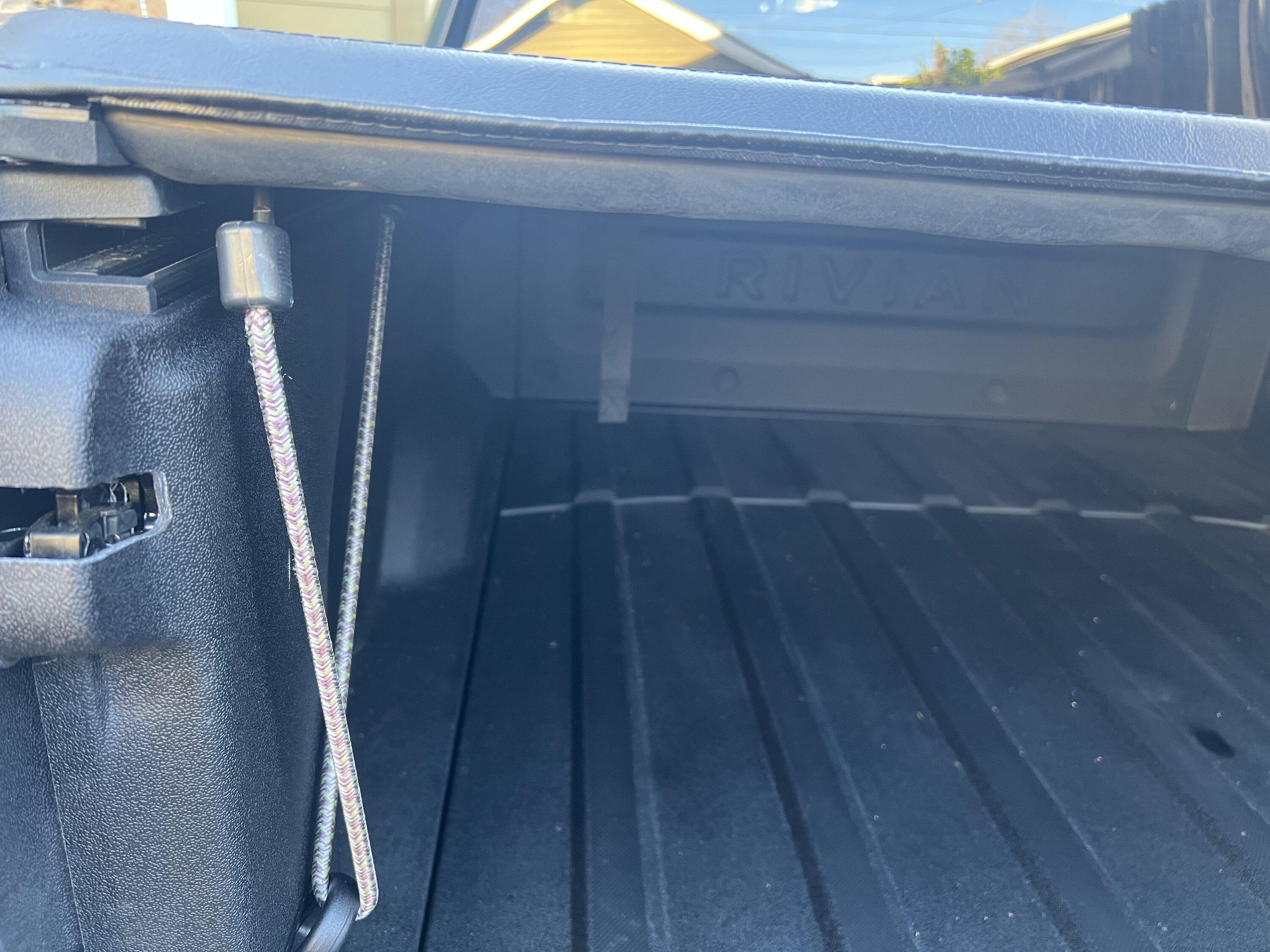

Been raining quite a bit here in sunny SoCal. Happy with the weatherproofing thus far from this tonneau. Water drops in bed resulted from the gate being opened for the photo and was not there prior.
Perfect. Thank you
