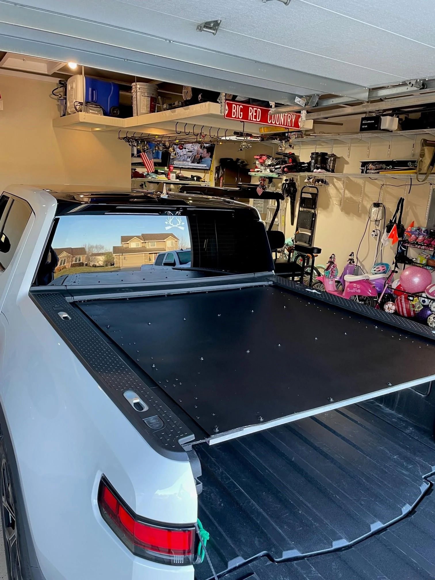

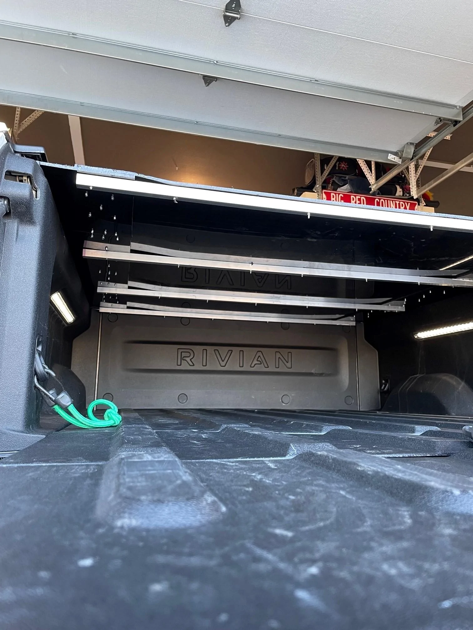

Just finished my go with 1x 4x8 sheet of HPDE from Menards and four aluminum braces for sag support. I had to cut extender strips for each side and just used rivets to attach those to the center piece. Then used self tappers to go into the 4’ aluminum bars that run across it. One coat of flat black paint. It’s pretty darn sturdy and I went down interstate at 85 and there no wobbles or noise. Super light, I can pick it up and slide it in/out easily on my own. Should do for now till Riv comes through with tonneau v2.0.

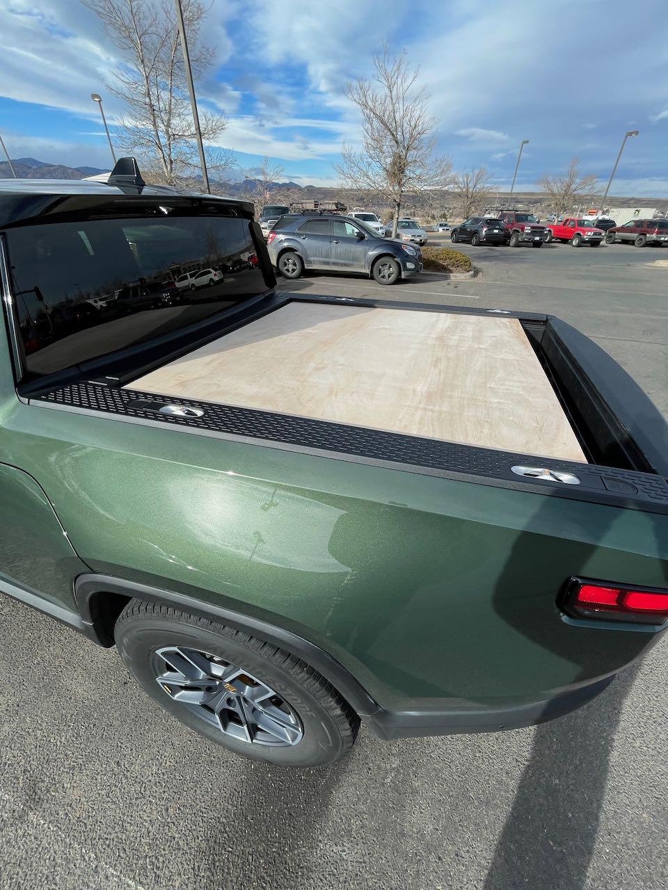

IMO, the marine grade plywood is the simplest, strongest, best solution. It's made with waterproof glue so no problem getting wet, but it still needs to be painted or varnished because the wood is not rot-proof.

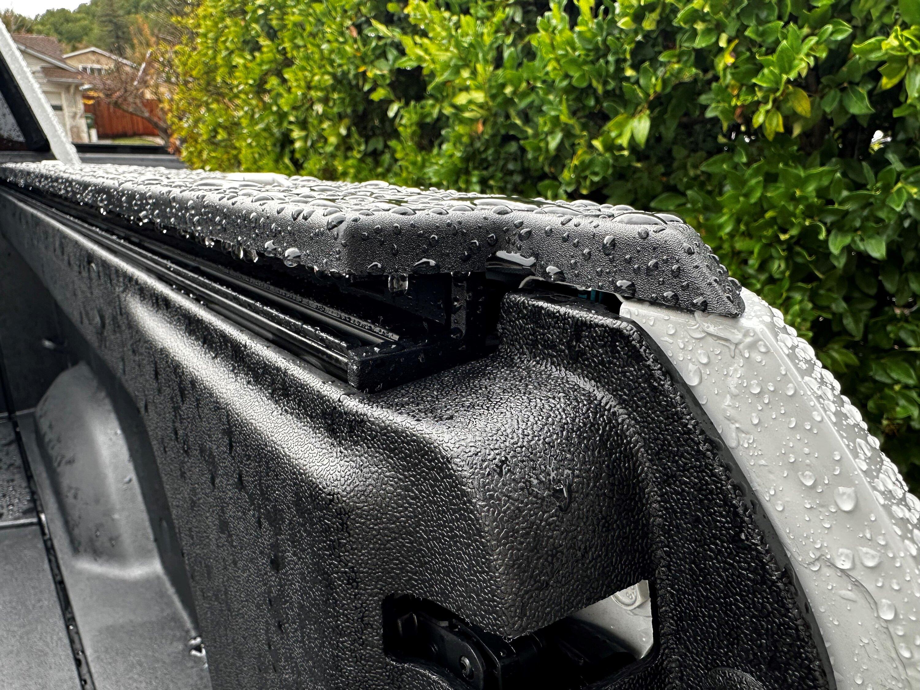

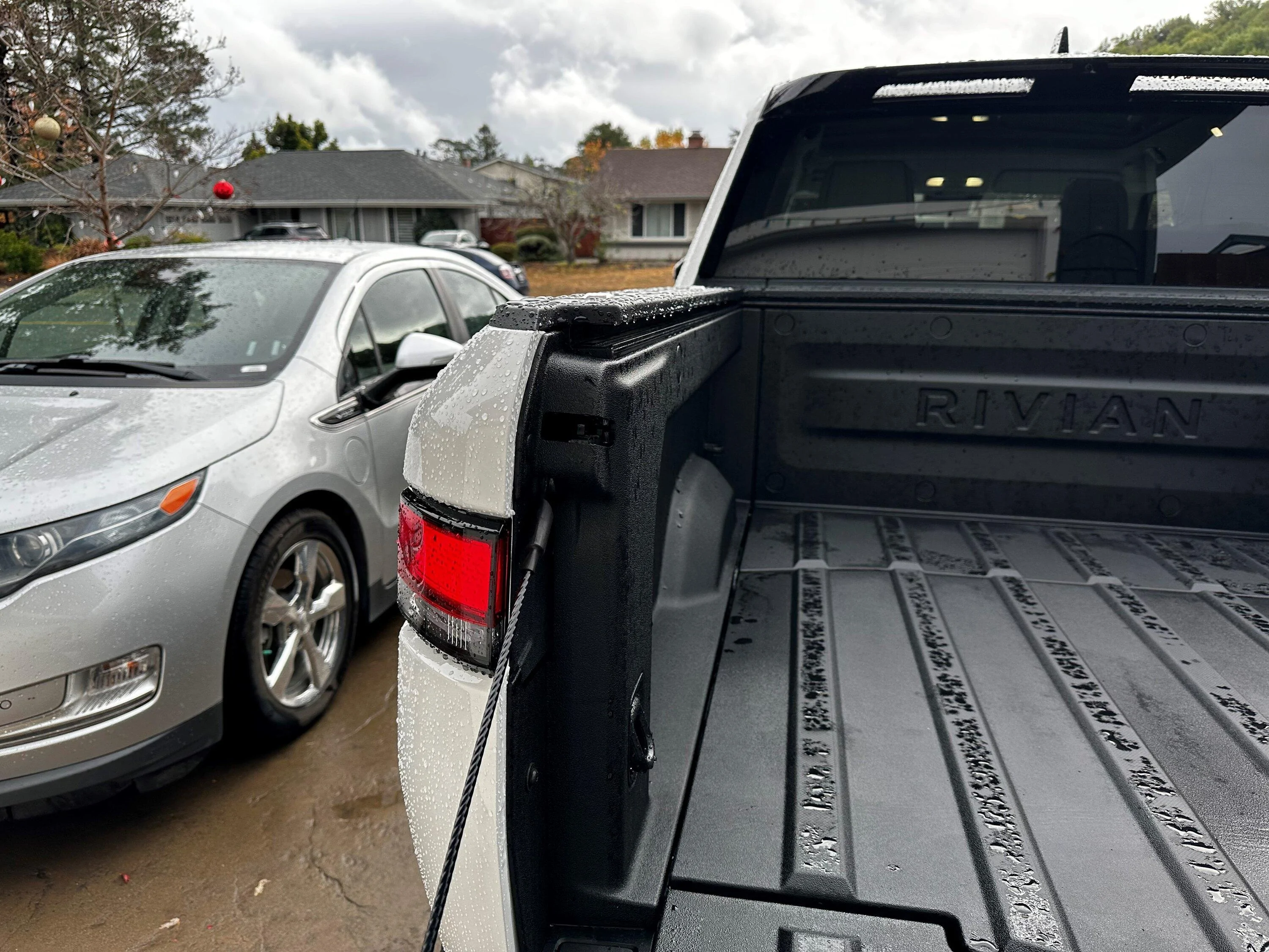

So I took delivery of my truck 2 days ago and had the no tonneau option, I've seen posts of people talking about having to cut open the back slot if they made some sort of manual DIY tonneau cover. But I haven't seen anyone mention of their truck already having the back slide rails of their tonneau already open to allow for it. Here are a few pics of mine showing the opening.
Rivian R1T R1S DIY temporary tonneau / bed cover? Riv2
Rivian R1T R1S DIY temporary tonneau / bed cover? Riv1

Thank you @sandsk8erz400 !
OT.. is that a Volt in the background? Very unique rims... I still have a set of 4 sitting in my yard from my 2014 Volt.

Just noticed how terrible those pics are with everything still all wet, sorry about that guys, I can take some better ones tomorrow when the rain lets up, but I can confirm all the trim pieces back there are a smooth factory finish, it's not like the service center just hacked it open haha.
That it is Rob, good eye, it's a 2013 premier which was the first car that started the EV transition for us. Stock rims for that trim/year.

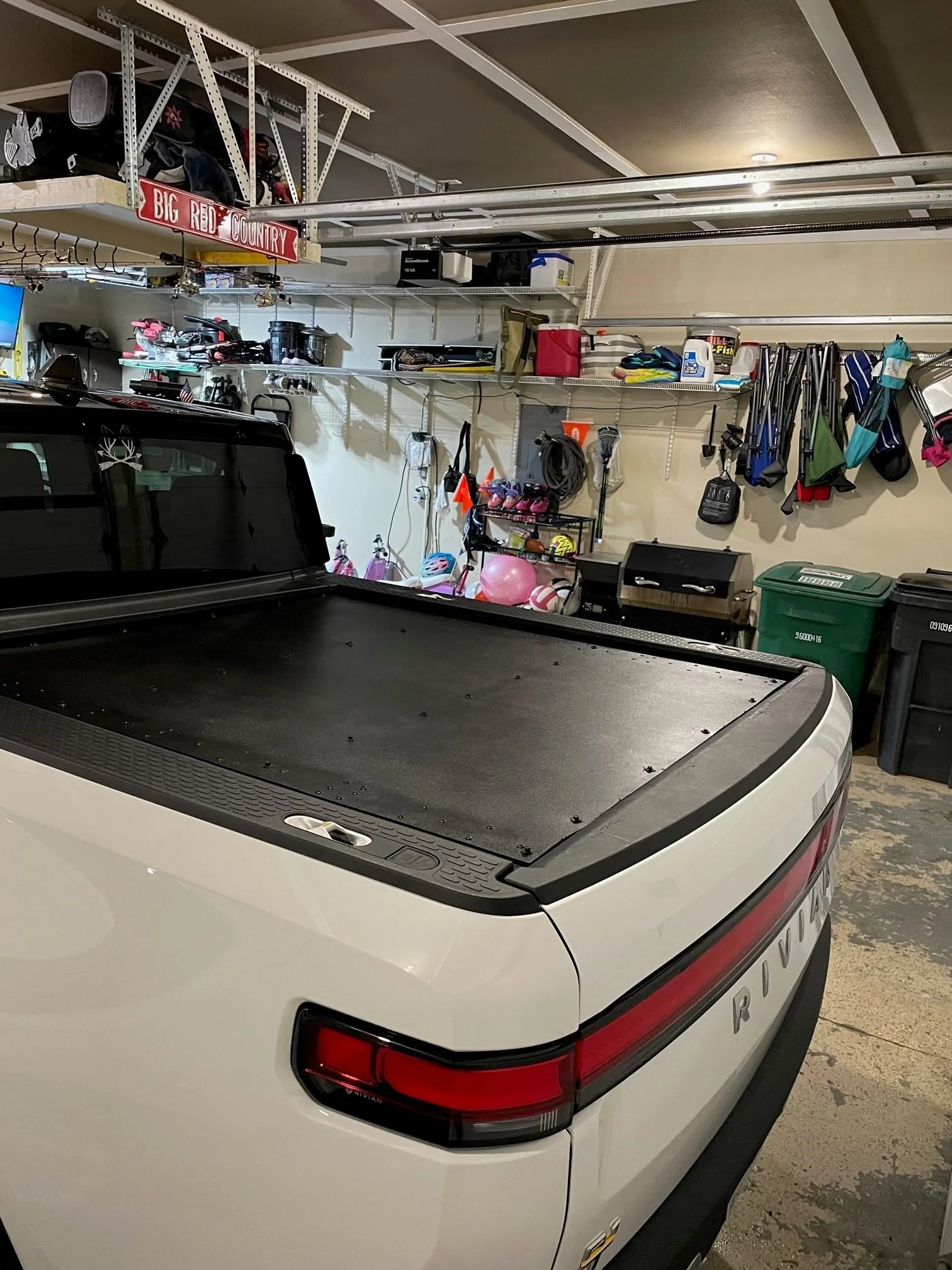

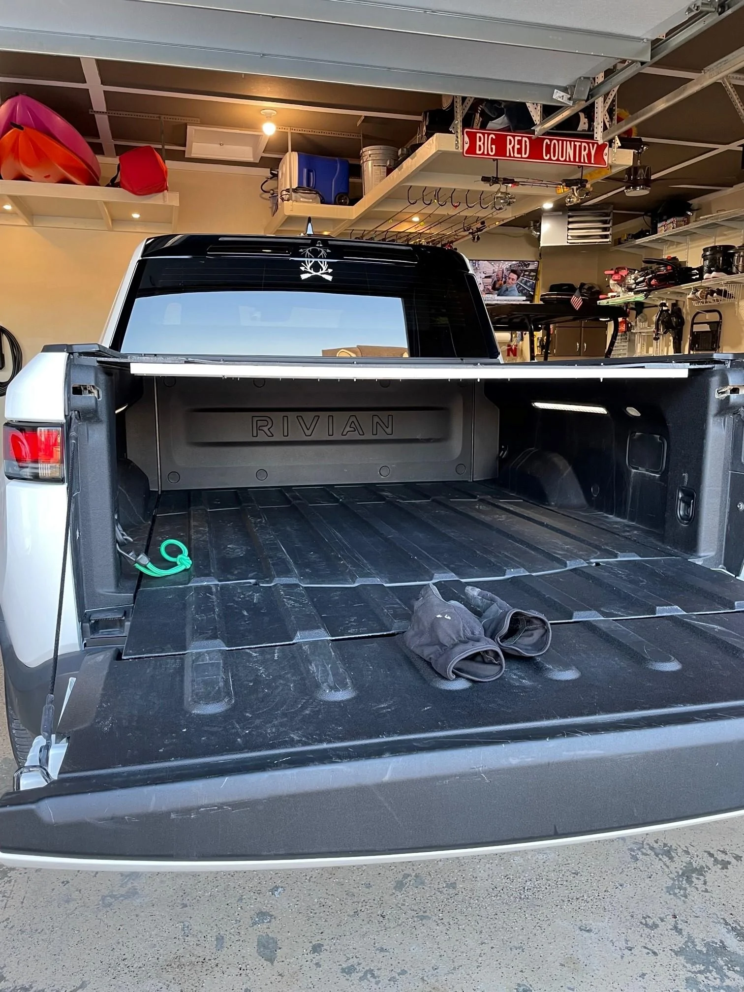

Hi, just got my R1T and it had no cover at all. Here is what I did:
Bought a 228 dollar Ford Maverick cover off Amazon, https://www.amazon.com/dp/B0B3MGFX2Z?psc=1&ref=ppx_yo2ov_dt_b_product_details. You need to modify install a bit,
You use the cover "tunnel" to mount/slide the brackets into and screw down the cover.
Replace the included wing screws (they are too wide for Rivian side plastic mold) with M6 nuts.
I flipped the included brackets upside down to get tighter grip
The back locking bolts won't work because they hit the plastic side of the Rivian bed, so I bought two heavy duty Bungy cords that locks the back. works like a charm.
Thanks for sharing - any chance you can post a photo of the result?

Service center told me they saw manual tonneaus in the production line in Normal. They would not take another stab at getting my tonneau into a 'closed' position since the last attempt broke during install. Urgh.
Rivian R1T R1S DIY temporary tonneau / bed cover? IMG_8174
Here we go. I'll post the results if I am not too embarassed lol
