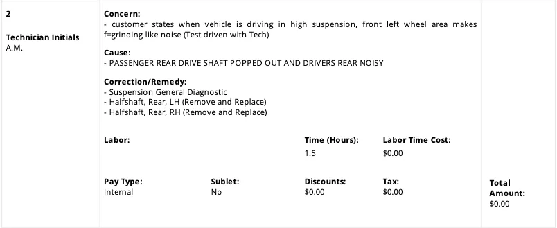

My car was in the SC for 19 days already addressing that toking noise. Also, my car was doing a grinding noise at acceleration in HIGH suspension settings.
Just got a call and service re-cap. They were not able to reproduce the tocking noise per documents. However, during the test drive, the tech was telling me he can feel and hear that tocking sound.
Regarding the grinding noise that was coming from the front left corner at HIGH suspension settings on the video:
In the documents that said the rear passenger drive shaft popped out. Seems like the same issue as the thread's author showed us...
Another interesting thing, they gave me the R1T loaner vin 114** and it makes the same grinding noise as in my video. The car had less than 1000mi when I got it as a loaner
Just as proof that the loaner having the same issue. Here is the video from the loaner which at the moment when I took this video had 1005 miles on it :)
However, it does NOT have a tocking sound.
