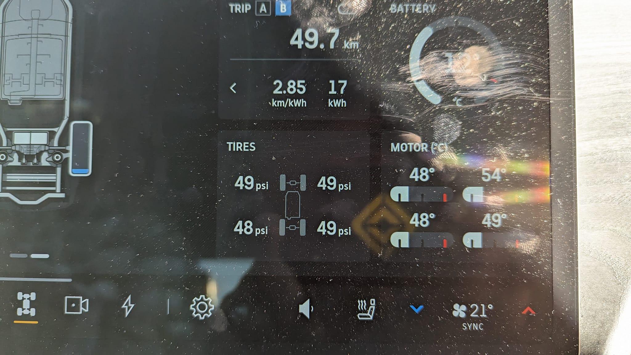

Question for those of you who have an issue with a pull to the right. Now that we have the new UI for drive modes, have any of you paid any attention to the motor temps? I had my R1T in to get the steering/alignment done the day before I got the new update and I'm happy to say that they got it to 99% sorted! BUT, there still appears to be a very subtle pull to the right at highway speeds - basically anything over 60mph/100kmph.
Out of curiosity I had a look at the motor temps and I noticed that the front-right motor was always almost 5c above the rest of the motors. All tires are at matching pressure, but that one motor is always running hotter. This has me thinking that it might be running harder due to a higher resistance (maybe a bearing?), which would definitely cause the drive system to counteract it in some capacity, translating to a possible right-pull bias.
Next time you are driving at highway speeds for a length of time and notice a pull to the right/left, check the motor temps. I'm curious what others are seeing.

My truck had an alignment issue. SC visit in July got it sorted perfectly I am happy to say. My front motors have a little variation as well. Now it looks like your temps displayed in C. Left shows approximately 118° F and right 129° F so about 11 degrees hotter. Mine normally don't vary by that much. Is it possible sure, but if the motor has an issue i would expect it to run a lot hotter.
Is there any vibration along with the pull? Any abnormal tire wear? These trucks are heavy and i have found the truck will really lean or want to go a different direction when the road is tilted slightly or with variation in the road crowning.
They should be able to provide you before and after alignment specs if your concerned about that. I can't answer 100% on the motor though. My variation has only been at most 5-6° F.
Keep in mind most of the time the front motors are doing more work both under acceleration and regen.

I noticed the same this week. The front right is always warmer than the others. I don’t have any pull or alignment issues though.

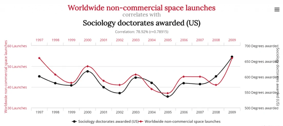

While it's possible that there is some connection between the temperature and the pulling, it's unlikely. It's more likely due to a slightly different cooling properties, such as routing and valving of the coolant lines.
"Correlation does not imply causation".
