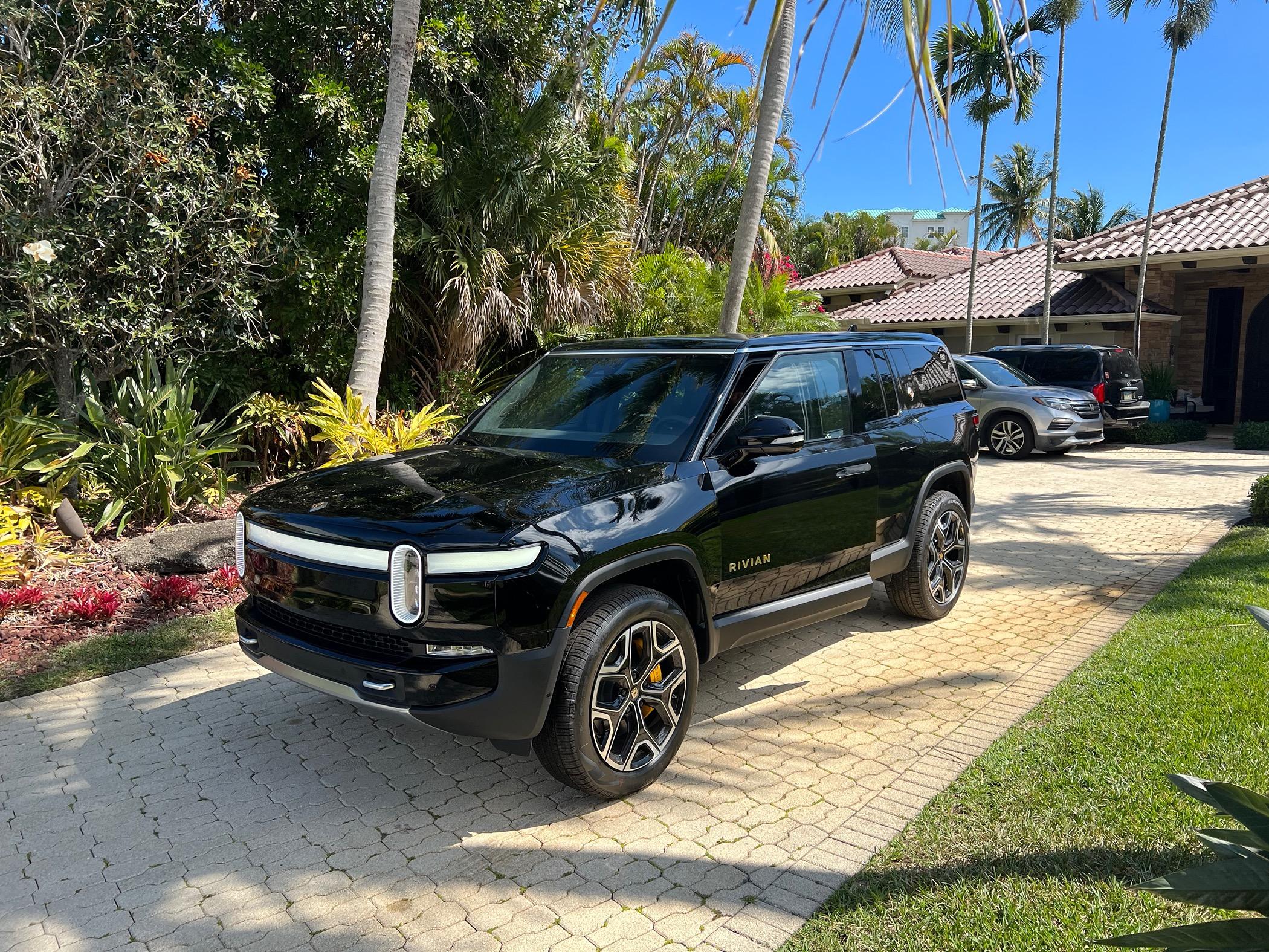

I have an R1S launch edition with the sport bright wheels and I’ve noticed that it pulls to the right. Rivian has done 2 alignment on it and the issue is still the same. Being told due to the weight that the car tends to follow the crown of the road. Is this something anyone else has experienced?
