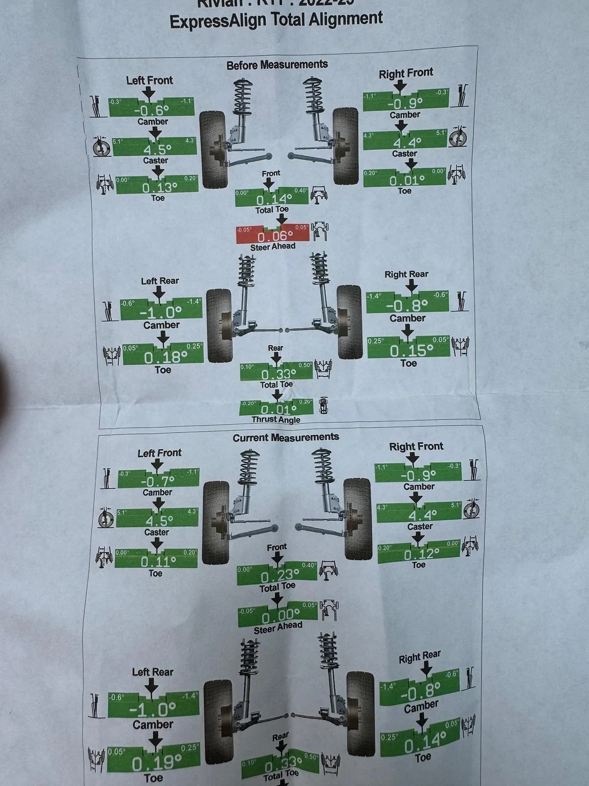

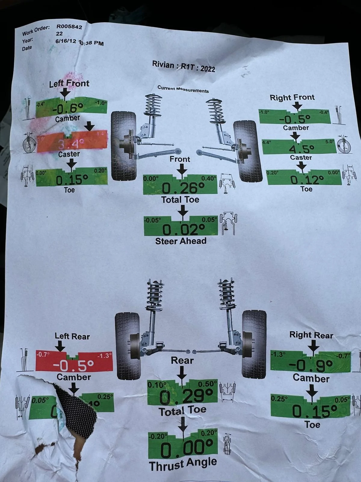

I finally had my alignment issue fixed but not by rivian. I had been at the service center in Miami 3 times and they could never fix the drift. Apparently they tell the techs to tell the customer to drive with 2 hands at all times ( to not notice the drift apparently ). My issue was when I held the steering wheel straight on a flat road the truck would drift to the right. Even engaging highway assist on a long trip the steering wheel was held at an angle to counter the drift. I went to a local alignment shop where they adjusted the caster by 9/10 on the left side and now truck drives straight on a flat road but does follow the crown of the road. Attaching the before and after alignment specs from rivian and then the independent shop for reference. Baby got to the second one before I could take a picture so I apologize for the quality :CWL:

@igodash thanks for posting, this is a good reference. BTW: It looks like the independent shop has slightly tighter camber and caster specs.
