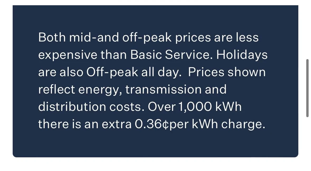

A couple flaws in your pricing:
1. Electricity billing isn't a simple "dollars on the bill divided by kWh used" - many locations/utilities have different rates at different times of day ("time of use" billing) or charge more or less once you exceed a certain kWh used in a month. (My utility charges more once you pass 1000kWh, but a neighboring utility charges *LESS* once you pass 1000kWh.) Plus, electric bills have a certain amount that is fixed every month, regardless of how much energy you use that month. Use less energy, and your "cost per kilowatt-hour" will be effectively higher, because that fixed amount is a larger portion of the bill, while use a lot, and the fixed amount will be a smaller portion of the total.
To figure out the actual cost to charge your vehicle, you'll need to look at your bill to figure out the "incremental cost per kWh" that charging the vehicle adds. Not the whole bill. If you have "time of use" billing, set your vehicle to charge only when electricity is cheapest (usually overnight.)
To use my own bill as an example, my "fixed monthly cost" is $11/month. I could be on vacation for a month and use zero electricity that month, and I'd still pay $11. (Actually a little more, taxes and fees that are a % of total bill are added later, but they're small.)
Then I have my actual usage. My bill is a confusing mess, with a dozen different types of charges and credits; but I'll combine them all. I have "time of use" billing. During "peak" times (3 PM to 8 PM) my total cost per kWh is $0.22261. During "off-peak" times (10 PM to 6 AM) it's $0.04123. During "mid-peak" (the spaces in between: 6 AM to 3 PM, 8 PM to 10 PM) it's $0.16896. Then once I use 1000 kWh, any above that adds an extra $0.0036 (slightly more than 1/3 of a cent per kWh.)
With multiple EVs in the house, I use more than 1000kWh most months, so I would count that in my cost.
Because I only charge overnight, I count my charging as the cheapest rate $0.04483 per kWh (with the >1000kWh surcharge.)
2. Your kWh per mile seems way off. Unless you've done all your driving so far towing an unaerodynamic trailer, 21 kWh to drive 21 miles seems bad. Of course, if you've only driven 21 miles, things may be a little wonky. I'd wait for a few hundred miles of driving to get a good measure of your actual efficiency. Depending on your wheel/tire choice, it should be between 1.8 and 2.2 mi/kWh in normal daily driving when not towing.
I'm going to use the bad case. I just got done with a long towing trip. My long-term efficiency of that trip was 1.24 mi/kWh with the trailer. So at my home charging price, I will pay about 3.6 cents per mile.
By comparison, my uncle driving his F-250 diesel, towing his trailer, paying diesel prices in Arizona, was at about 28.6 cents per mile.

Are you really only paying an extra $0.0036 per kWh once you eclipse 1000 per month? I’m assuming you also use PGE, so please disregard if I’m wrong. One reason I couldn’t ever switch to TOU is because it says it’s an additional $0.36 per kWh over 1000, not just $0.0036. Like you, I oftentimes go over 1000 at least a few months per year - the worst I ever saw was 1715. That would mean an extra $257 on top of an already hefty bill just for using TOU (would probably be close to $500 for a single month!). But if you’re actually only paying $0.0036, that might be worth the gamble.
