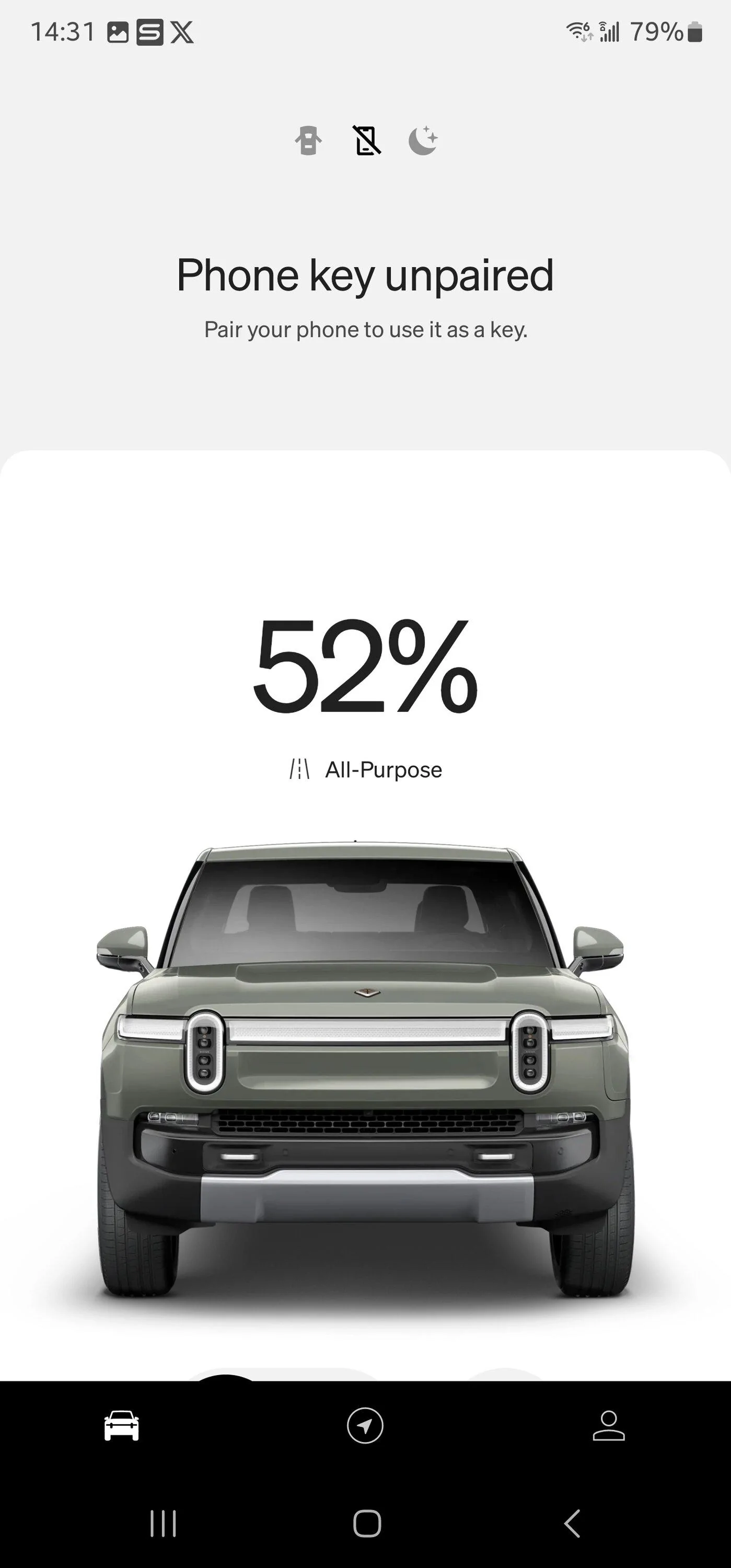

My app has been reporting my phone key unpaired for 2 days now, however PaaK is still getting me to and from the office every day. I haven't had the FOB with me, no other prox key in place. There is definitely still some pairing in place and working, at this point I'm just letting it ride to see if it stops working...another oddity with Bluetooth and PaaK, figured I would drop it in this thread.

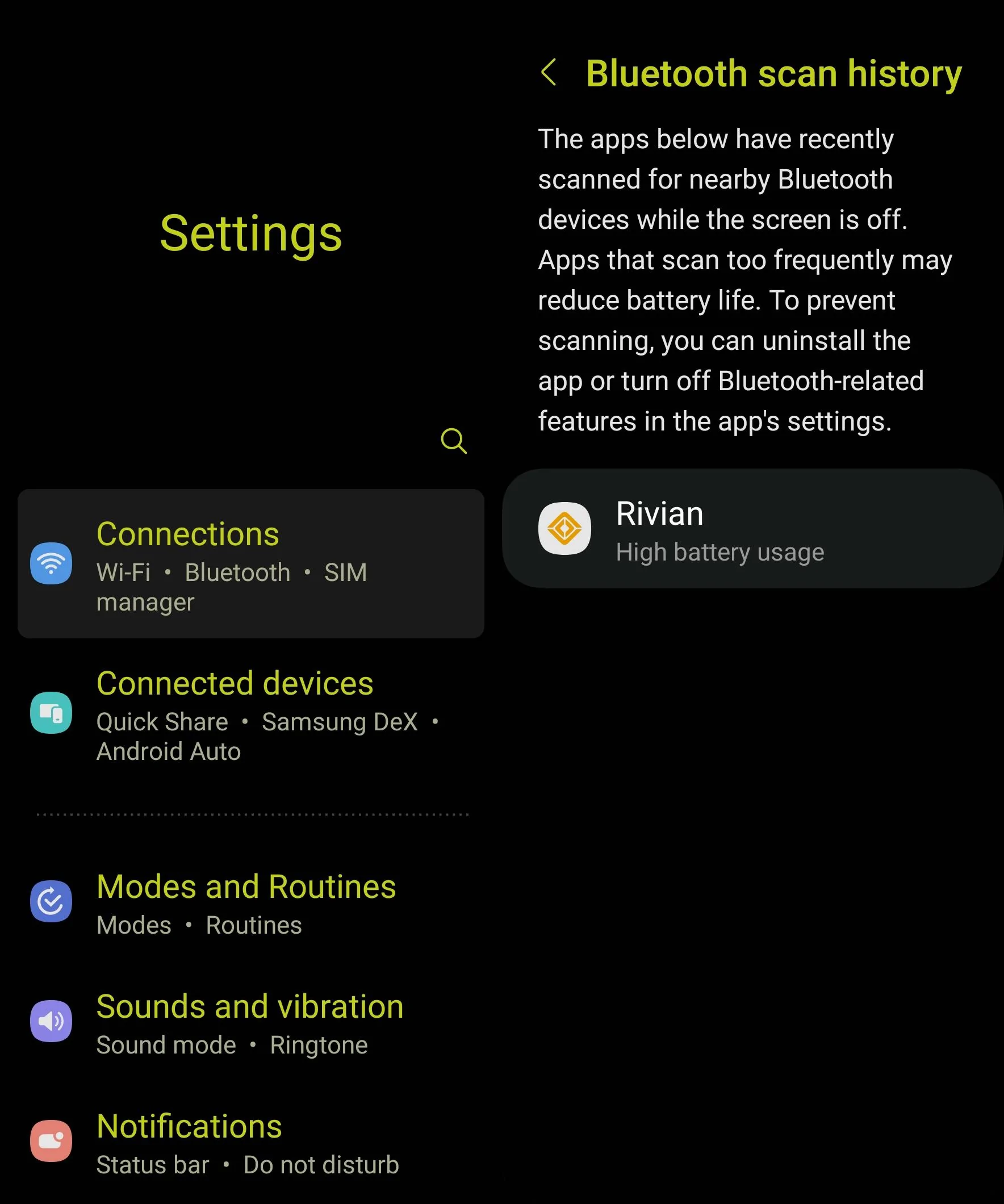

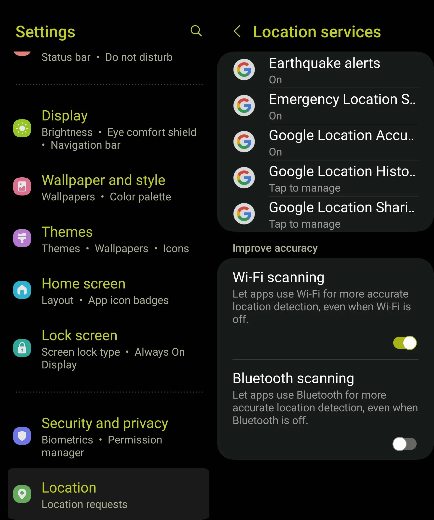

I have a Samsung S22 and noticed this too. If you turn off bluetooth AND location then it won't unlock. But if you leave either one on it continues working.
I've also noticed the Rivian app is a real battery hog. My phone is constantly notifying me that the app is BT scanning frequently which impacts battery life.

It's called bt scanning I think.
