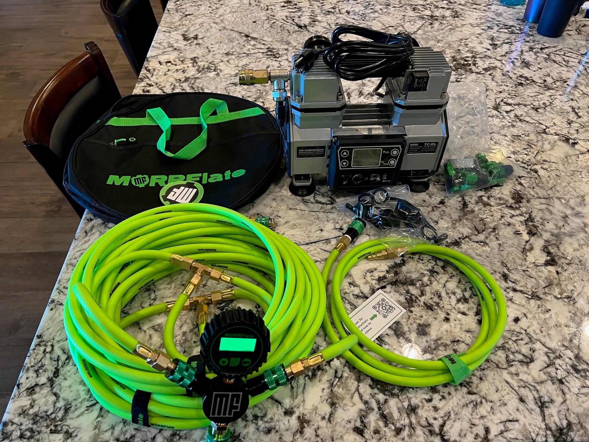

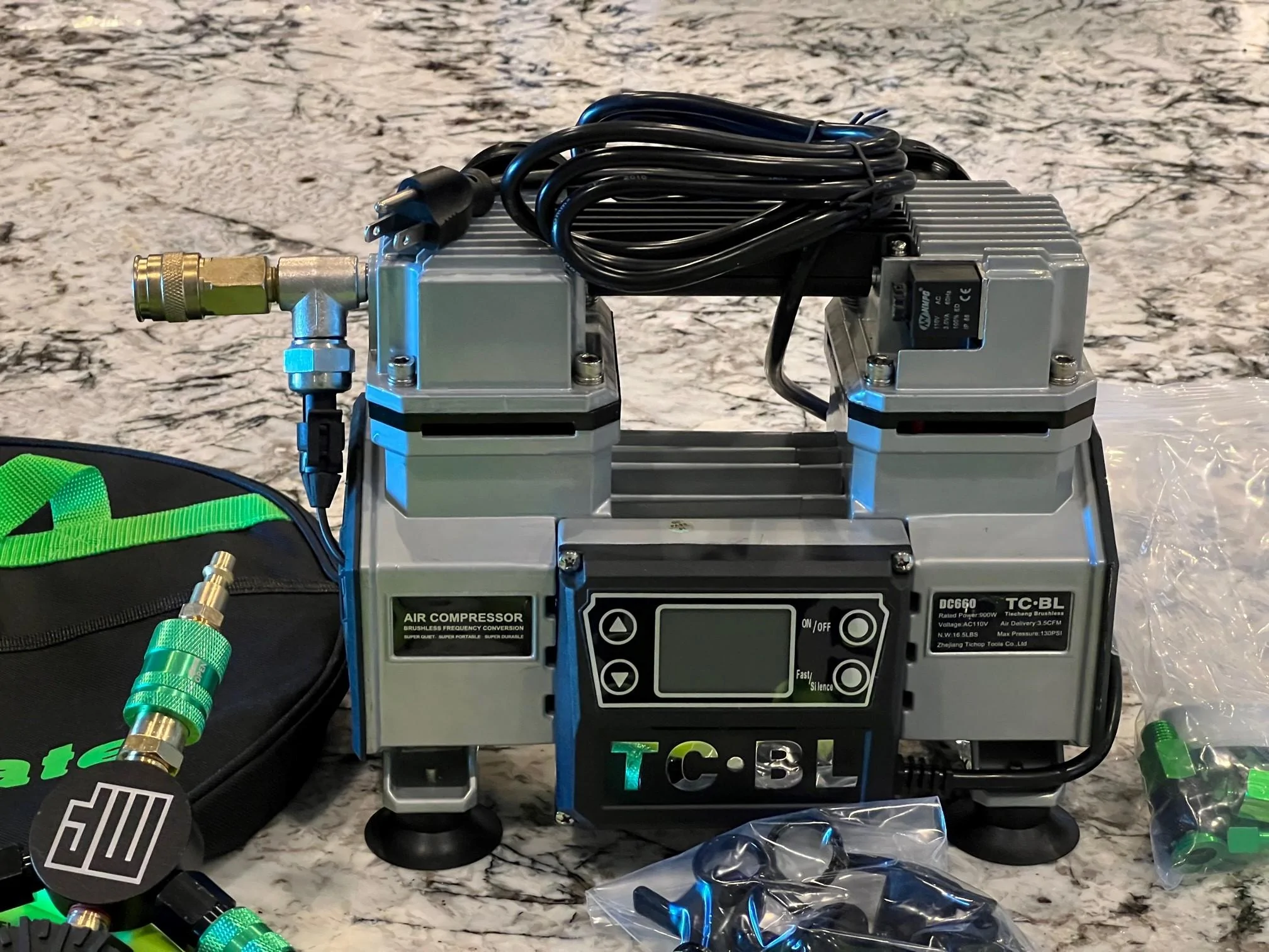

Well, hopefully this will qualify much more as an upgrade than a backup. Dual pump with some good features and if look close yes that is AC power and its rated at 900W so should easily be good on the 1500W inverter. Good flow specs at 90 PSI so should be much faster than the ones spec'ing at free flow. First test was very promising on our Tesla and the dual speed pump is quite also, but need real testing on bigger tires and planning to do separate video. The four tire MORR Flate setup also helps as they are more efficient as the tire valve stem is a limiting factor so get more flow, not to mention not loosing a bunch of compressed air with the non-sealed hose setup Rivian provides.

Awesome to see you found MORRflate and that you found the TC-BL compressor. I'm embarking on the same exact journey. I have an engine driven York compressor (converted from A/C) on my jeep, and twin ARB on my Excursion and I am finding the Rivian single compressor just isn't cutting it with my MORRflate and ~48psi street pressure.
I recently stumbled on the TC-BL 110v compressor, but hasn't pulled the trigger yet. I'm very excited to hear what you think, as it seems to be a reasonable solution.

Hey CJ,
Sorry late reply, was not getting notifications ...
Yeah, the MORRFlate system is very nice combined with the TC-BL pump. Just keeping my fingers crossed it lasts. I even reached out to MORRFlate and others to please consider making A/C versions of their nice pumps as several vehicles have good inverters and other uses like with an RV generator or even at home. So, I don't just use it with the Rivian. Used it a few times now even for 35x12.5-18's which is a lot more volume to fill plus needed 80 PSI in those for my diesel truck and it is still fast.
I am going to add a tee to the MOORFlate inlet side of manifold with ball valve to be able to manually deflate to atmosphere/adjust pressure down when everything is connected as I think that is a slight oversight on these 4 tire inflation systems. Also, helps to vent lines or pump too easier when done.

Hey, great news! Yea, a good compact AC-powered compressor really seems like a unicorn. I'm glad to hear this one is working well; I plan to give it a try.
The latest quad MORRflate system has a sliding collar (which I see in your video), so you can deflate while still hooked up, I thought. I have an older model with a ball valve which I use. Great if you overshoot your planned pressure.
Edit: after watching your video, I realize you are talking about the compressor. Makes sense. Thanks for the great video!
