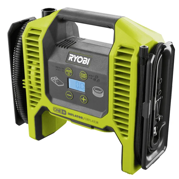

Ryobi and Milwaukee are owned by the same parent company.
Ryobi air compressor is more versatile and is $69, the Milwaukee version is not so much and is $179. But yes, same parent company...

Thank you others for the Ryobi suggestion - I already have 2 batteries that work with it so this seems a reasonable backup/secondary option. Then I can stop borrowing my sister's inflator for the kiddie pool, too ;-)

I'm a Milwaukee tool guy, but the Ryobi air compressor is much better and more versatile than the Red. You don't even need to bring a charger, a single battery will last for dozens of tires.
https://www.ryobitools.com/products/details/33287178780
Something like this might work for one tire, but doing all 4 from 30 to 48 psi will be WAY over the duty cycle rating and will likely overheat and eventually damage the unit.

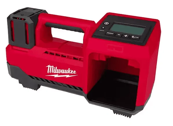

Thanks for the thought. People seem to be leaning towards the battery powered options, but if you have a recommendation similar to the Viair 400P that could be plugged into the 120V 1500W outlet I'd be interested. But I'm worried the circuit may be the same that the onboard compressor uses, risking overloading if both are being used.
Do you think the Milwaukee M18 will suffer from the same duty cycle issue as the Ryobi?
According to Car and Driver, the M18 is much faster (2:26 vs 8:00 inflation time to 45psi)
He tests both Ryobi and Milwaukee!

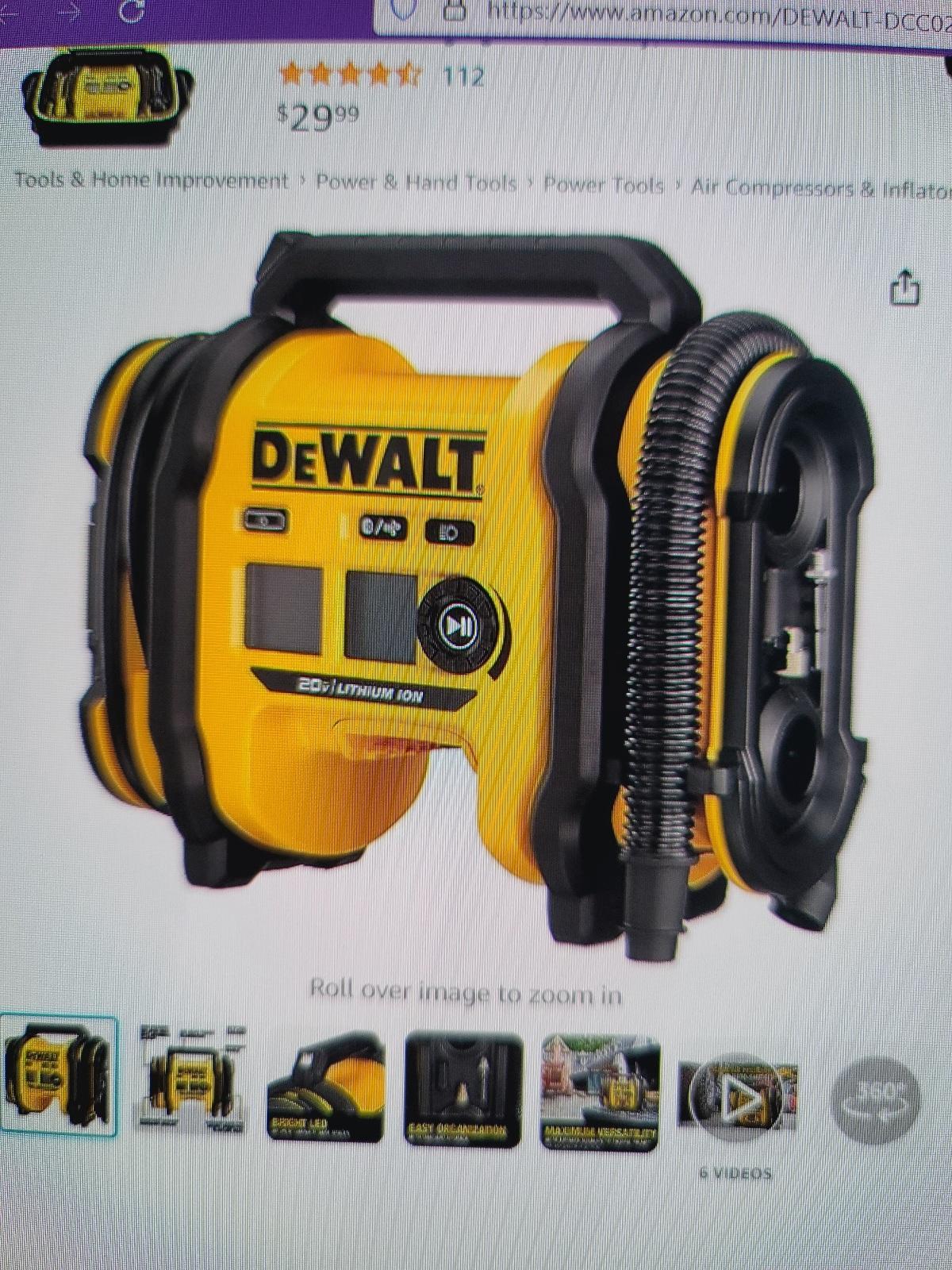

I have been using the Dewalt 20 volt portable compressor for about 5 years. I have used it a lot and it always does the job. It can run on a 20 volt drill battery or can be plugged into a 12 volt outlet.
I also have this compressor and it works fine. The air flow is lower than what is on the truck though so be prepared to wait a while if you are airing up 4 Rivian tires. I used to carry mine around with me but because it was more convenient for blowing up an air mattress or pressurizing my road shower than the truck's compressor.
