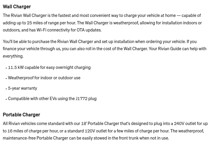

Is anyone buying the $500 wall charger? Does that charge faster than the standard charging wire that comes with the car?

Charging my Model 3 on a normal 120V plug is 1 kW. So, 0 -> 100 would be 100H. You can fully charge a model 3 in about 6 hours on a level 2 wall charger. It'll be even more significant on a Rivian since they're 130 kWh batteries.

I thought the standard chargers that come with the car are the same 240V as the ones for appliances? They are slow but still charge the car in 8-10 hrs which would be fine overnight.

This sounds awesome. Would this limit the amperage at all?
Yes, you would have to set the dip switches on the charger to limit the draw based on your plug. If it is a Nema 50 depending on the wire and breaker it would be a 40 or 50 amp circuit so would be limited to 80% of that so 32 or 40 amp draw.
That would be the same though if hardwired if you are planning on using the same circuit.

Can NEMA 50 (with an adequate circuit) hit the peak of this unit? If not is there a NEMA plug/circuit combination that could safely draw the max current you could achieve with a hardwired connection on the same unit?
