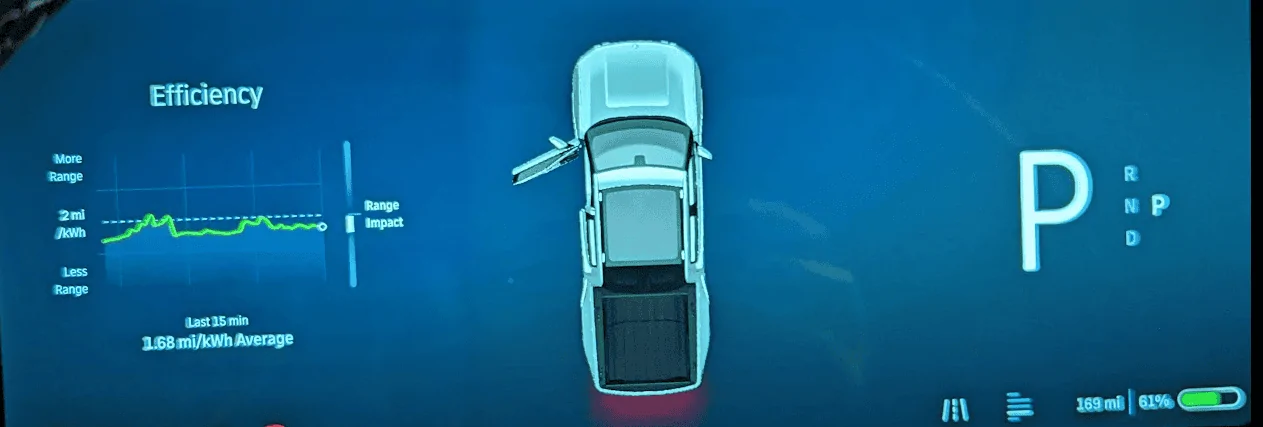

Did another, longer test at the airport. Since this was longer, rounding of the state of charge display should have a smaller impact.
Temperatures: 40's - 70's
Gear Guard: on (380 videos recorded!)
Time elapsed: 163 hours and 15 minutes (6.8 days)
Starting state of charge: 80%
Ending state of charge: 68%
Calculated average power consumption: 99.2 watts (pretty consistent with last natural test)
I will note that my estimated efficiency on the way home from the airport was lower than average (in all purpose mode, ride height at low). Could have been due to some battery conditioning or heating.
