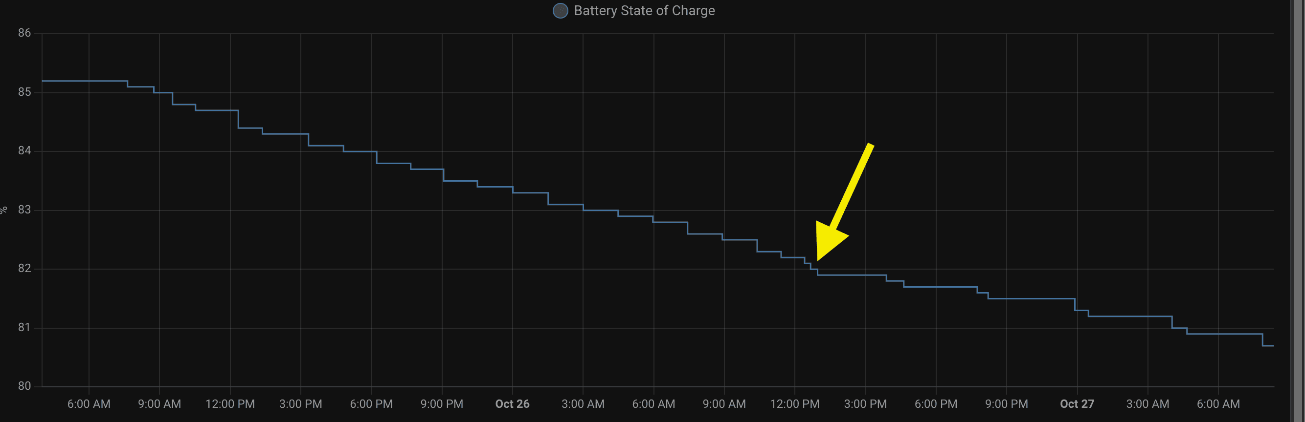

Incredibly, 2022.39.0 is the first update in quite a while to not advertise vampire drain fixes, and the first one I've seen since I started tracking that actually does take a significant chunk out of it.
Yellow arrow below is when 2022.39.0 finished installing on my truck. Notice a significant flattening of the curve since then, from approx 1% every 12 hours to 1% every 18 hours - a 33% reduction in drain.

Thank you for posting your findings! And yes, I think they'd rather just not mention the vampire drain updates and instead work on them in the background.
Hindley_Milner
Aug 11, 2022
56
Electric City
I don't know about that. The last few updates they claimed there were significant improvements, and there weren't, at least not for me.

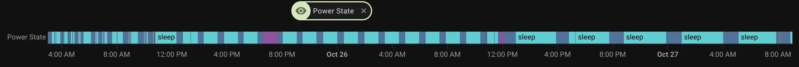

There's also a significant change in the sleep/wake cycle. The long wake cycles correlate with the battery dropping in both charts. It's nice that they've increased the length of the sleep cycles, but they really need to decrease the length of the wake cycles.
Do you have a time-correlated network activity graph? I wonder if the length of wake has a strong correlation with network activity? A faster internet connection may result in a shorter wake time.
Hindley_Milner
Aug 11, 2022
56
Electric City
I don't, it doesn't reliably connect to my wifi when sleeping. That said, I find it hard to believe it would need to download anything for an hour at a time. The connection is pretty good, 50 mbps+ on cellular.
