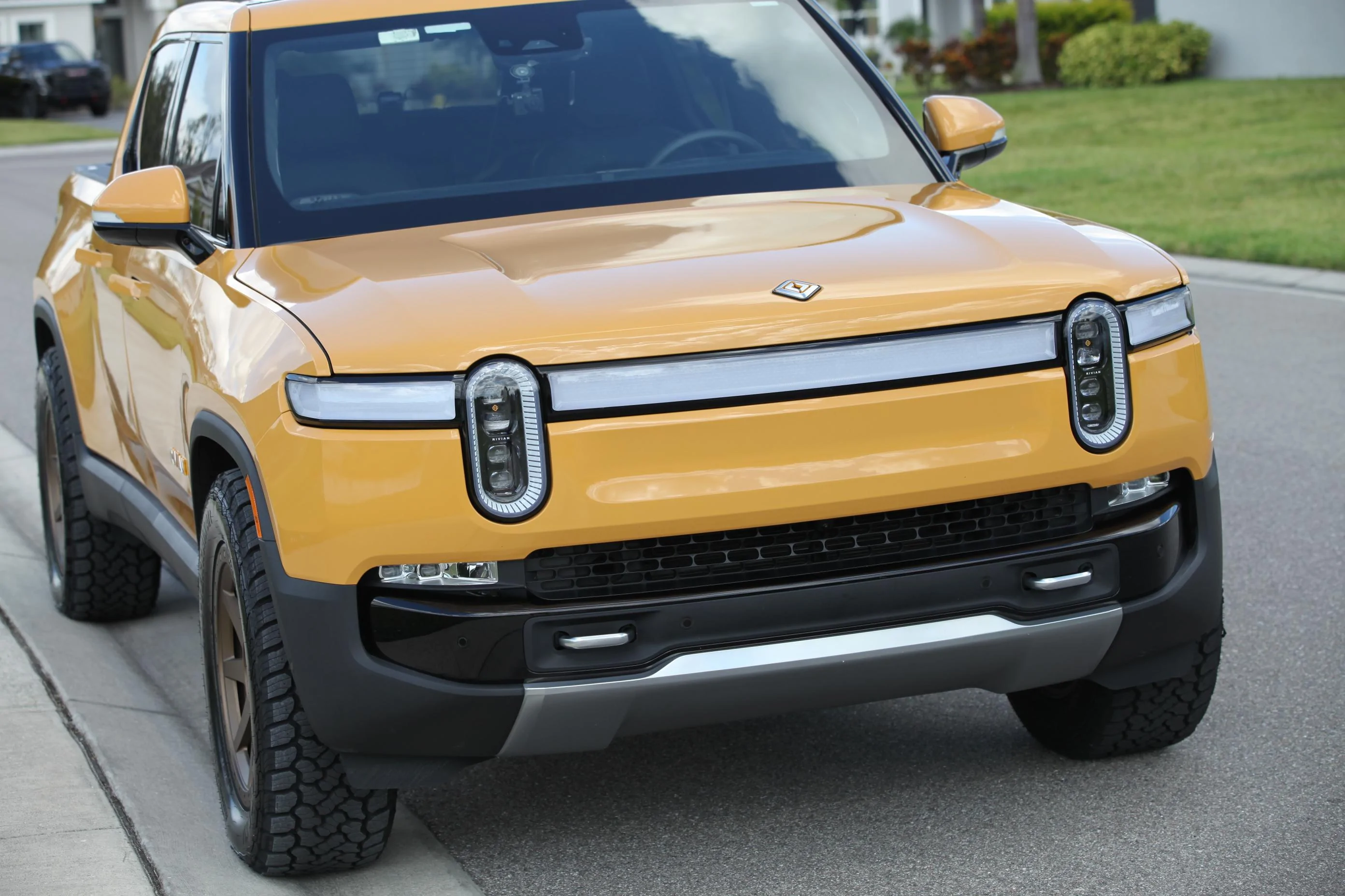

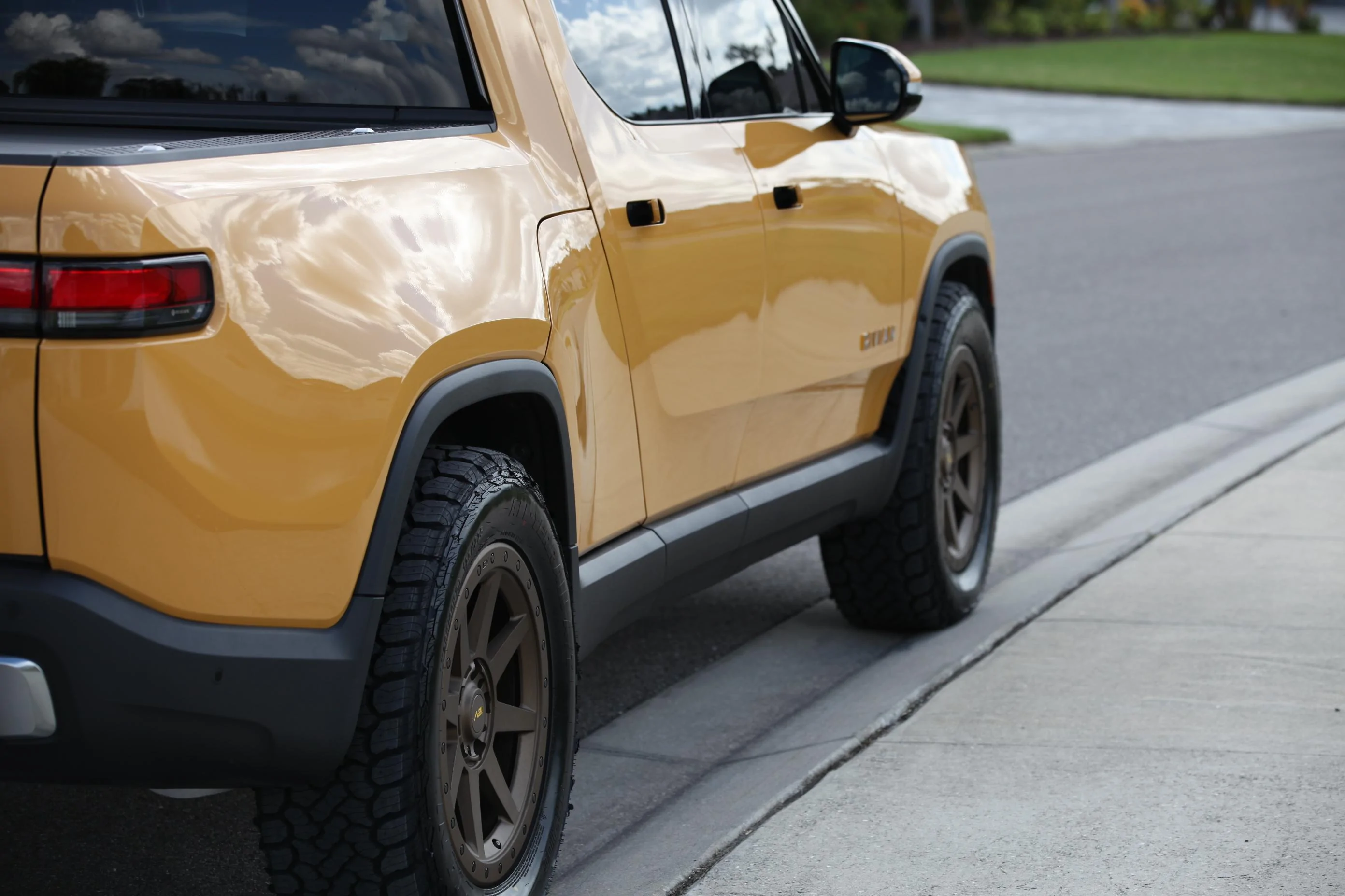

I also had the factory 21's with the Pirelli's. I now have a 20" wheel with a 285/60/20 Michelin Defender Platinums mounted. These are super smooth and super quiet, my efficiency dropped at least by 20%.
Rivian R1T R1S Aftermarket wheels efficiency IMG_9309
Rivian R1T R1S Aftermarket wheels efficiency IMG_9308
charlie_780
Dec 5, 2023
Zoo keeper
nice! what wheels are those? side view photos pls? clean.

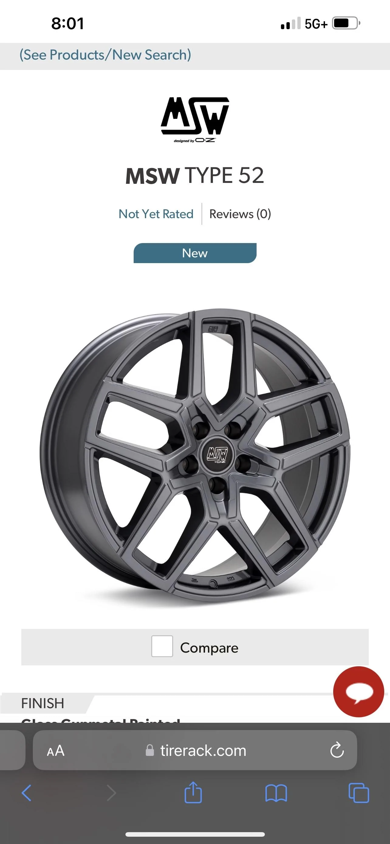

Thanks for the input…since starting the thread I have found a great 20” rim option with the +48 offset. MSW type 52 wheels look very similar to the stock Rivian 20” and have the correct offset.

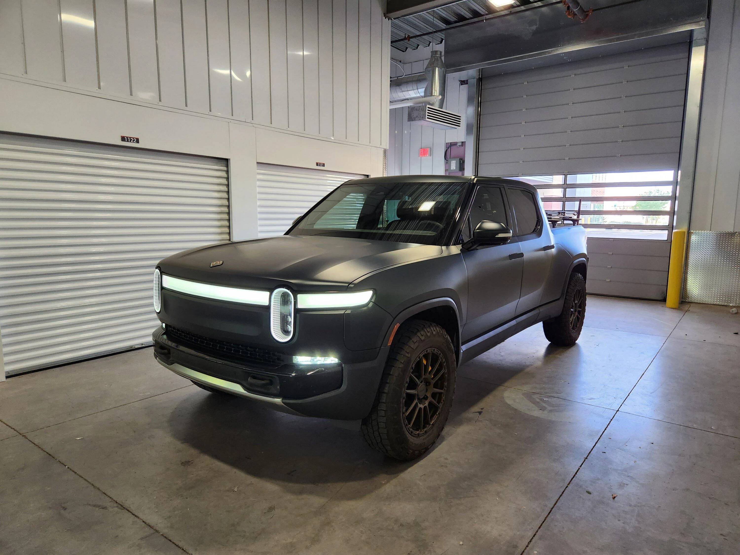

This is my set-up, which is a custom built wheel with the correct off-set but in 9" width. I run the Cooper Discoverer AT3's (Load Range E), and just finished an 1100 mile road trip (85% highway) . I ran at 75psi (rated 80psi) and ride was no different then at 65psi and range loss was zero over OEM's 20's with Pirellis.
If people want to retain a true A/T tire, then go with a Load Range E, so you can run the higher tire pressure. I have 30,000 miles on these tires now. Side benefit, the Coopers eliminated 100% of steering wheel wobble over the Scorpions.
