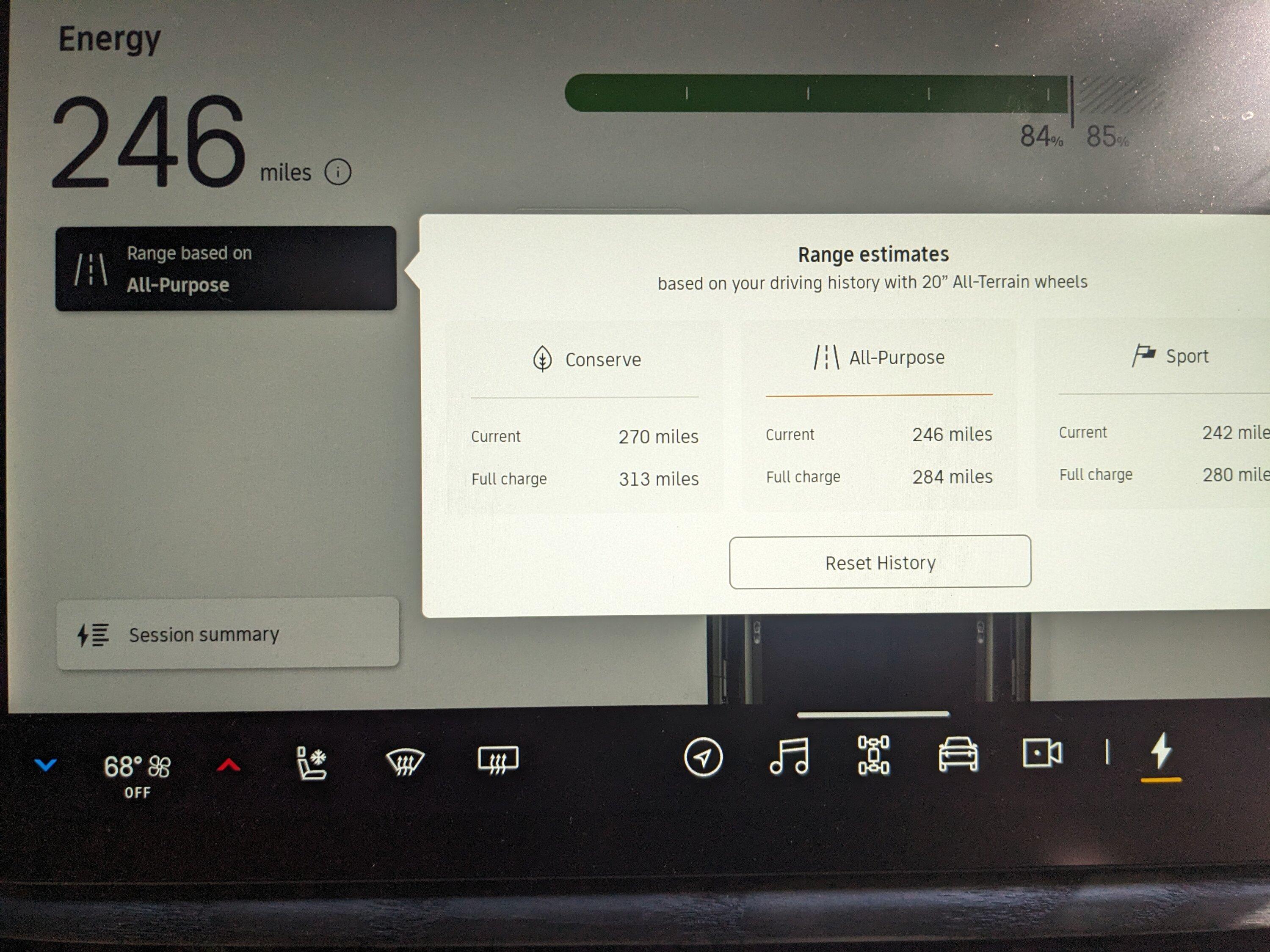

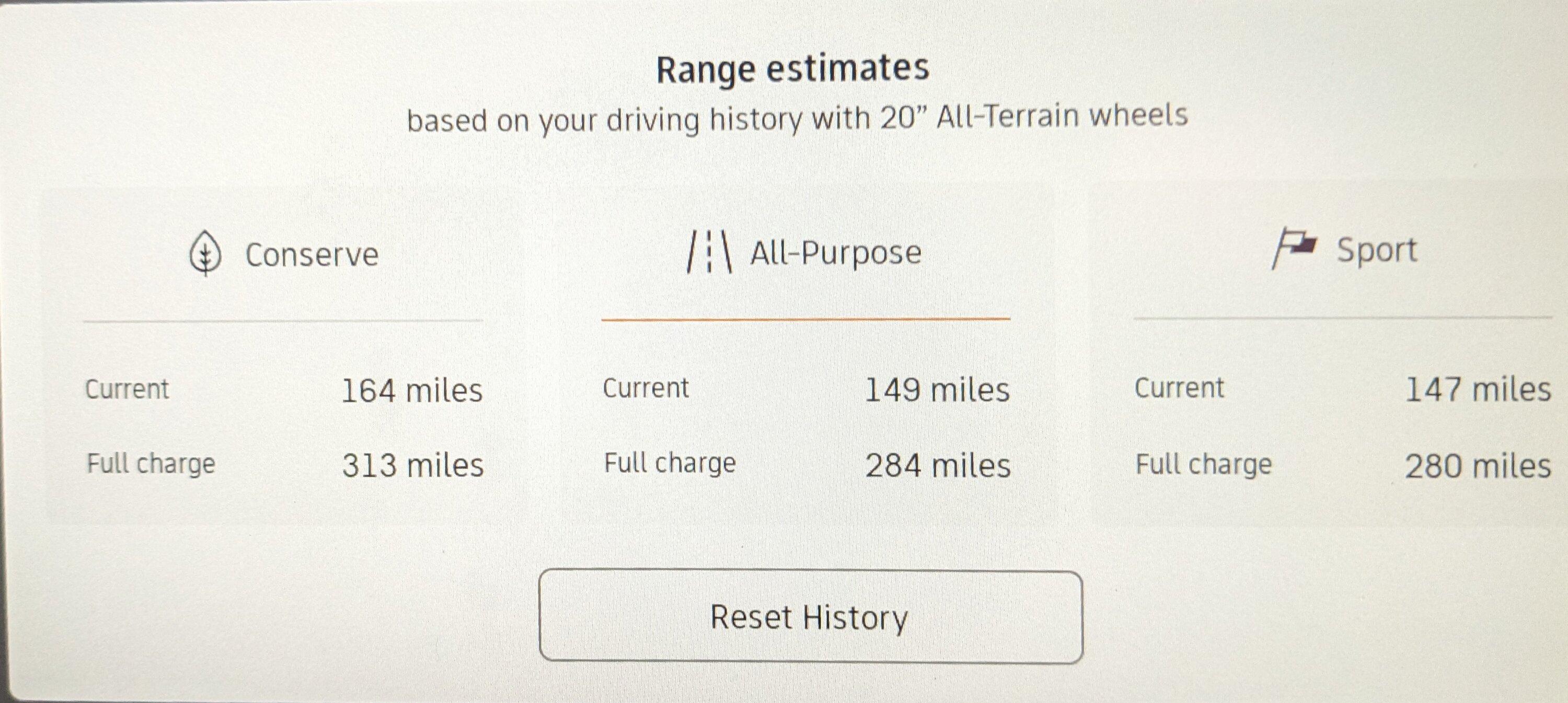

I don't think 20" AS gets the same as 21", but 275/60/20 AT will definitely reduce. I was getting ~300 miles in all purpose with my OEM 20" ATs in spring/summer (5.5% more [*INDIVIDUAL BASELINES ARE IMPORTANT WHEN TALKING ABOUT RANGE IMPROVEMENTS*]), I'm currently at ~315 miles with 20" AS in summer (5% increase).

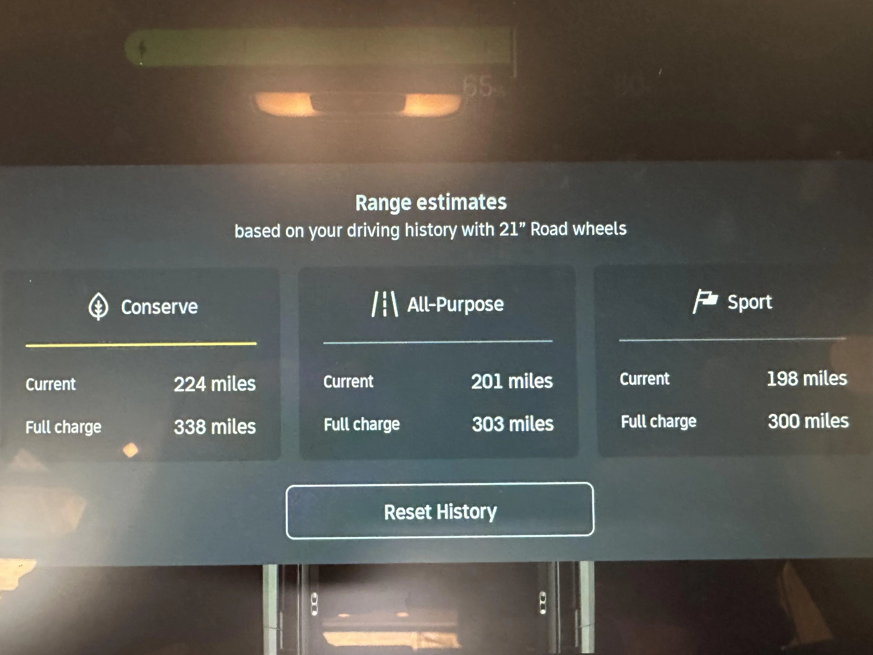

What is your stated all purpose range with 21", 324 miles? And your actual all purpose average efficiency?
definitely will see loss of range. Prob 10%? But I’m running 115T tires so air pressure is lower, around 42-45. But it rides a lot better w 20s and lower psi.
That's really low. 115 load index doesn't matter, what's the stated max PSI? Are they LTs? Airing down on the roads = big drop.

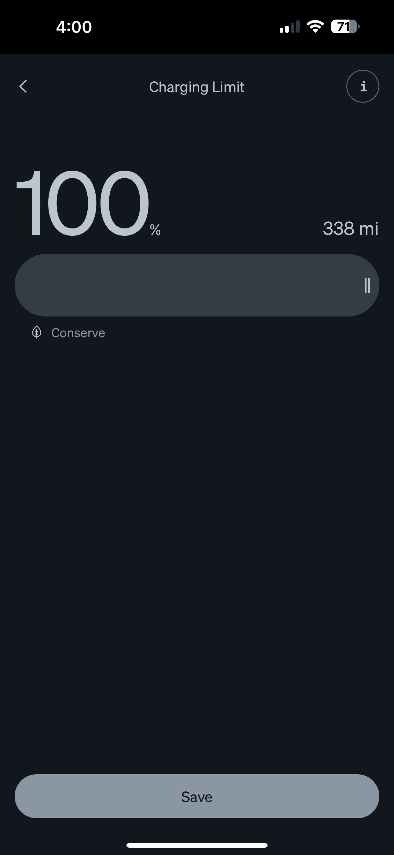

Actually 304 and 338
Wow, I thought 21" all purpose was higher. I was already getting about that with my ATs, and AS are definitely better. What's real world 21" consumption look like?

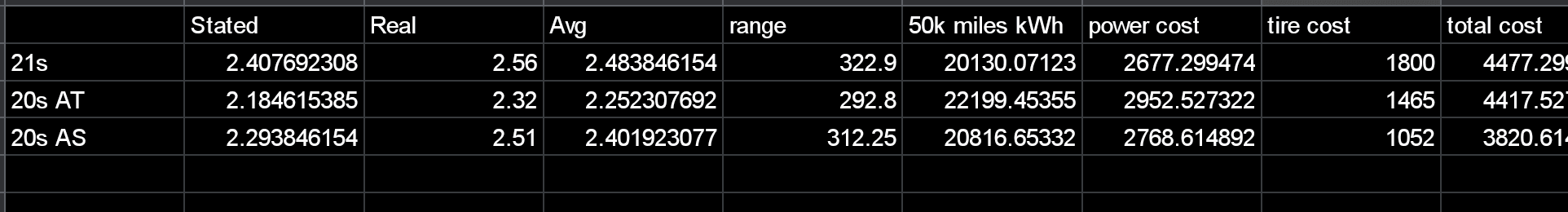

No matter how you slice it, it's cheaper to do aftermarket setups. OEM tires are stupid expensive. Even compared to more affordable 20" AT, 21" overall is more expensive for us averaging 90% home charging at $.11 and 10% travel charging at $.35 for a $.135 average rate. Obviously the more you pay for power, the closer the costs get.
My very rough excel is attached if anyone wants to update and play ??
Rivian R1T R1S Affordable Winter Wheels Setup: Ram 2363 Screenshot_20230908-150403~3

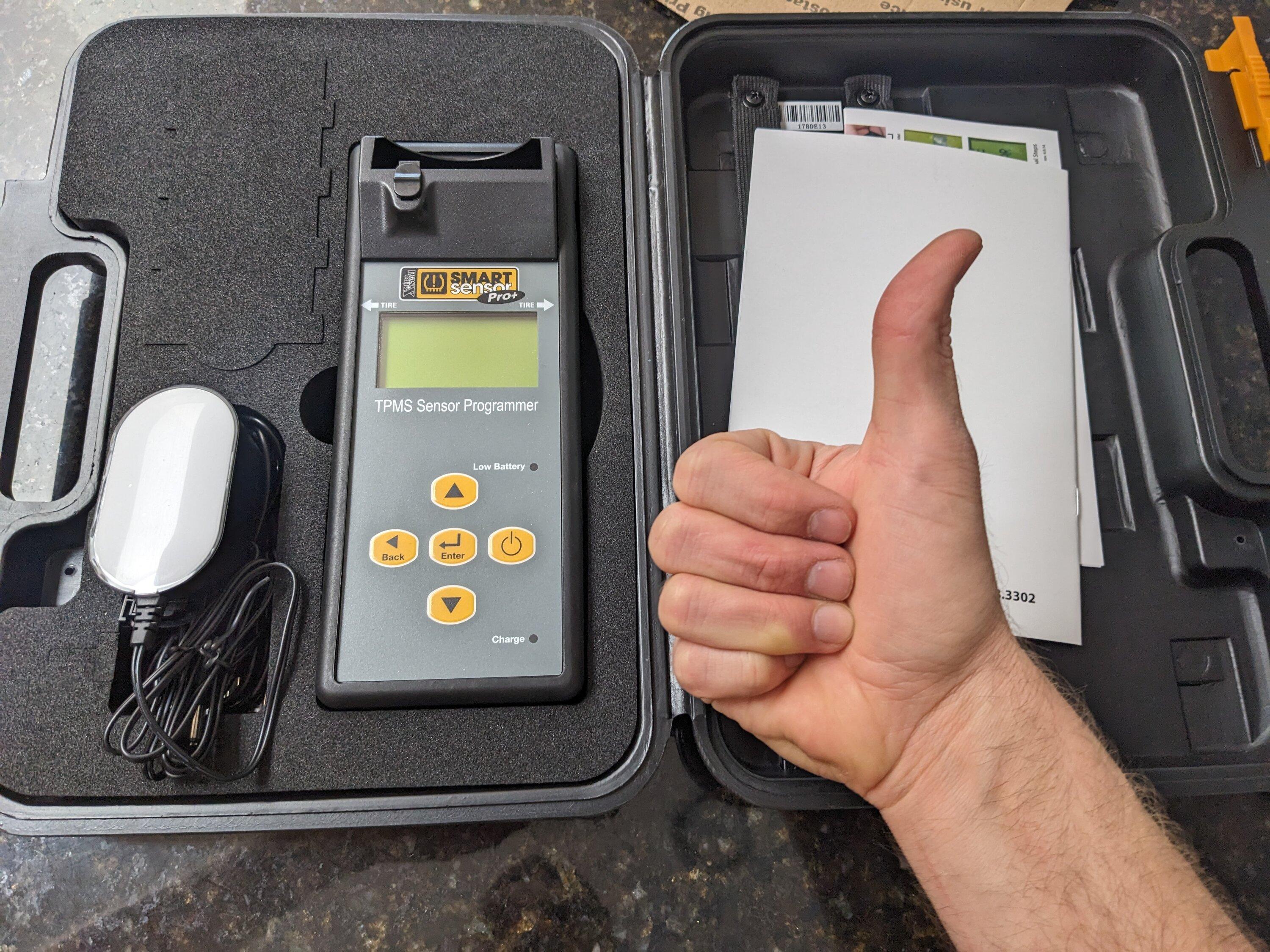

I got the Smart Sensor Pro+ TPMS sensor programmer! It was incredibly easy to use. Like others have said, I spent most of my time with it updating the programmer and about 5 minutes pulling out my wheels, cloning, and putting away.
I plan on keeping it for at least a year, so if anyone needs it, PM me and we can arrange pickup or shipping. It fits in a small flat rate box, so round-trip shipping is $20.
Rivian R1T R1S Affordable Winter Wheels Setup: Ram 2363 PXL_20230910_204650750

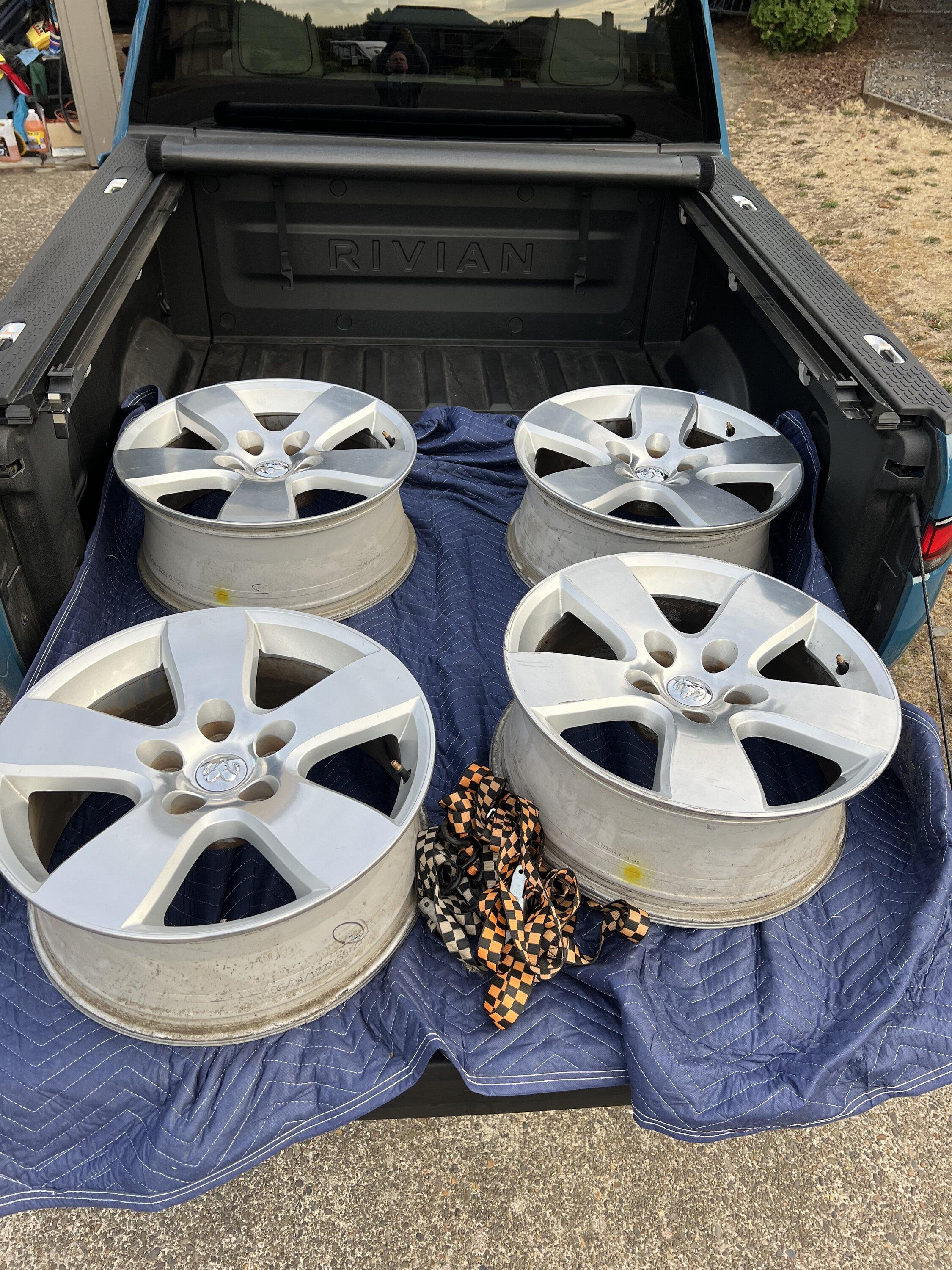

Well, you guys have inspired me. Thanks to all the collaboration and knowledge everybody has researched and shared on this thread. Last winter on 22ā€ pirellis was, fun. Lol
Got a full set in good shape for dirt cheap. Took a little while before a set popped up here in PDX, waited a bit and got all four for less than the cost of a single Wildpeak tire, so onward I go!
Rivian R1T R1S Affordable Winter Wheels Setup: Ram 2363 IMG_0807
