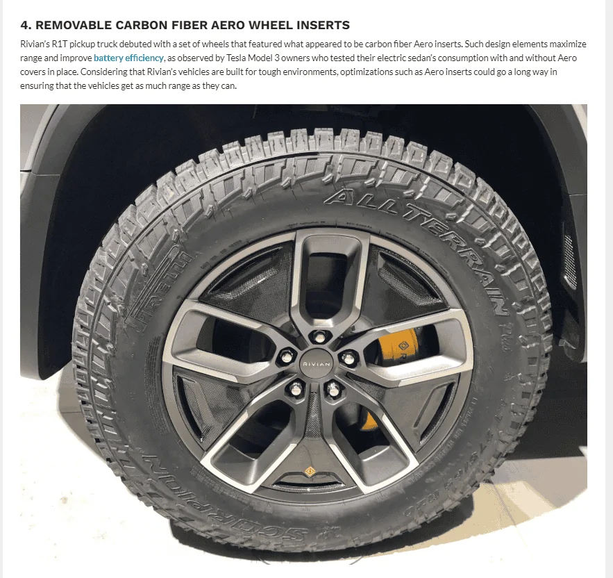

rivian themselves must’ve determined aero inserts weren’t worthwhile with the all terrain wheels/ tires - that‘s all I was saying. ?‍♂
here‘s the inerts on the show prototype.
Rivian R1T R1S Aero Wheel Covers/Inserts for 22" Wheels 1658688989998
Fair enough, although it is pure speculation as to why they didn't include them in production. The ones in the image look like they have to be snapped in individually which looks like a pain in the ass. That's a potential reason.
They killed a lot of features from the show prototypes, including my beloved power and 180 degree tailgate. Ultimately, the 20's may not see much benefit - to your point - but we can't know without data.
The point of this thread though was the 22's which I think could end up with a practical amount of benefit considering the benefit on the 21's.

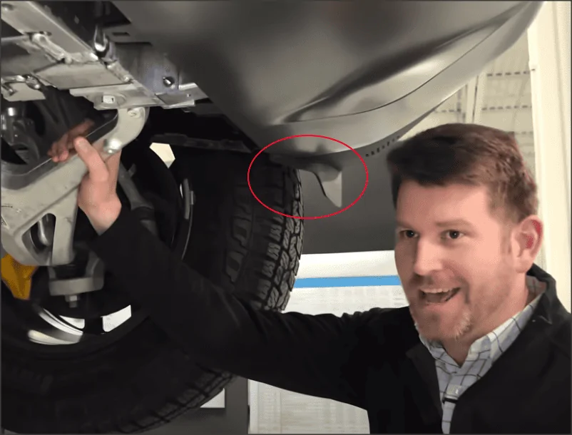

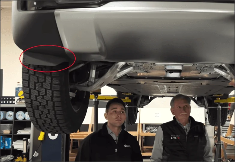

Spitballing again here- Verus have shown on other platforms that their front wheel deflectors have a measurable effect on reducing drag. Perhaps these, combined with a well designed aero cover could produce a more impactful increase in efficiency than covers alone.
Quoting Verus: "The goal of the front wheel deflectors is to reduce airflow hitting the front tires and making its way into the wheel well. By doing so, we are able to reduce drag and reduce the lift that is generated in this area of the vehicle's underbody."
Checking the Munro video of the R1T on the hoist, there are deflectors present from the factory, but they are rather small, presumably to maximize off-road approach angle and minimize impacts on rocks and stuff. But if on-road efficiency is the goal, which is clearly the case for most who are choosing the 21s and 22s and those who still want to run 20" ATs but maximize efficiency even marginally over stock, perhaps a larger front deflector could be proven to be effective?
Rivian R1T R1S Aero Wheel Covers/Inserts for 22" Wheels Snap 2022-07-25 at 09.36.34
Rivian R1T R1S Aero Wheel Covers/Inserts for 22" Wheels Snap 2022-07-25 at 09.37.40
The carbon inserts on that early prototype R1T with ATs could be a worthy product for the aftermarket if people are willing to pay a premium to maximize efficiency on the 20s (myself included). CFD validation testing is key here, and Verus has shown their prowess in this area with a full range of aero products for enthusiasts and entire packages that have succeeded in big time attack events with professional racers, most notably Ken Block's new Pikes Peak monster.
Once this platform gets a good 3D scan from a reputable company who are willing to prototype and validate aero parts, things will get a lot more interesting!
Excellent post and really great eye on the Sandy video. I am out of my depth here but my intuition tells me that the deflector would have to be larger and shaped in a very specific way to reduce drag, and not increase it.
This seems like a very doable 3D printing exercise.
