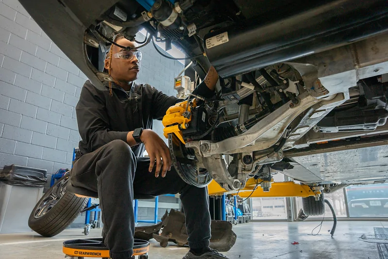

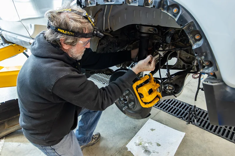

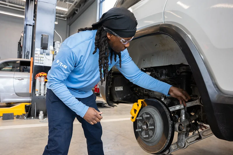

Our students at Heartland Community College are working on putting this R1S Rear Suspension back together. Students removed it, tore it down and are putting it back together. We currently have an R1S, R1T and a Skateboard we did (pulled body off a R1T).
We are finishing installing the Subframe back in tomorrow, pressurize the damper system up and then throw on alignment rack.
