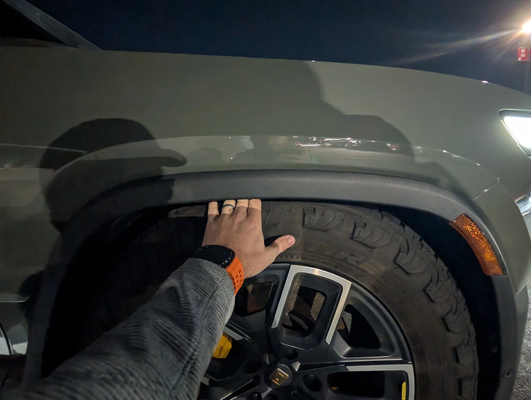

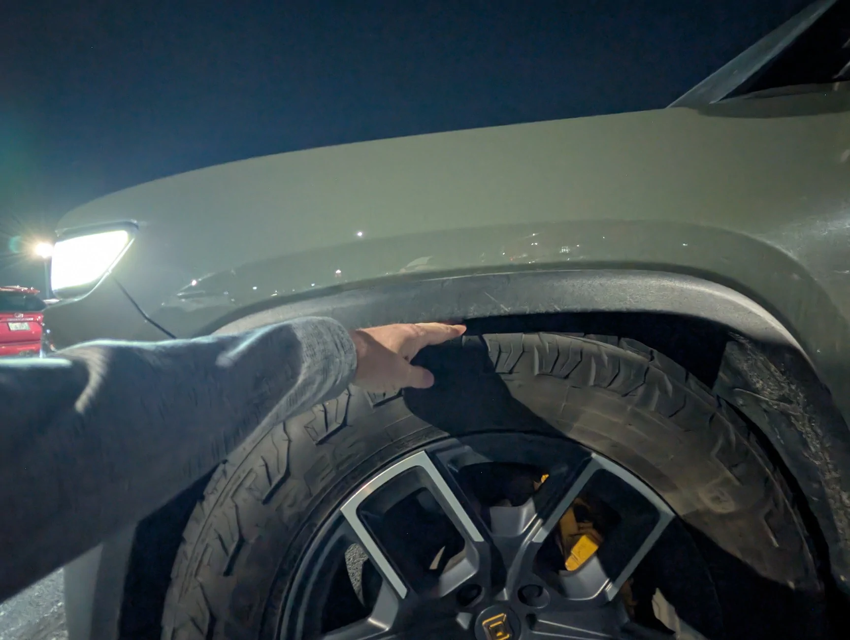

Hey all,
So I've noticed the last two times we have gone away for a week that when I come back the front suspension has dropped significantly. The first time was about 3 months ago and it was low enough the tires rubbed on the wheel wells when turning slightly.
We just got back from a week away on spring break and I remembered to check them before pulling away at the airport and they were so low I couldn't see the top of the tire or even get my hand between the tire and the wheel well (see pics). I did not drive it like this but rather hit to put the suspension in HIGH and then back to normal so it would correct. Ride was normal on the way home.

Is this typical for Rivians? My last truck was a 2019 Ram 1500 with an air suspension and it might slightly adjust a bit when getting in but never was visibly down. I asked Rivian to check it out about a month ago while it was in for a few other items and they said a damper on the front passenger side had a small but acceptable leak. I do not use kneel mode and keep it in standard height with auto low for highway speed is.
Worried it could possibly damage the wheel well or tires if I don't pay attention to manually adjusting the suspension after a trip...
Thanks for any info you all can provide.

No, not normal.

It’s the dampers, same thing happened to me, it will get worse.

Lie and say it’s gotten worse and drops in few days. Your SC is trying to procrastinate. Normal is no change in height after months of being parked. I didn’t even have to bring that up with Lake Forest CA SC. I told them it happens every time it’s parked for few days. They wrote up the replacement order without questioning. It would have been done if not for lack of inventory on RF damper. Going back next week.

No need to measure. Take before and after pictures. Roughly same camera position/distance, dead-on side profile. And add to your existing ticket. Noticeable visual difference between standard ride height and lowest (with tire fully tucked-in inside the well).
It's either a leak in the air spring or a valve in the damper (which would also affect ride quality). But, I think it's spring + damper as one unit, so they get replaced together.
