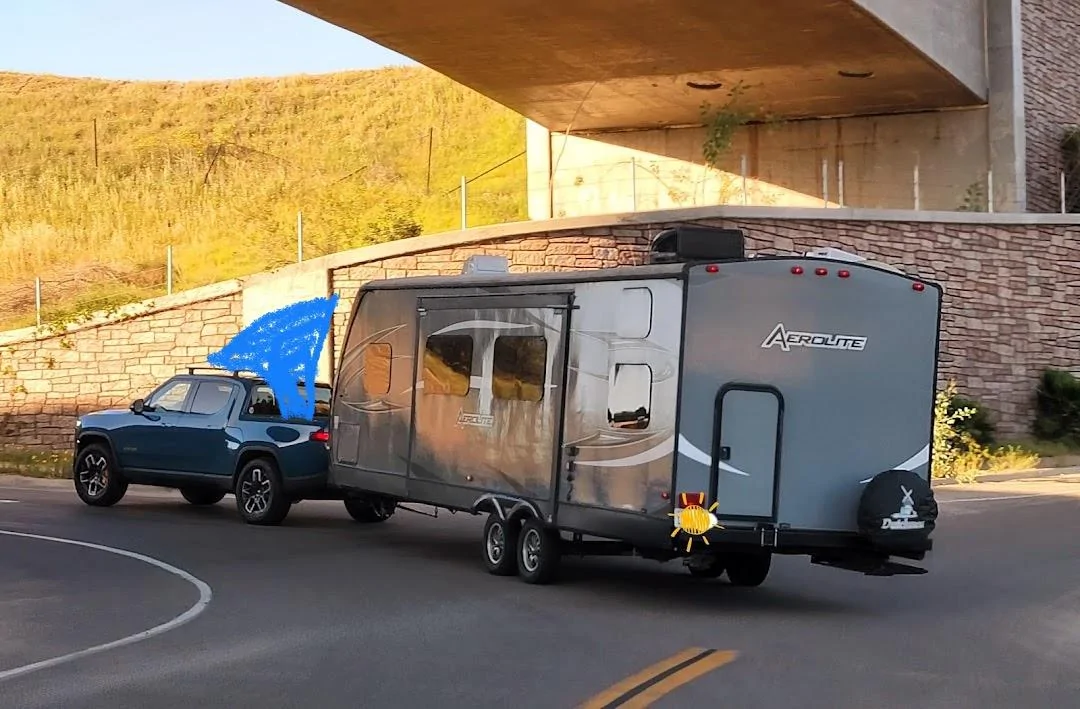

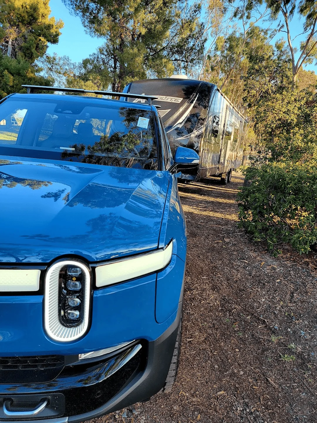

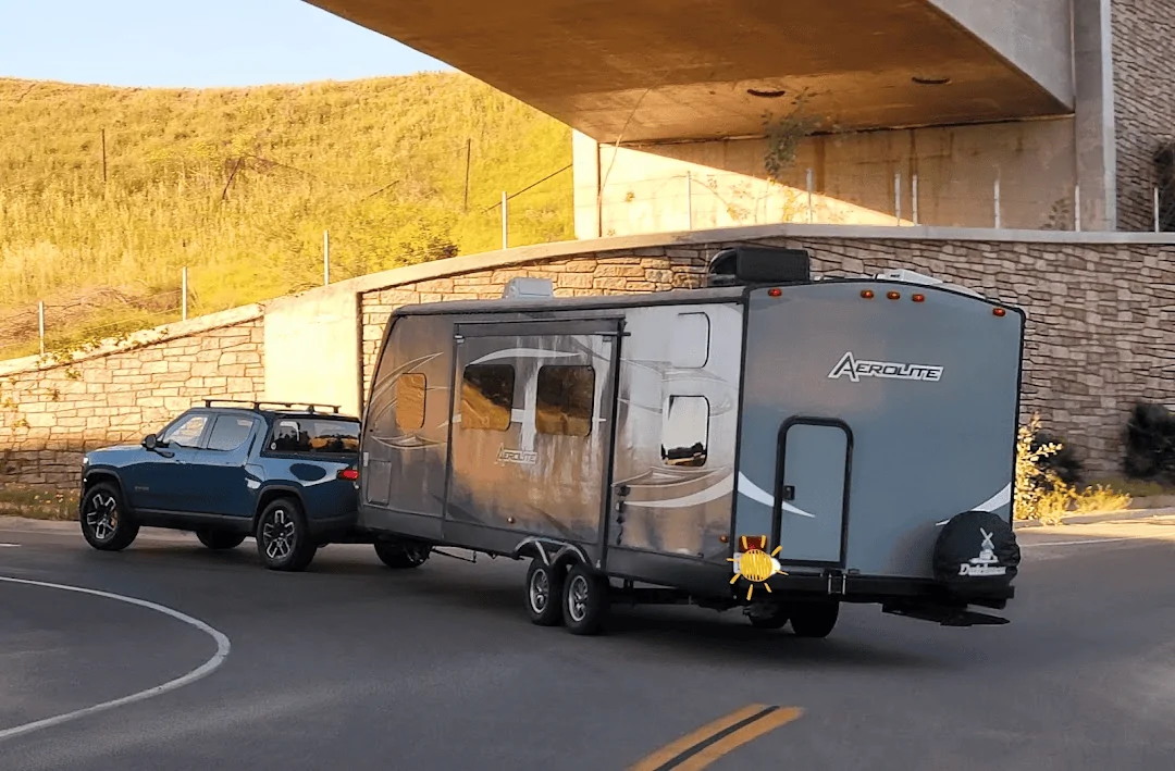

Towed my travel trailer this past weekend for a short 20 mile trip to a local campground in San Diego.
Towing was easy, hooked up no problem, auto leveled really well, and the trailer brakes worked no problem. Cruise control is not adaptive in tow mode, but I recommend using it as its pretty easy to speed even with a trailer attached. In California the speed limit is 55 with a trailer. I had trouble keeping it under 65 including onramps.
Got about 1.35 miles per kWh in bad traffic going there.
Got about 0.56 miles per kWh in no traffic driving normally.
Towing has a pretty substantial hit on the mileage.
Trailer is about 7000 pounds (guessing with everything in it) and is a 33" aluminum frame travel trailer.
Standard weight distribution setup, nothing fancy.

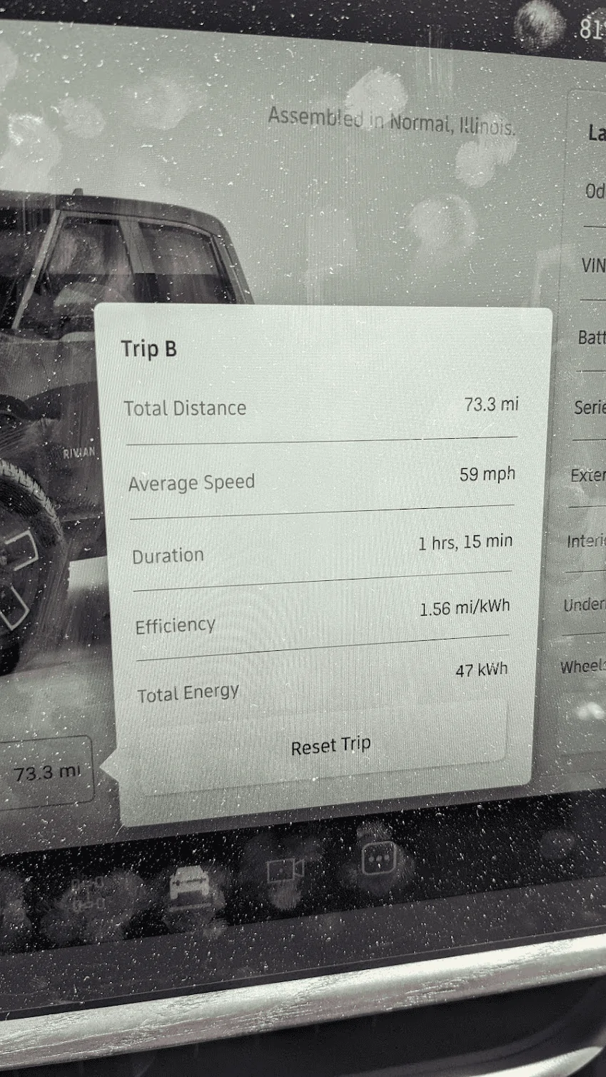

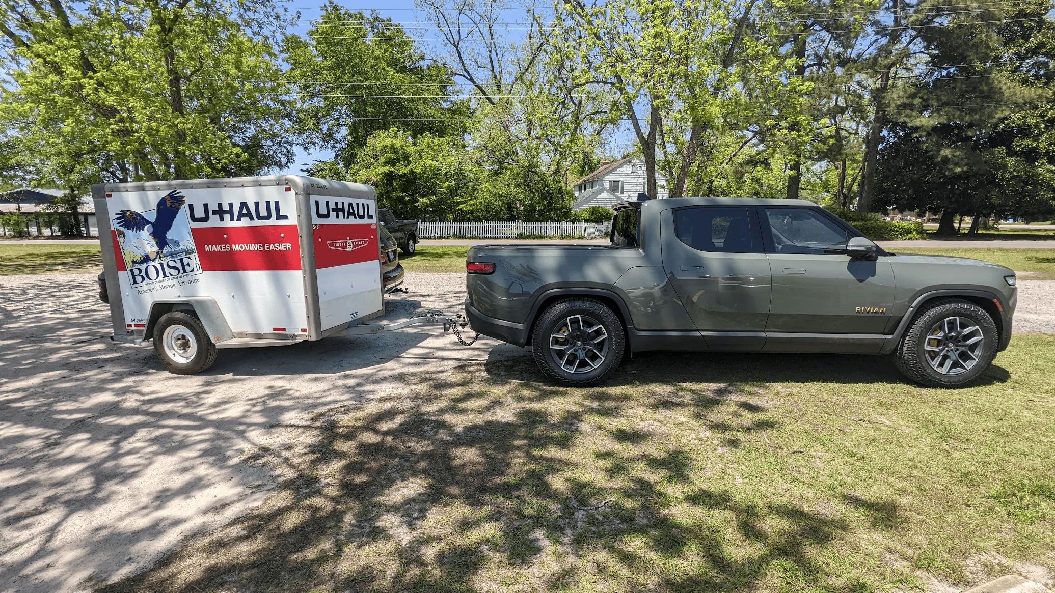

I towed a 5x8 uhaul with about 300 lbs of weight about 75 miles at 70 mph on Friday. Projected range was 200 miles, which I felt was pretty minimal hit.

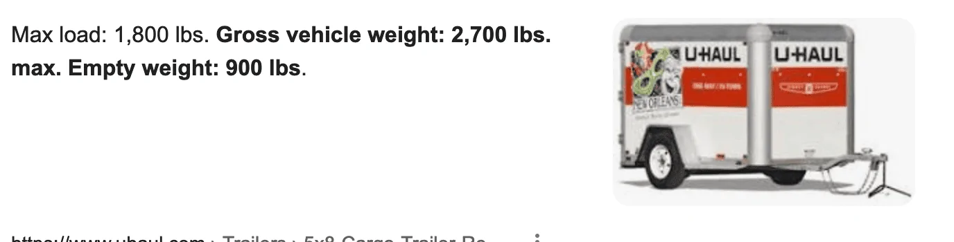

Thanks for posting this info. For reference, UHaul says this trailer is 900 lbs empty, so you appear to have been towing about 1200 lbs total weight.

Do you have the 20 AT? i cant be sure from the picture
If you ever do a stretch of highway where you set the cruise control to 50 mph, even just for 10-20 miles, id love to hear what efficiency you get towing that trailer!
