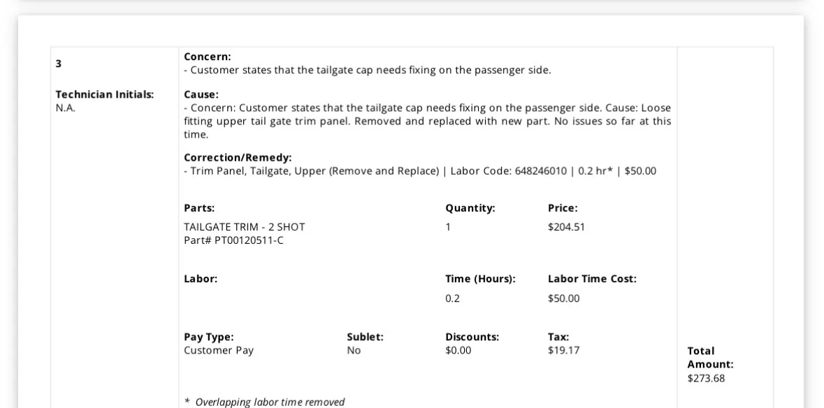

Out of warranty replacement cost for me was $273.68 last October.

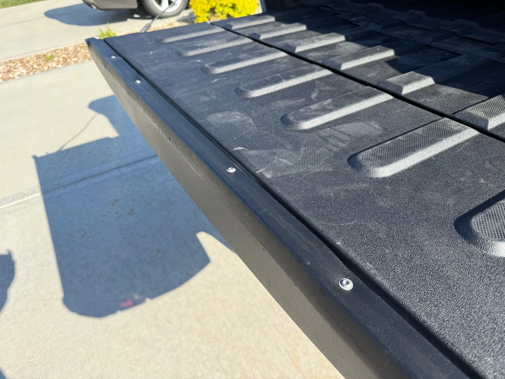

I had the loose trim piece also but I fixed it by taking off the trim piece, taking out the four bolts that hold down the back of the tailgate, drilling small pilot holes in the trim piece, then using those same four bolts to hold down both pieces instead of just one and now it doesn’t move at all.
