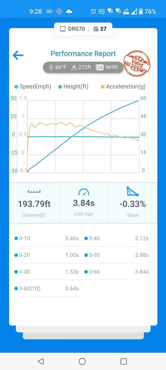

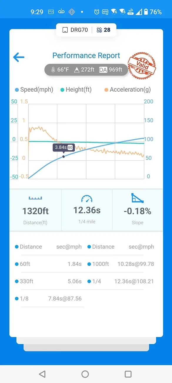

Got a very lightweight set of Atomic 20" wheels coming soon so needed some baseline data for comparison...
With the AT tires I was traction limited up to ~40MPH, then acceleration tapered off rapidly to around 60MPH, and then pretty consistent acceleration from there to maybe a second before the quarter mile mark when I hit the speed limiter.
Not bad at all for a 7,000lb truck, but also easy to see how more power would be more better!
SOC was in the 80%s, Sport mode of course, lowest & stiff suspension, stability/traction control 'reduced'.
Rivian R1T R1S A little 2023 R1T PDM AT Max 0-60 & 1/4 mile Dragy Fun Screenshot_20240802-092829_dragy
Rivian R1T R1S A little 2023 R1T PDM AT Max 0-60 & 1/4 mile Dragy Fun Screenshot_20240802-092923_dragy

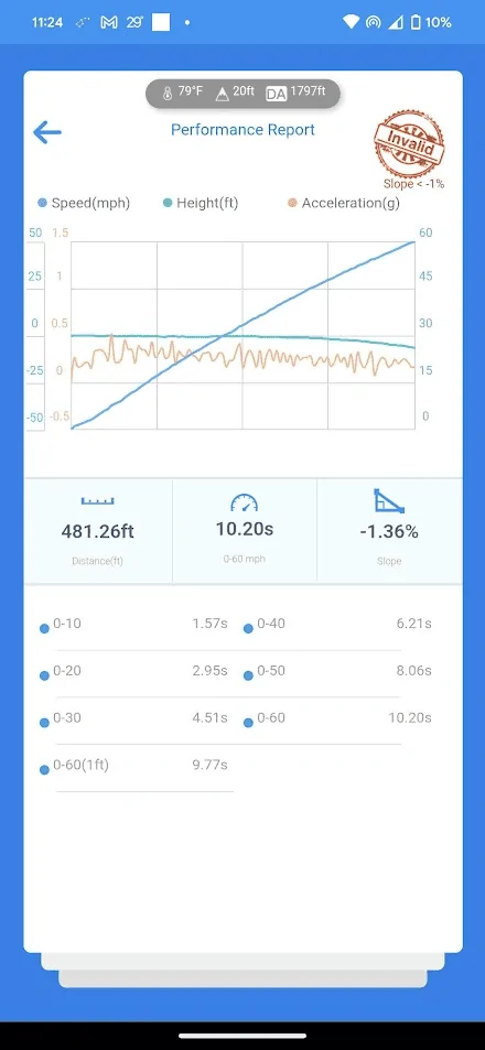

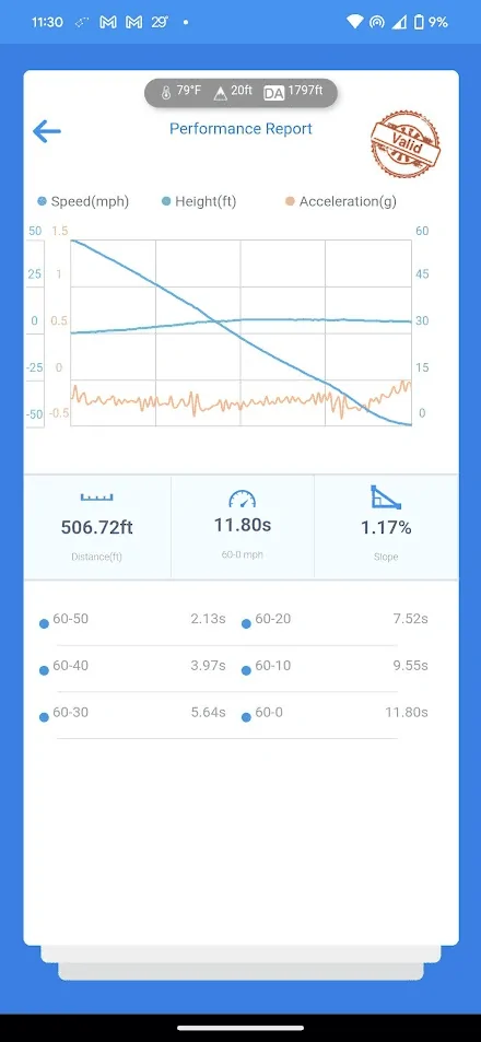

Better than I could do with my quad. What about your 60-0 though?
Rivian R1T R1S A little 2023 R1T PDM AT Max 0-60 & 1/4 mile Dragy Fun 1722620757722-fv
Rivian R1T R1S A little 2023 R1T PDM AT Max 0-60 & 1/4 mile Dragy Fun 1722620777943-aq
Rivian R1T R1S A little 2023 R1T PDM AT Max 0-60 & 1/4 mile Dragy Fun 1722620836905-t

What software are you using? Pretty cool data. When I completed my R1T test drive, I felt like an astronaut getting shot into the sky thinking I was pulling 6 gs. Only later, I was completely humbled and found out it was <1 g and gained a new respect for astronauts as well as racing drivers!!
The screen shot is from the Dragy app, which goes with the Dragy GPS based race timer, nifty little tool for stuff like this.

3.64 is faster than I expected for that config! I’m curious to see what difference the wheels make. I never retested mine after lightweight wheels (quad T) but I was at 3.03 seconds with the stock 21s.

Yeah the point here is apples to apples between the stock AT setup and switching to light forged rims, therefore it will indeed be exactly the same tires. 20" rims with all-season or even stickier tires in the 'smaller' OEM diameter setup would certainly perform better and kinda be interesting to see, but that's not what I'm testing.
