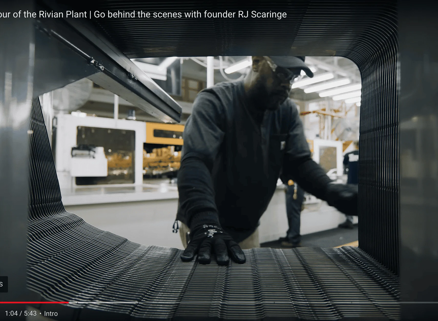

Stamping: Since the R2 is smaller, the existing stamping shop could in theory be retooled using the same machines. It would require new dies and motion control ("robotics") re-programming. Retooling is a normal operation in most stamping shops, so IMO it's just time to get dies made and prove it in. It's probably one of the easier processes to update for R2. But storage racks would need to be new. In the third picture below, this is probably an R1T side panel. Note how the rack is design to hold R1T panels with a support through the tunnel. That does not exist on the R2S, and R2S panels are smaller than R1S. So new racks would be needed. But in turn, that ALSO affects the robotic operations on the body shop weld line - storage racks are different, panel sizes are different..... so what has to be reworked on the existing body shop weld line?

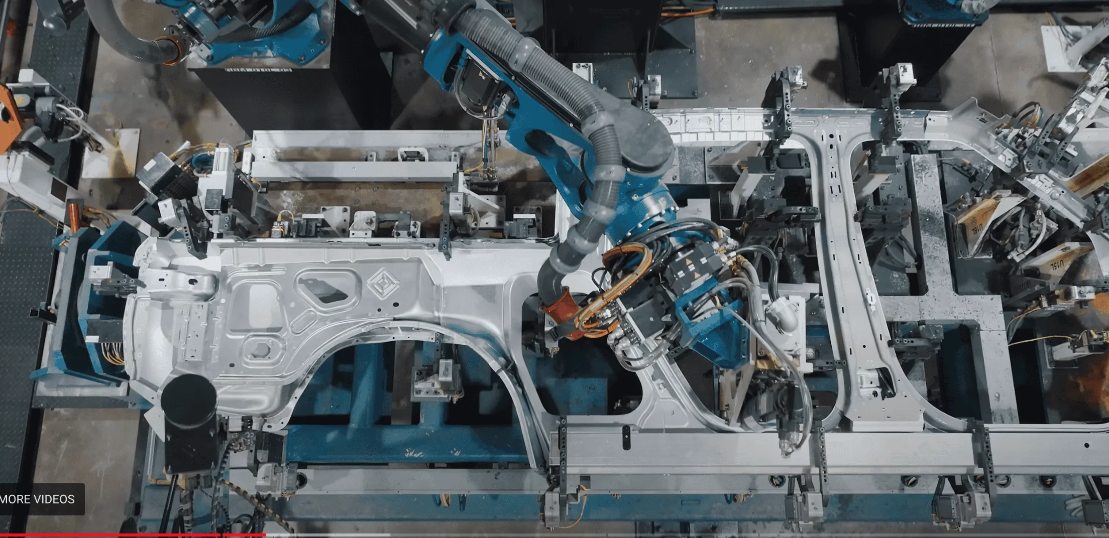

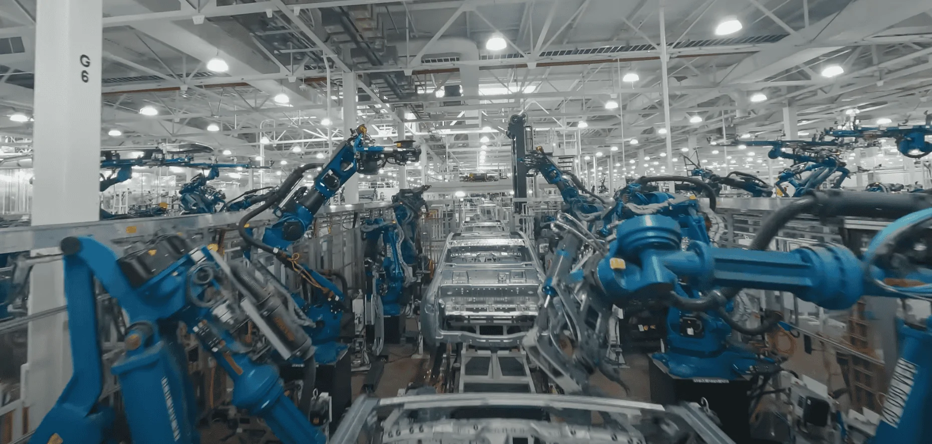

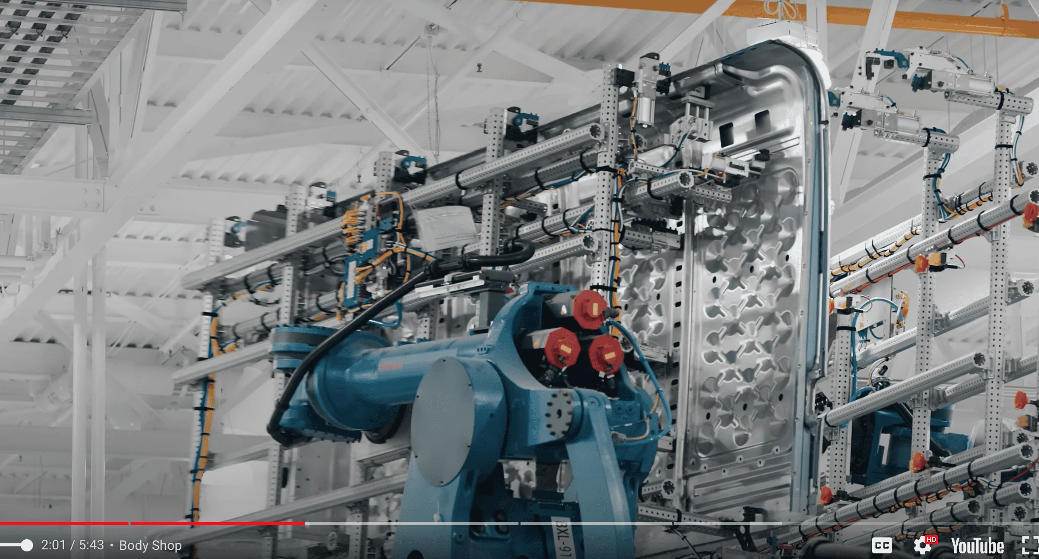

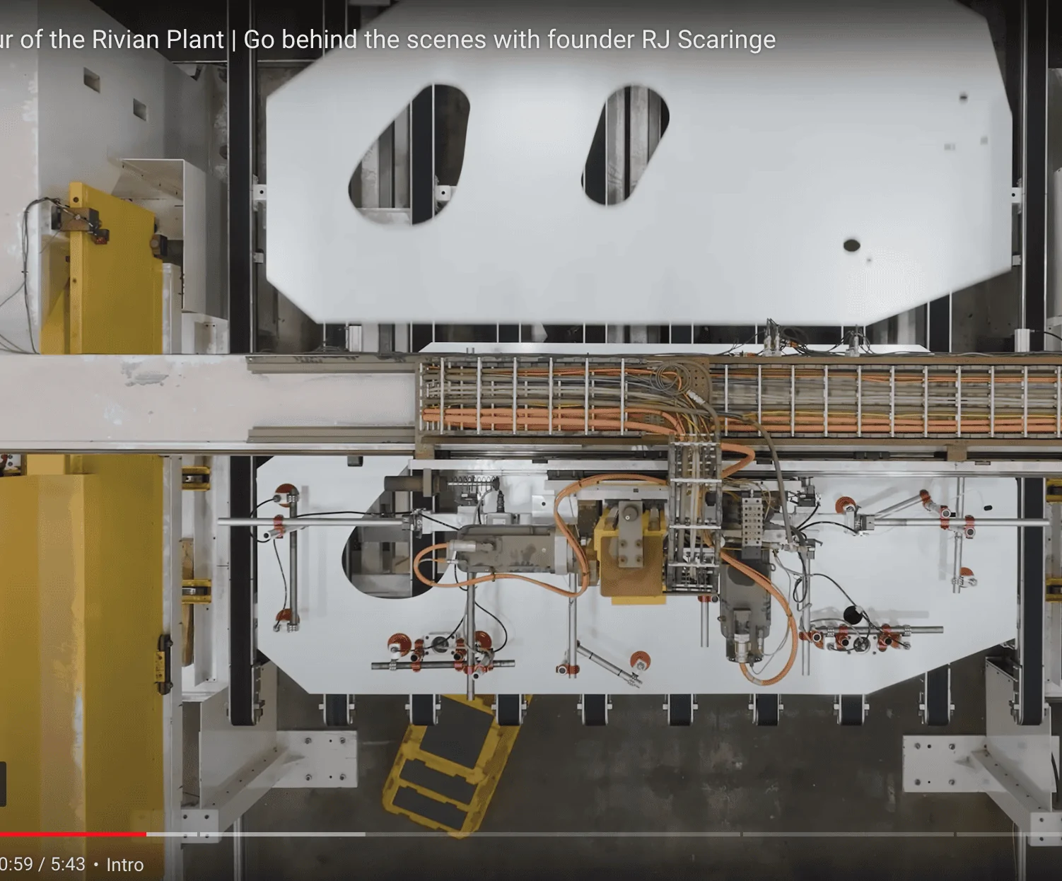

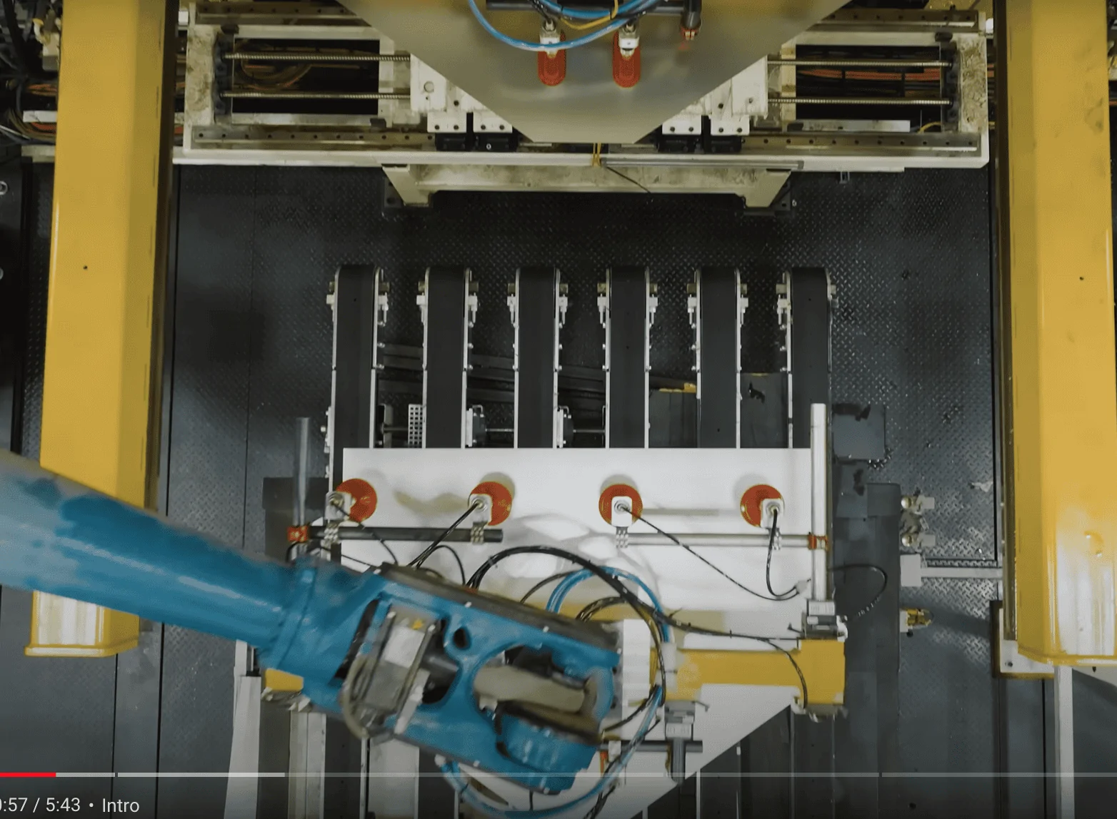

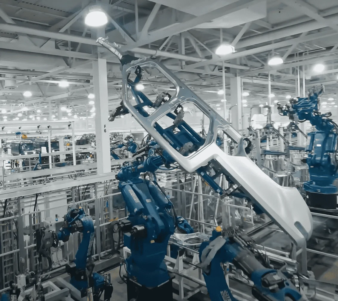

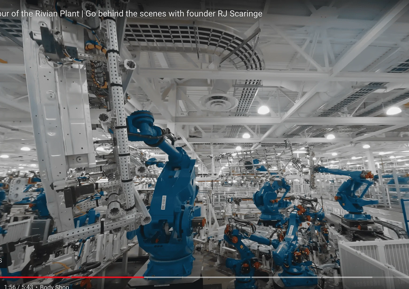

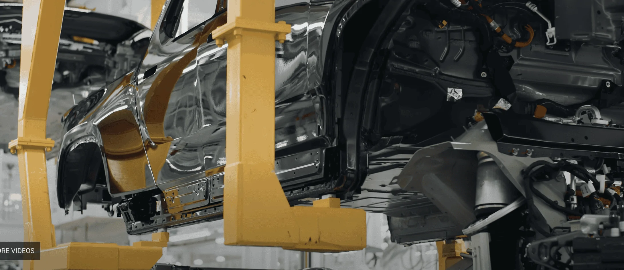

Body Assembly Shop:
Look at the size of the R1 panels and the robots, and how closely the robots are spaced together. In the second picture, note the number of jig fixture attachment points. All that is specific to the R1. This all needs to be redesigned for the R2, and THEN figure out how to make it a flexible changeover process between R1 and R2 builds, if you built both on the same line.

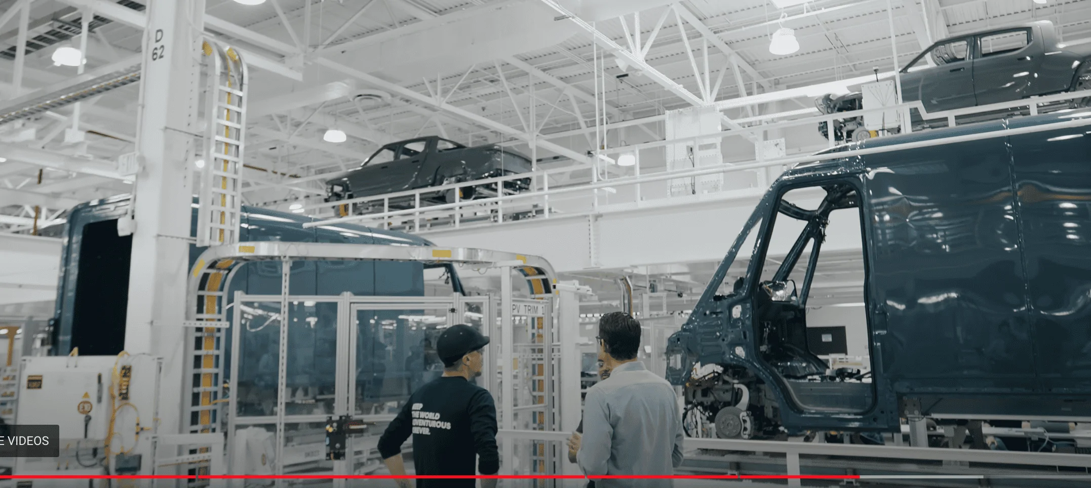

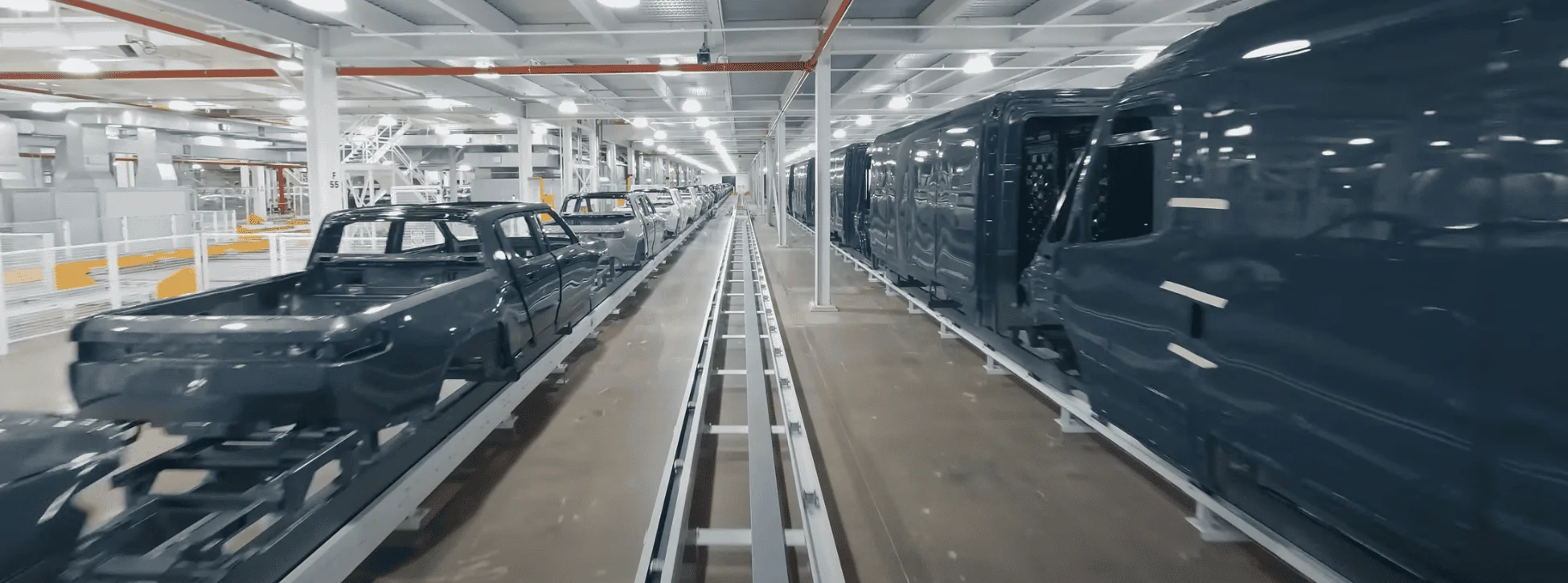

Now look at the EDV body shop. These panels and robots are MUCH larger and it looks to me like this is a fixed work cell process, not a continuous moving assembly line process. RJ comments that they look like dinosaurs. There's just no way EDV could be built on the R1 line.

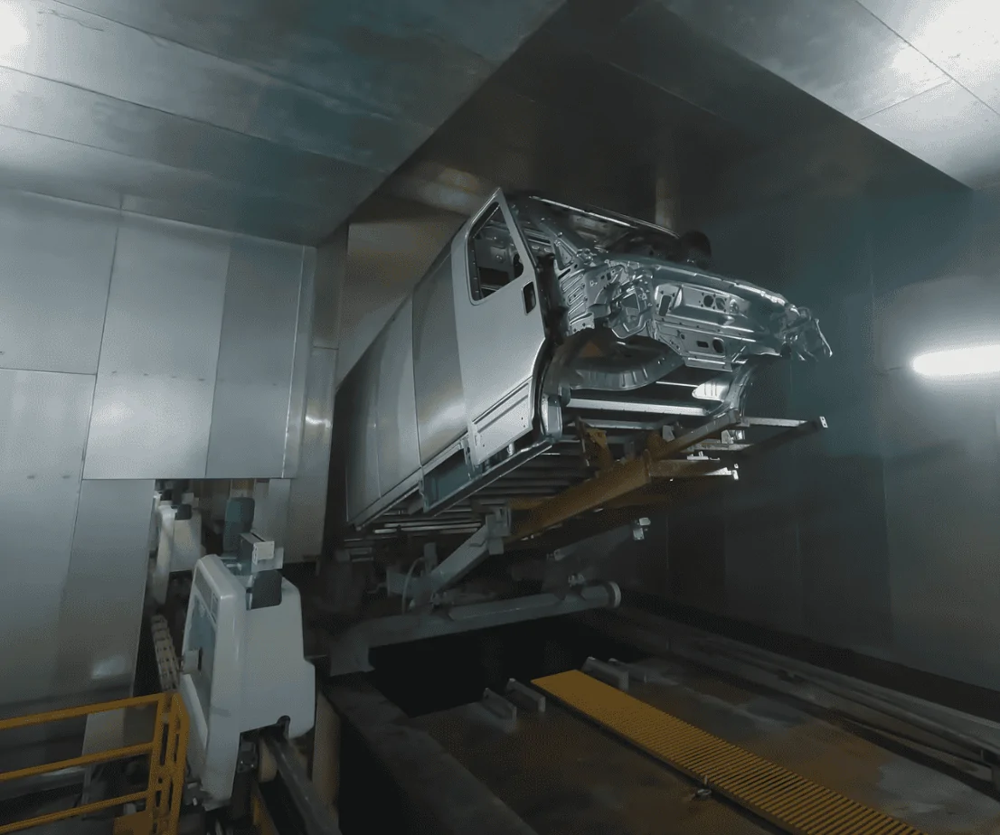

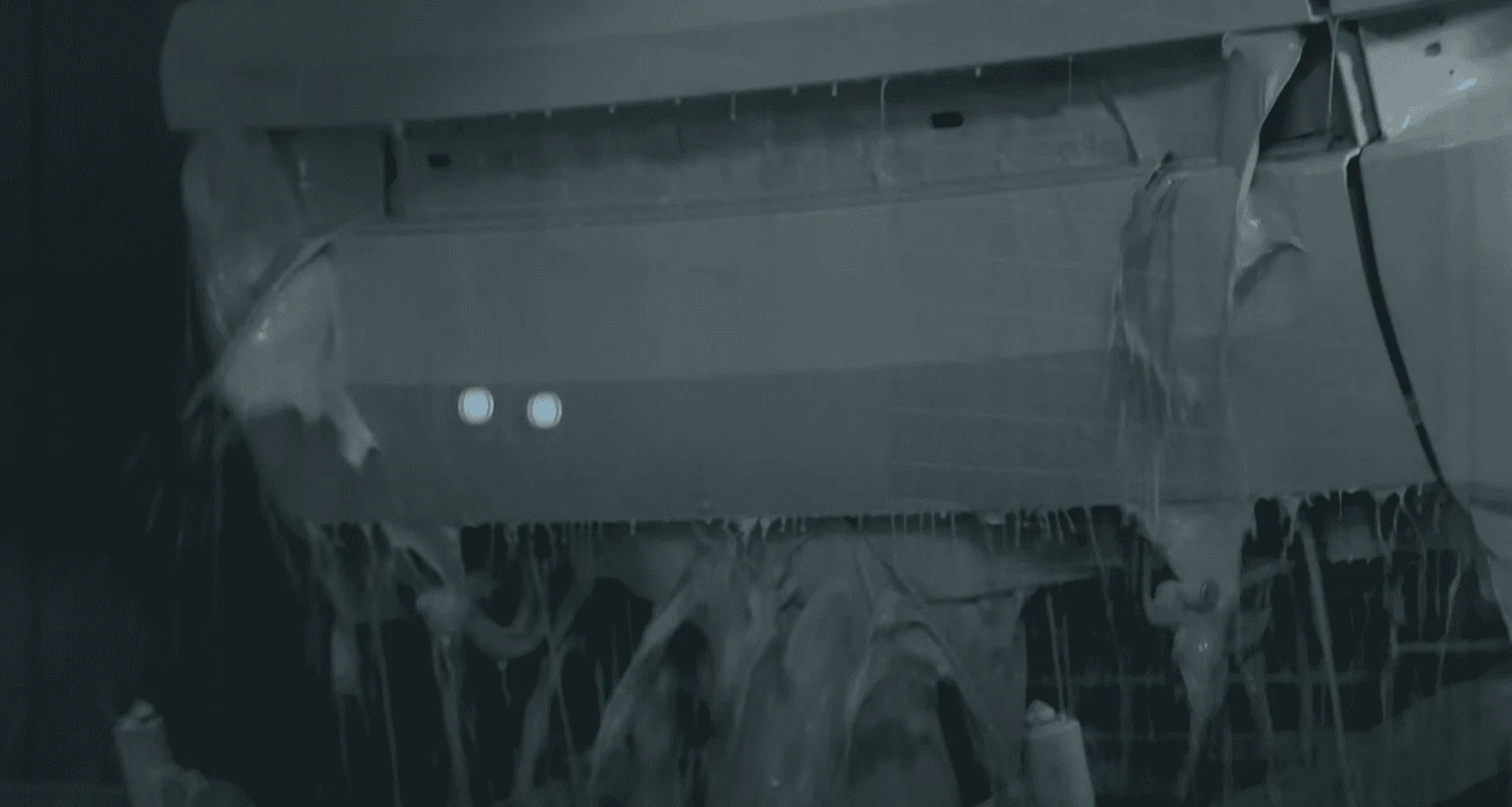

Paint Shop:
RJ says in the video that the paint shop already processes the R1 and EDV, and also does the skateboard electrostatic protection coating. The paint shop could be reprogrammed fairly easily to add the R2. The problem is it probably is a production bottleneck, so factory throughput of all products would likely be constrained by this work cell. In the third and several other pictures, notice the jigs that the R1T sits on during various processes. This jig (Rivian calls it the "R1 Skillet Skid" in final assembly) is designed to the R1 vehicle, so an inventory of hundreds of new R2 jigs and skillet skids will be needed. And again, every workcell may need upgrades, updates, modifications, programming due to the different size of the jig/skid.

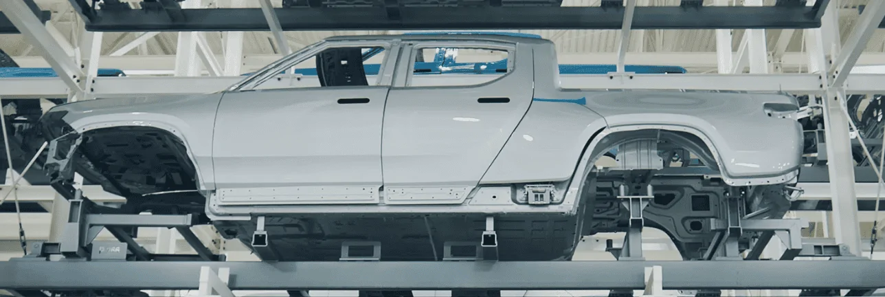

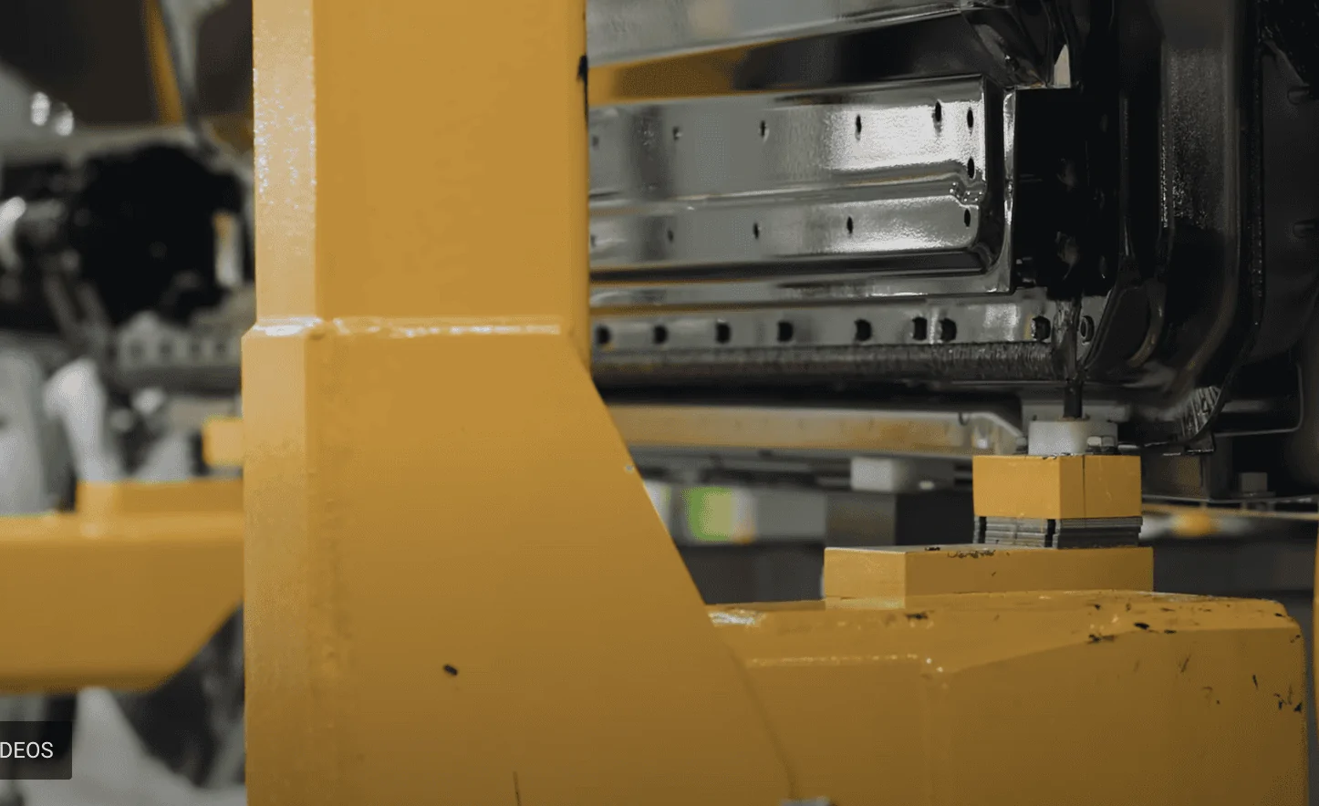

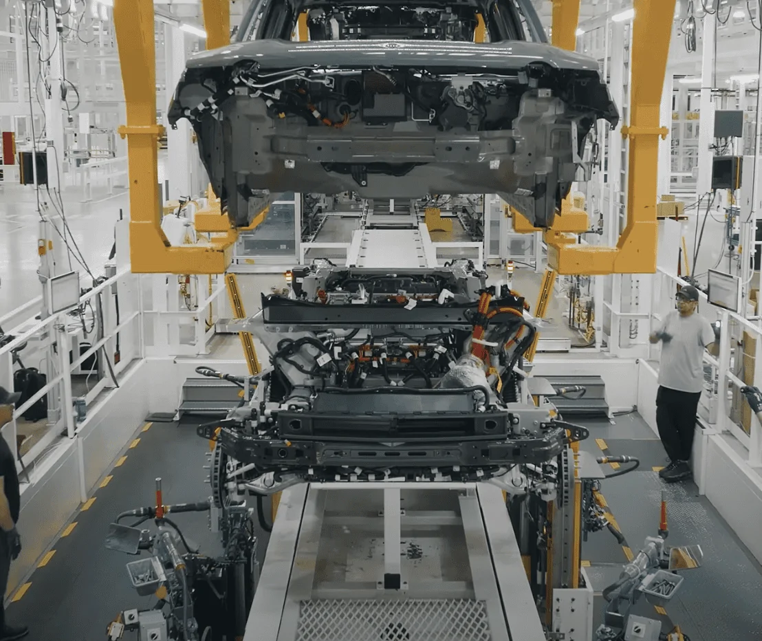

General Assembly

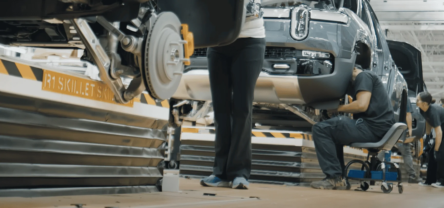

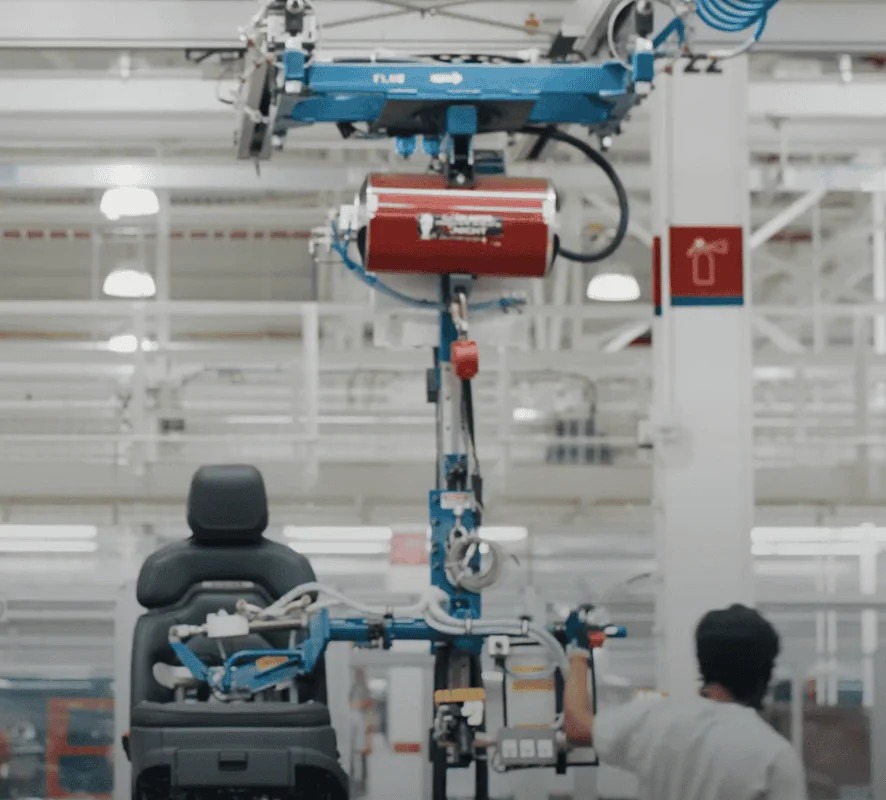

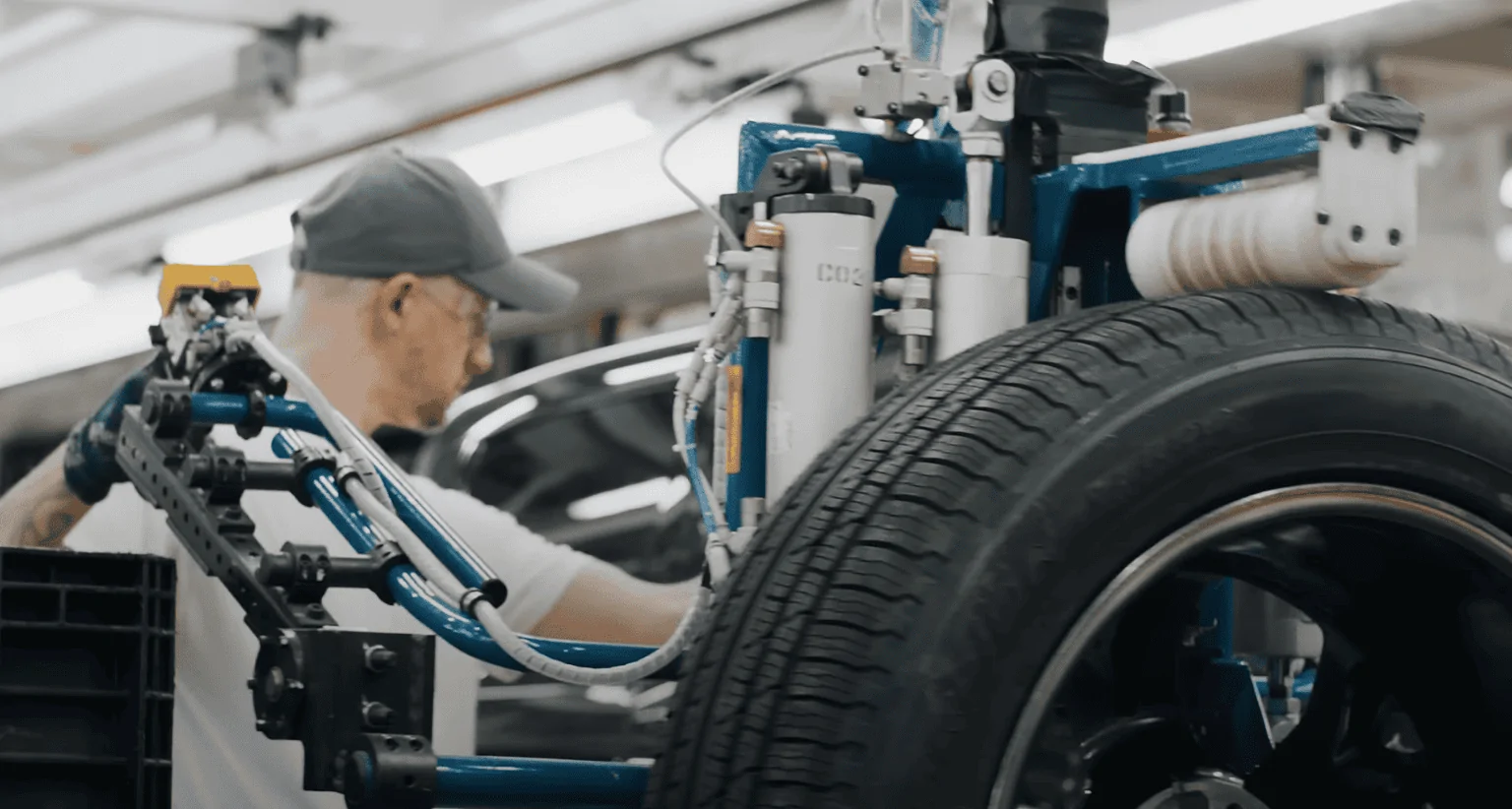

Notice in the following pictures how all of the jigs are made to R1 dimensions. What would it take to retool and reprogram everything you see in these pictures to adjust for dimensional differences of R2 or EDV on the same line?
Rivian R1T R1S A "Play by Play Illustrated Commentary" why R2 production would be challenging to retrofit into existing R1 or EDV line 1710089702654
Rivian R1T R1S A "Play by Play Illustrated Commentary" why R2 production would be challenging to retrofit into existing R1 or EDV line 1710089722533
Rivian R1T R1S A "Play by Play Illustrated Commentary" why R2 production would be challenging to retrofit into existing R1 or EDV line 1710089737386
Rivian R1T R1S A "Play by Play Illustrated Commentary" why R2 production would be challenging to retrofit into existing R1 or EDV line 1710089748551
Rivian R1T R1S A "Play by Play Illustrated Commentary" why R2 production would be challenging to retrofit into existing R1 or EDV line 1710089763217
Rivian R1T R1S A "Play by Play Illustrated Commentary" why R2 production would be challenging to retrofit into existing R1 or EDV line 1710089797696
Rivian R1T R1S A "Play by Play Illustrated Commentary" why R2 production would be challenging to retrofit into existing R1 or EDV line 1710089776265
Body Assembly Shop:
Paint Shop:
General Assembly

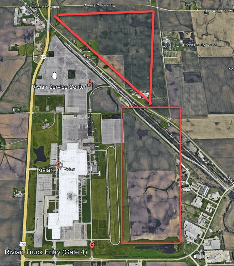

There more than likely is enough space to put in machinery, robots, stamping, paint, electricaletc. I am like you, not an expert in automotive production but knowing a little about production, I can see something like that happening.....at least for the initial run of R2S. They could then continue building the plant in Georgia and eventually populate it with machinery or just shut down for a month and move the equipment there...might be more of a Cost.

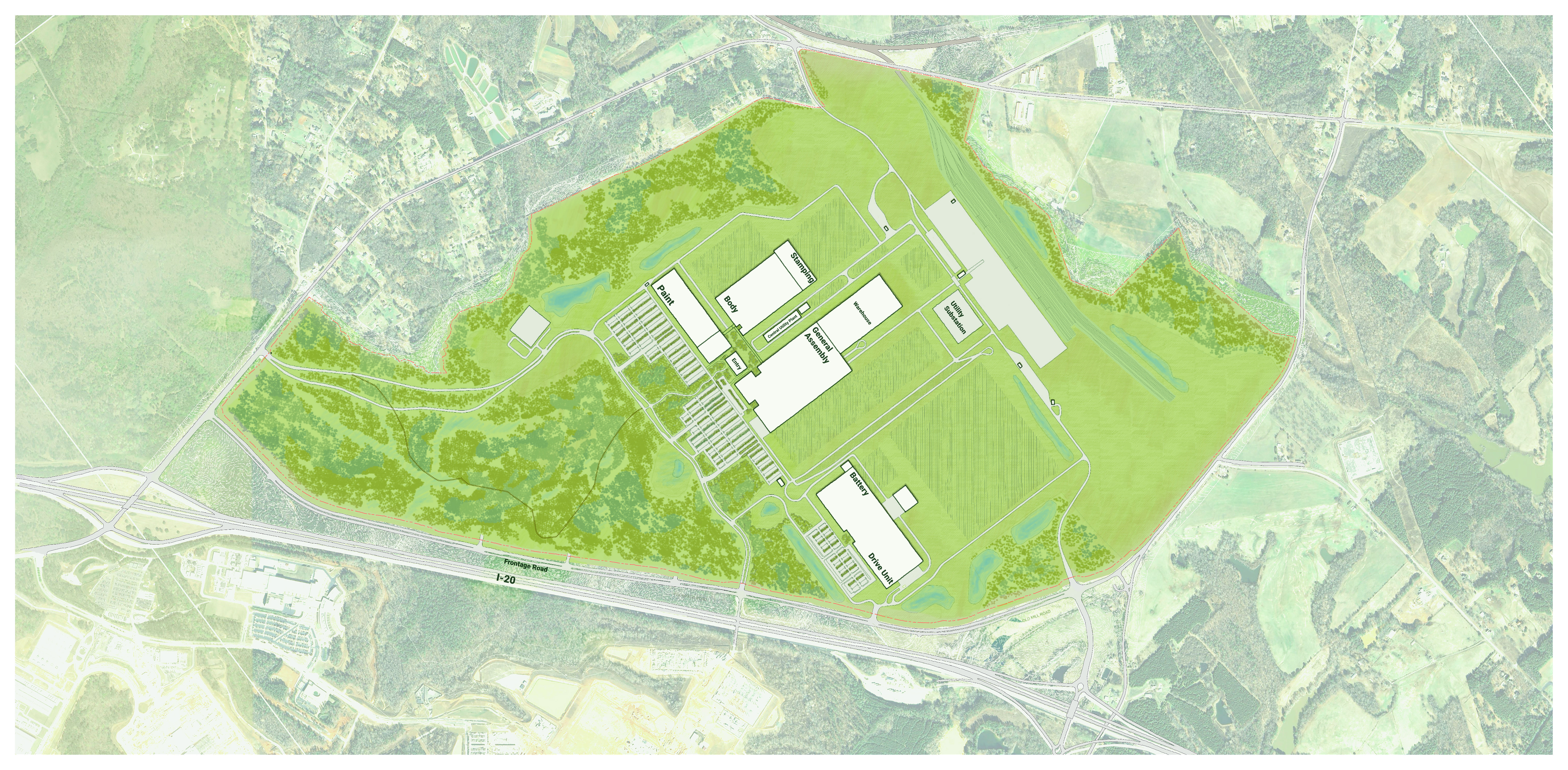

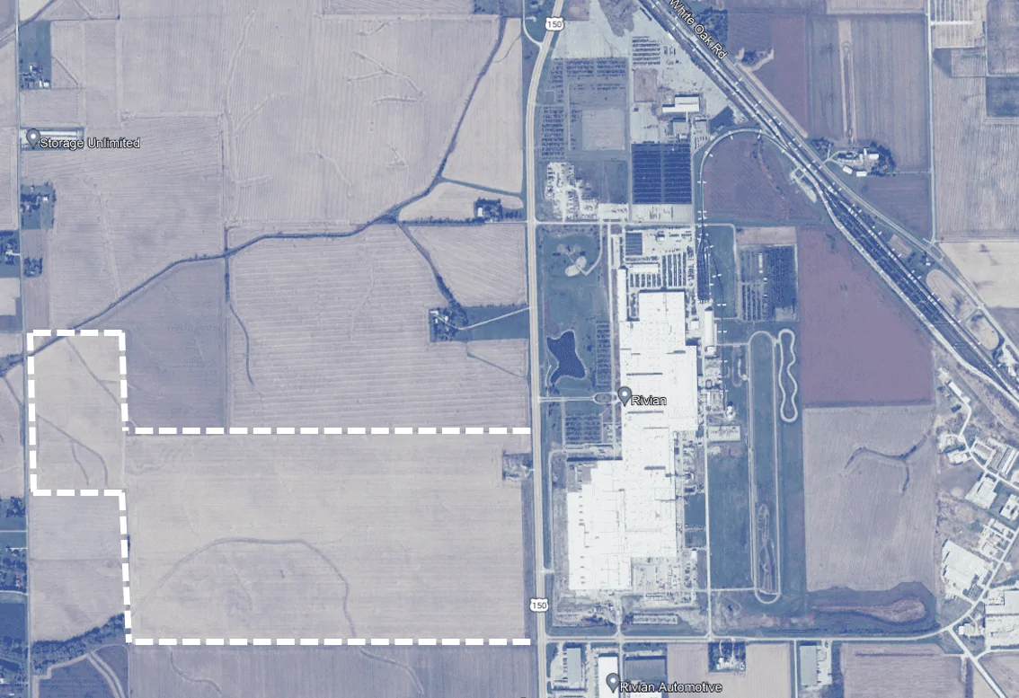

This is an aerial view of Rivian in Normal. Maybe they can build where the rectangle is and buy the land where the triangle is and move the parking lot and service center over there and expand into the parking lot.

What I wonder about is when Georgia will restart because that will take 18-24 months to finish and is needed for additional R2 capacity (North America and Europe) and R3.
I would expect a lot from the Georgia plant like stamping and general assembly jigs can be used at Normal. Use the existing battery and paint shop facilities and build a new general assembly and stamping/assembly line nearby.

I looked at the county property map at the parcels around the factory and Rivian already owns these fields west of it:
Rivian R1T R1S A "Play by Play Illustrated Commentary" why R2 production would be challenging to retrofit into existing R1 or EDV line 1710196701423
Also they've expanded the factory to the SW quite a bit the last year or two. They've taken up a parking lot and expanded the building toward the road to the W and S. That's the part of the video where RJ says something like "where I'm standing used to be the wall" or "is all new" or something like that. I think they build motors or batteries in that area now.
It was in the local news a few months ago Rivian bought or leased a bunch of warehouse space in the industrial park in the northern part of town NE of the interstate interchange.
