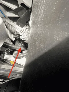

(1) Mechanical key emergency entry (I am familiar with the hook pull to access the frunk and used it once as pictured below) but there is no access to the interior when the 12v battery bricks (I tried to charge it from the rear access point and it would not take charge as confirmed by Rivian because the cell was dead); and
