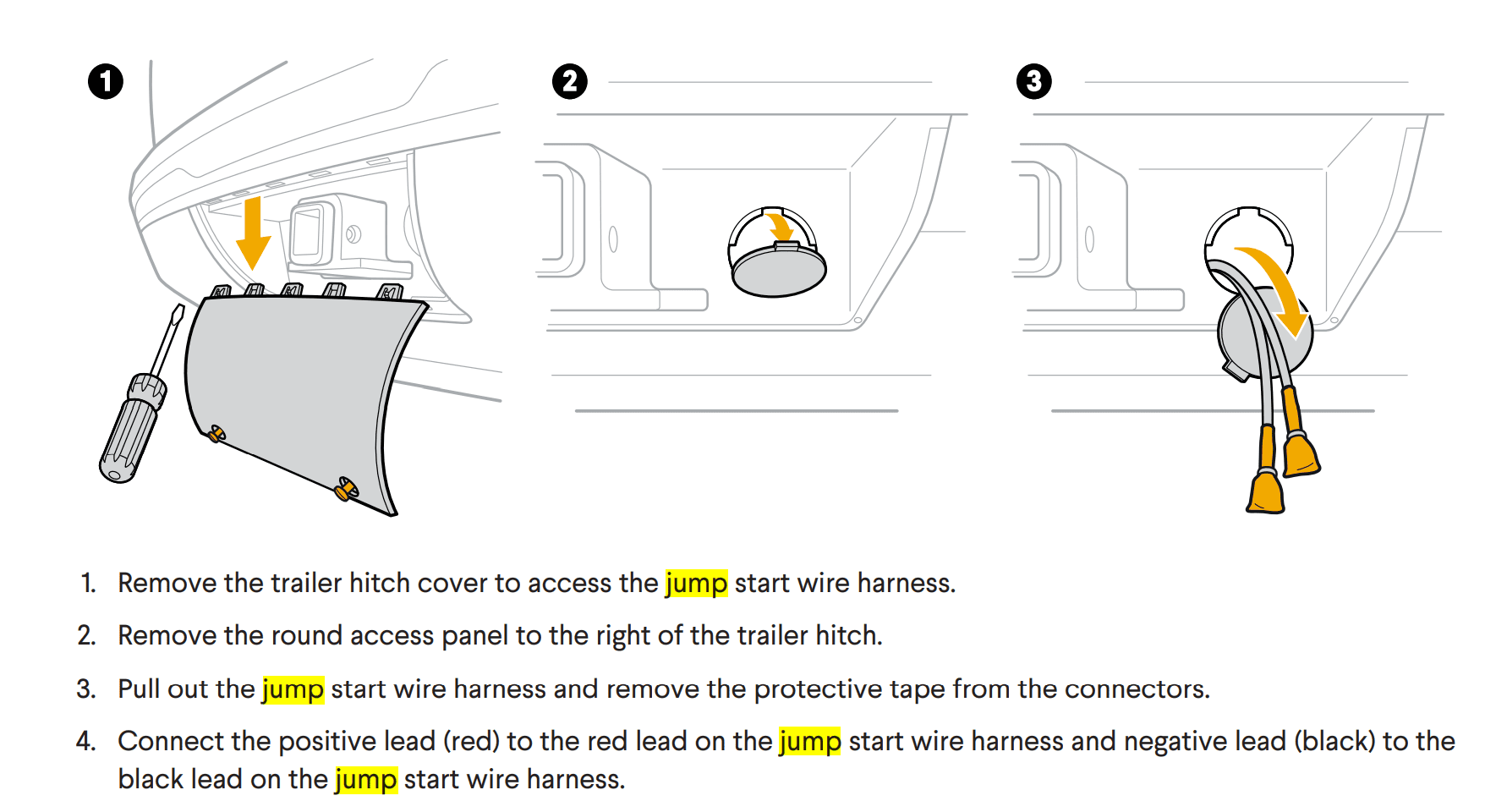

Are the jump points accessible from the outside of the vehicle? On Tesla its a PITA to jump the vehicle (at least in my 18 MS) if the 12V battery dies as you need to gain access to the trunk. Luckily service just replaced mine (unprompted) last time I brought it in for a warranty issue.

Easy peezy. No hood access required.
