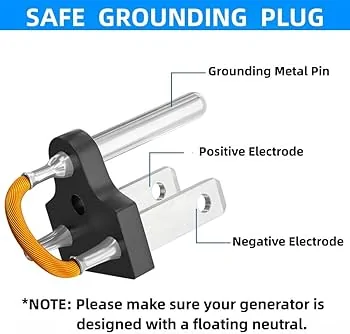

So the power cords having twist lock are internally bonded?
No, it’s a separate plug that bonds the neutral and ground so the EVSE does not see a floating ground a prevent charging. You just plug it into one of the other plugs on the generator and you’re good to go.
They make these for 240 VAC twistlock cords?
No, it’s entirely separate from whatever plug you use to charge the truck. It’s just a 5-15 plug with the pins connected as shown and then plugged into the generator outlet. You plug in your adapter/EVSE as normal.
