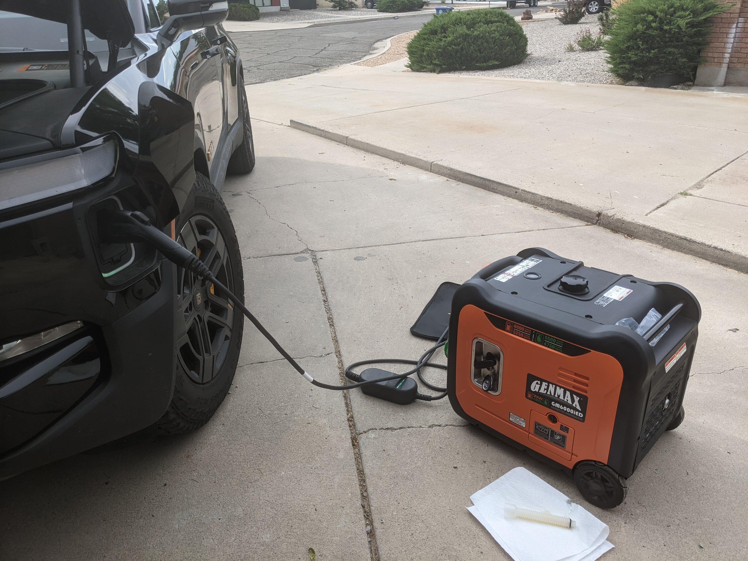

The holy grail I'm looking for is something that can charge at 5+kW and fit under the tonneau cover. I don't think this one fits?
I'm looking for the same. This setup looks interesting. Two GenMax running in series for a total of ~6kW. It’s 17.9" tall, so about 0.9" too tall. But, if you remove the feet and/or shave the handle a bit it would probably fit under the tonneau.
