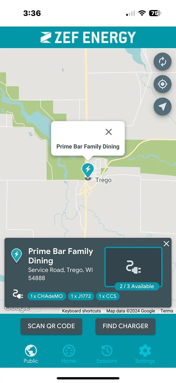

From my own experience I've had good luck by always using the app and using the "SCAN QR CODE" function in the app. Click this button and it opens the camera on your phone, scan the QR cod of the charger you are trying to use and that for make sure you and trying to initialize the machine you are at. I've seen the app default to chargers at other locations and you are mistakenly trying to initiate a charging session at some other charger! Also, have enough money loaded in the app before you start, if you don't have at least $5.00 you will likely have issues.

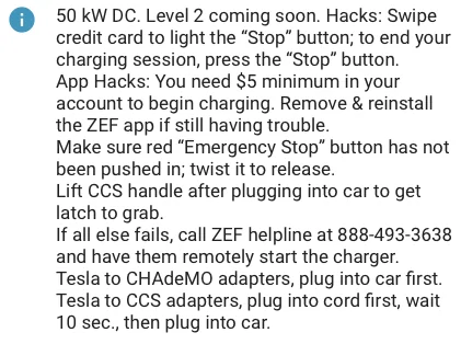

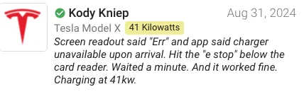

Also, some units have a big read Emergency Stop Button. Some people push this to stop charging but it is really a EMO that shuts down the whole unit unit the button is twisted to reset the emergency off. If unit is down, try twisting the button!

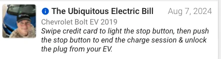

Other plugshare users tips shown below. Lots of funky hacks, we shouldn't need to do these but such as it is right now. Hopefully these tips will improve your chances!

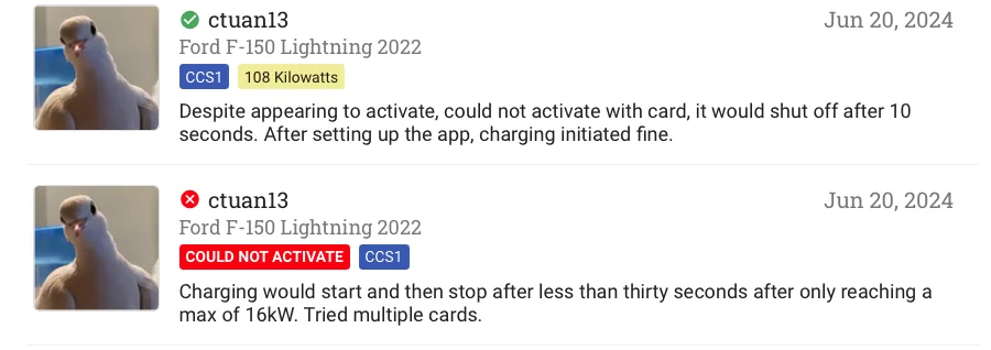

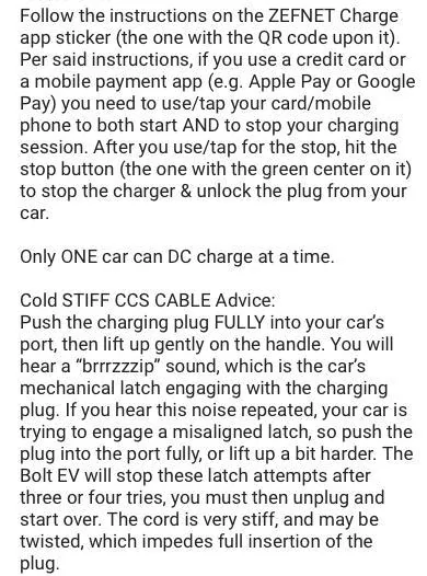

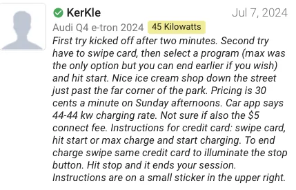

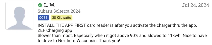

Rivian R1T R1S ZEF Charging Network: Reliability Data and Tips For Better Results Screenshot 2024-09-14 at 9.59.29 AM
Rivian R1T R1S ZEF Charging Network: Reliability Data and Tips For Better Results Screenshot 2024-09-14 at 9.54.55 AM
Rivian R1T R1S ZEF Charging Network: Reliability Data and Tips For Better Results Screenshot 2024-09-14 at 9.53.12 AM
Rivian R1T R1S ZEF Charging Network: Reliability Data and Tips For Better Results Screenshot 2024-09-14 at 9.51.12 AM
Rivian R1T R1S ZEF Charging Network: Reliability Data and Tips For Better Results Screenshot 2024-09-14 at 9.40.14 AM
Rivian R1T R1S ZEF Charging Network: Reliability Data and Tips For Better Results Screenshot 2024-09-14 at 9.39.04 AM
Rivian R1T R1S ZEF Charging Network: Reliability Data and Tips For Better Results Screenshot 2024-09-14 at 8.36.07 AM

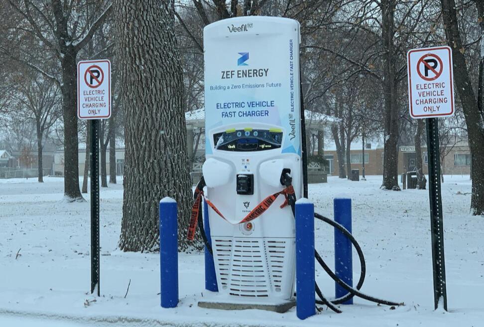

While I applaud ZEF for putting chargers in rural areas they are almost always broken. I count at least 5 in northern Minnesota that are out of order. They make EA look like the best charger company in the world. Some have been broken for over 2 years! We need real charging companies to start populating chargers in rural areas. ZEF chargers cannot be trusted.
