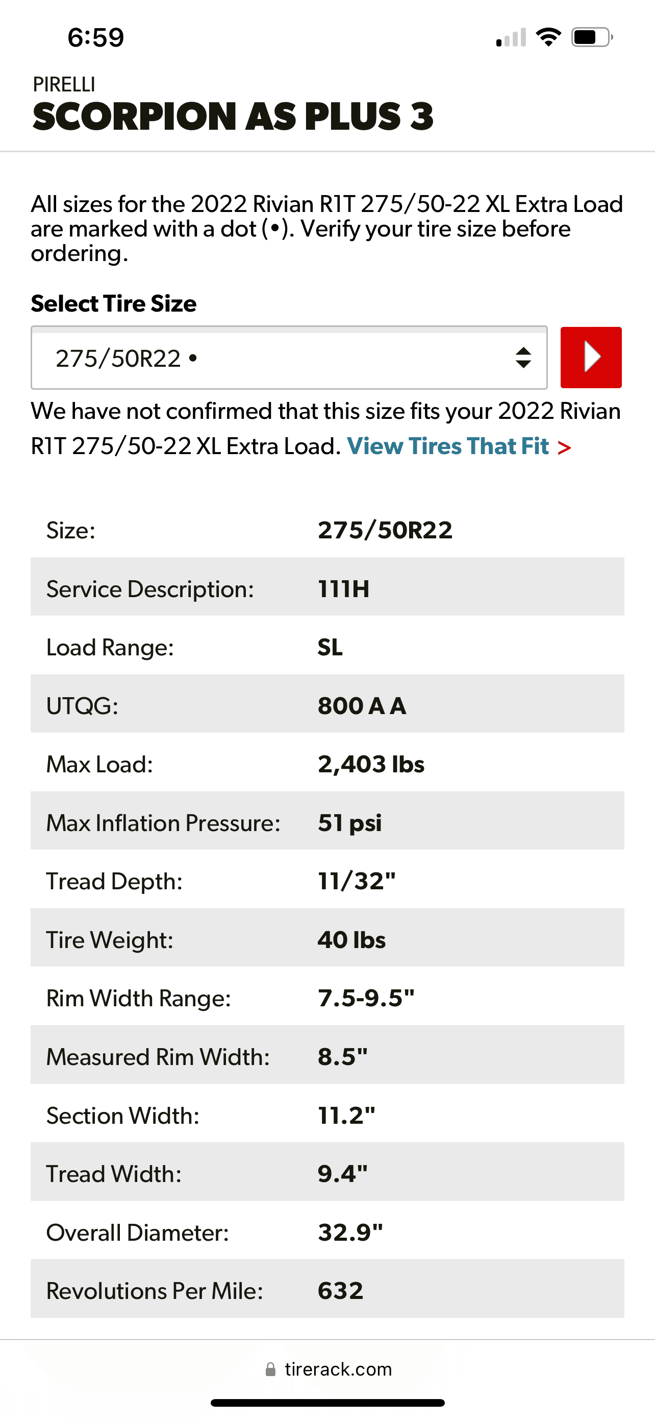

Will these work for the 22s -- Pirelli Scorpion AS Plus 3 tires

I wouldn’t do them. Load rating is only 111 the stock tires are 116….
It depends on the OP's use case. 111 is rated at 2403 lbs. or 9600 lbs total. If they don't plan on towing a heavy tongue trailer and fully loading the bed at the same time, they will be ok. Not ideal but certainly safe for a mall hauler.
It's less than the rear axle rating. You lose a lot of payload.
Agree. I wouldn't do it. I frequently haul with a loaded bed and a 5000 lb boat trailer. But I suspect OP, like 90%+ of the Rivian owners, won't ever approach the weight rating.

This might answer our question better @Arky

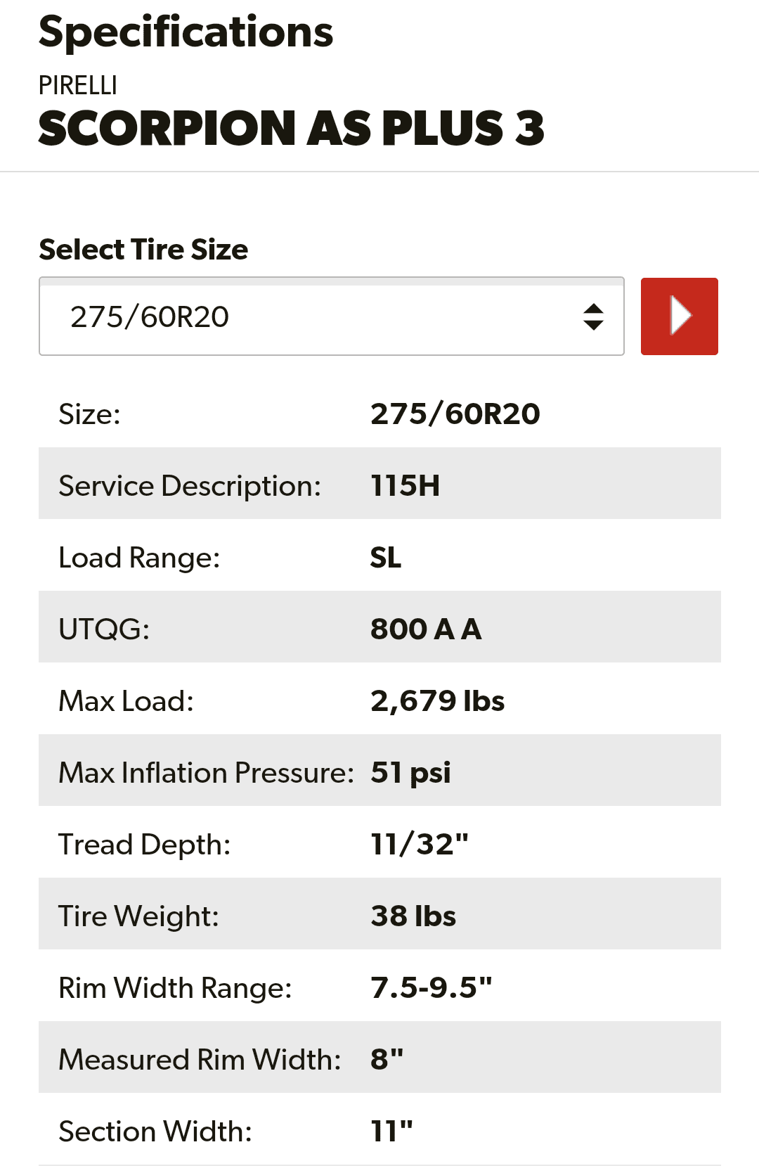

How about in 20s? Over 10k max load

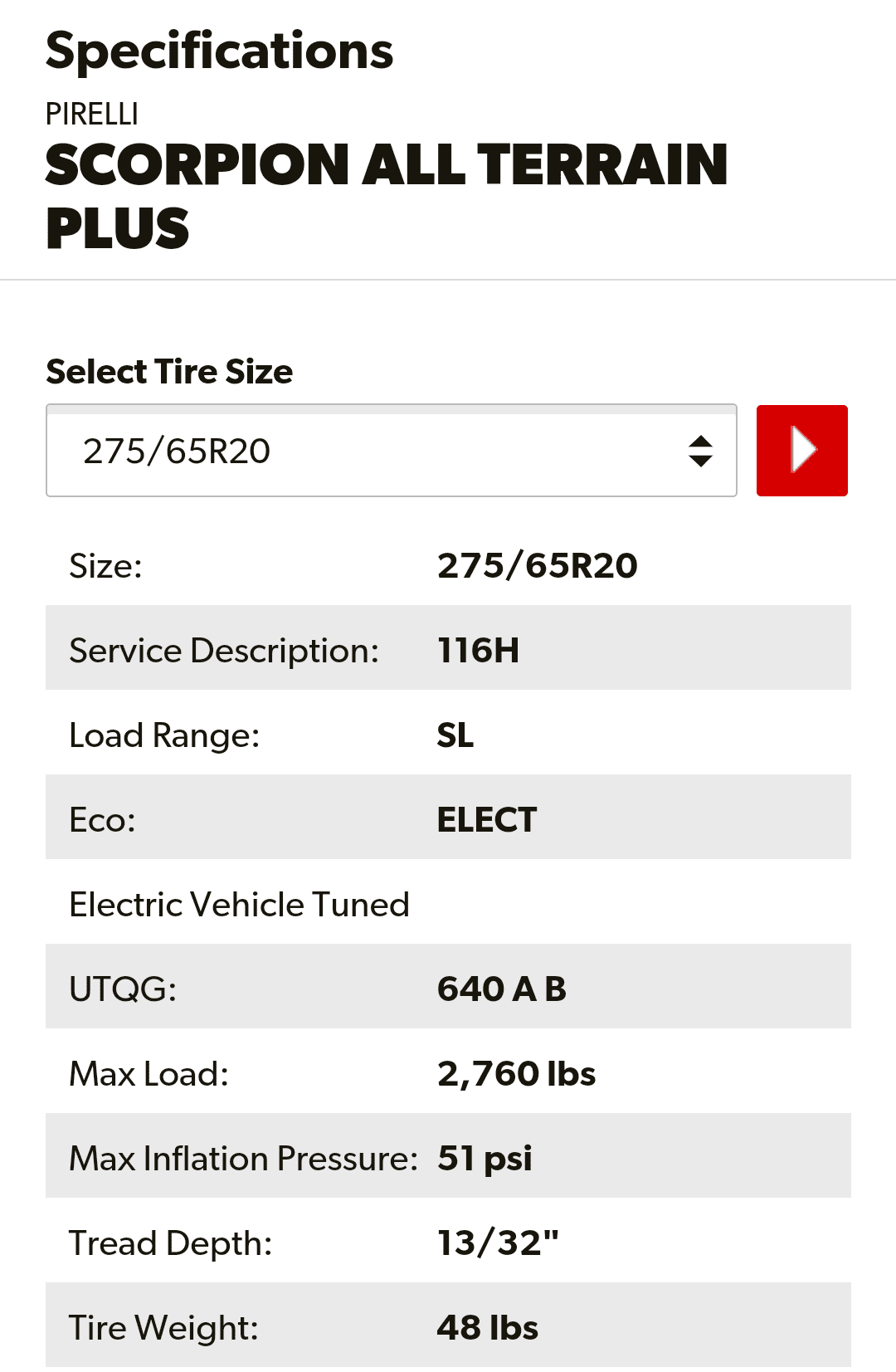

Here's the stock AT+ tire, same SL rating actually so I'm less concerned about it now.
If you can find SLs that can handle stock inflation pressure more power to you, I just found when I was looking they often didn't meet it (most fitments were XL range tires.)
That said it seems to be inconsistent across brands and makes, and I'm surprised to see ours is SL (although given it's a pretty light tire maybe that makes sense.)
