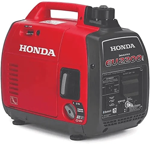

I just want to power my damn RV... So I can leave this guy at home.
