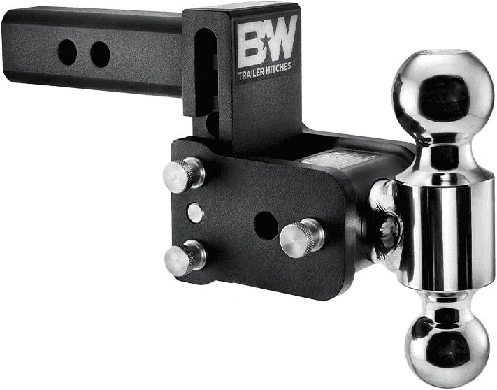

You re better off with a few hitches to use - keep them in the garage so they don't rust - than some all hictchthingymybob. I think it reduces the strength of the connection by introducing areas of risk

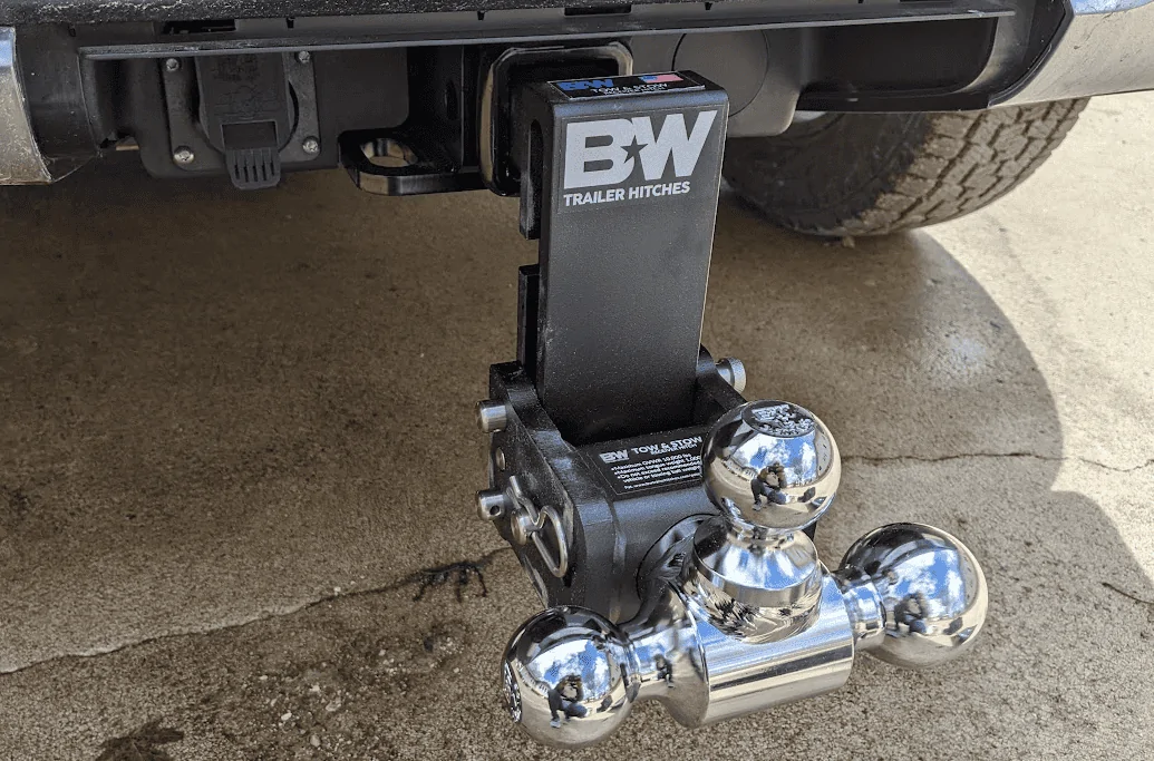

I've got one of these installed. Probably overkill for something I could get a simpler version of, but I think its neat.

It all depends on your trailer(s) that you use and the ride height you plan to tow in. Since Towing Mode mode runs at standard height at default, thats the height I keep the vehicle in including when I tow. That way I never have to think about changing the ride height in tow mode. I'm currently using a B&W 5" drop receiver as that one gives me some flexibility with the couple trailers that I tow. With my boat I need the 5" drop, but my flat bed trailer needs about a 4" drop.

I have the B&W Tow & Stow to be flexible with the couple different trailers I use. It gives both 2" and 2 5/16" balls and is adjustable up and down. I never actually leave it in the receiver though so the "Stow" function isn't necessary.

B&W Tow and Stow all the way. But for me, the 5" is just too darned big under this truck. I went with the 3" and it looks perfect for full time use on the truck. I don't think I'll need the additional drop that the 5" provides.
